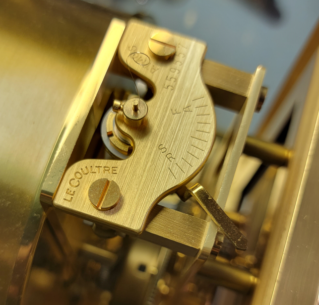

Another update on this baby.
It is still running fast and I have the regulator full tilt to SLOW.  In reading the book, I see that there is additional adjustment that can be made using a special tool...or a homemade version of the tool.  I plan to study this further.
I think it is out of beat, but I do not believe that is causing the running fast.
This clock scares me.  It seems so delicate.  Perhaps that is surprising, since have I have been hell bent for reshaping hairsprings (seemingly monumental challenge), but the difference here is that I do not have the functioning model of how the Atmos works in my head.  Hairsprings, on the other hand--the concepts are pretty clear to me (regarding reshaping).
When I teach the art of troubleshooting (problem solving), which I have done in the field of electronics, I stress the importance of modeling the system.  Without a clear and concise model, the troubleshooting process is simply poking and hoping.  I admit, with some embarrassment, that I am only slightly past the poking and hoping.
The free length of the spring defines the beat rate. To get the beat rate into the ballpark you have to loosen the screw, pull the tapered pin that holds the upper end of the spring and give or take some spring length. Then retighten.
Edited by Kalanag
That is the top view and production number of my Atmos. Looking at your earlier model and the later one in my last post it’s easy to see that there was some cost cutting over the years.
I saw where earlier vintage Atmos clocks used weights as part of the regulation.  So, I put a couple of pennies on the balance and it has slowed it down.  Kinda brute force approach...lol.
Added two more pennies...I think that will do it.  Now I need to craft a stylish weight to use instead of pennies.
May I ask why you don‘t adjust the spring length?
Fear!
I still may do that, but I don’t want to ga backwards. Yesterday, I was finishing a 400 day, slipped and broke the spring. Easy to fix, but demonstrates that even simple operations can go bad.
i agree, lengthening the spring is the right thing to do.
