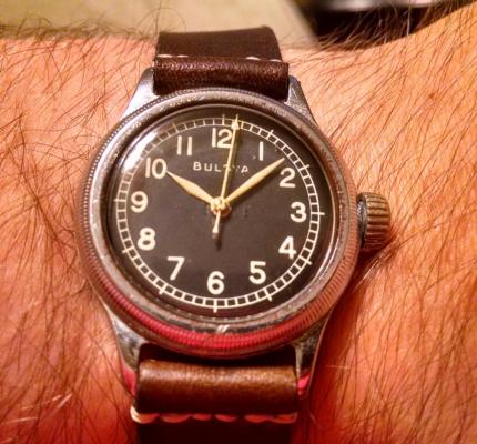

     While helping to clean out my late grandfather's house, I found a US army issued Bulova Type A-11 watch, with center hacking seconds (10AK/CSH), evidently issued in 1946 while he was an army doctor in Japan. It has a number of issues, but none of them seem insurmountable. The seconds hand had come off, the hands were rusty at the center, the crystal was yellow and difficult to see through, there is clearly some rust under the dial between the hour wheel, cannon pinion, and probably minute wheel, and the balance staff is broken. I'm only an amateur, but I have the tools and experience to fix these problems.
     Unfortunately, despite my confidence that I could fix it, I've been stopped in my tracks by a frustrating problem - I can't get the movement out of the watch. The case is (I believe) a 3-piece case, which is made by the Star Watch Case Co., with a threaded stainless steel coin-edge back, and a matching coin-edge bezel. I took some quick photos with my phone, but they aren't great. I found an identical one on the internet here: http://www.mybulova.com/watches/1946-military-issue-7150, with better pictures than mine. I am fairly sure that the bezel is pressed on, but I can't for the life of me get it off. There is no notch to fit a case opening knife or anything. I've tried my usual case opening knife, a razor blade, a pocket knife, etc, all to no avail. I even spent a while sharpening my cheap case opening knife to a good edge, but the only thing that I managed to open after that was my thumb when I slipped. I tried putting a little bit of penetrating lubricant along the edge, but that didn't help either. Does anyone have any good tips for getting this bezel off / movement removed? Is there any way to be sure that the bezel actually is pressed on?

Victory at last! Thanks for the replies, everyone. It is a screwback case, but the front bezel is just pressed on. It fought me to the bitter end, but I finally got it. Geo's post on another thread (http://www.watchrepairtalk.com/topic/2138-open-tight-bezel-advice-needed) helped me a lot. I was starting with Stanley utility knife blades (which I was incorrectly referring to as razor blades). Once I went and got some single edged razor blades, with some gentle encouragement (read hitting the back of the blade with a screwdriver handle), I was able to get the razor in, and after working that around the edge, I was able to fit a Stanley blade in, and finally a caseback opening knife. It's worth noting that I took everything that I could off the movement before this (balance, train wheels, etc.), to minimize the chance that I would ruin it with the tapping on the razor blade. I still wouldn't recommend doing that to others.
When I finally opened it, there was some good news and bad news. The good news is that there is very little rust underneath the dial; it is mostly just surface rust on the canon pinion and hour wheel. The bad news is that the dial feet are broken off. It was probably my fault, too; I got the movement out onto a casing cushion, and then lifted the cushion to inspect, clumsily dropping the movement and dial to the ground in the process. Arg... the dangers of working while frustrated.
Ok, upon further inspection, after removing the bezel by pulling it off, and cleaning the case in my ultrasonic cleaner, it turns out that the bezel does indeed screw on. I have no idea how I was able to pry it off without destroying the threads, but it does actually screw back on now. I also don't know how you would have turned that stuck on brass bezel without destroying it in the process, but oh well.
I'm glad you managed to remove the bezel, but I'm astounded that it came off that way when it was screwed on.
By the way, I just finished fixing this watch, and I made a simple band with some Horween leather that I had lying around. It would have come with a green canvas strap, but I like the look of the leather. Anyway, I just thought that I'd share. Thanks again for the replies.
