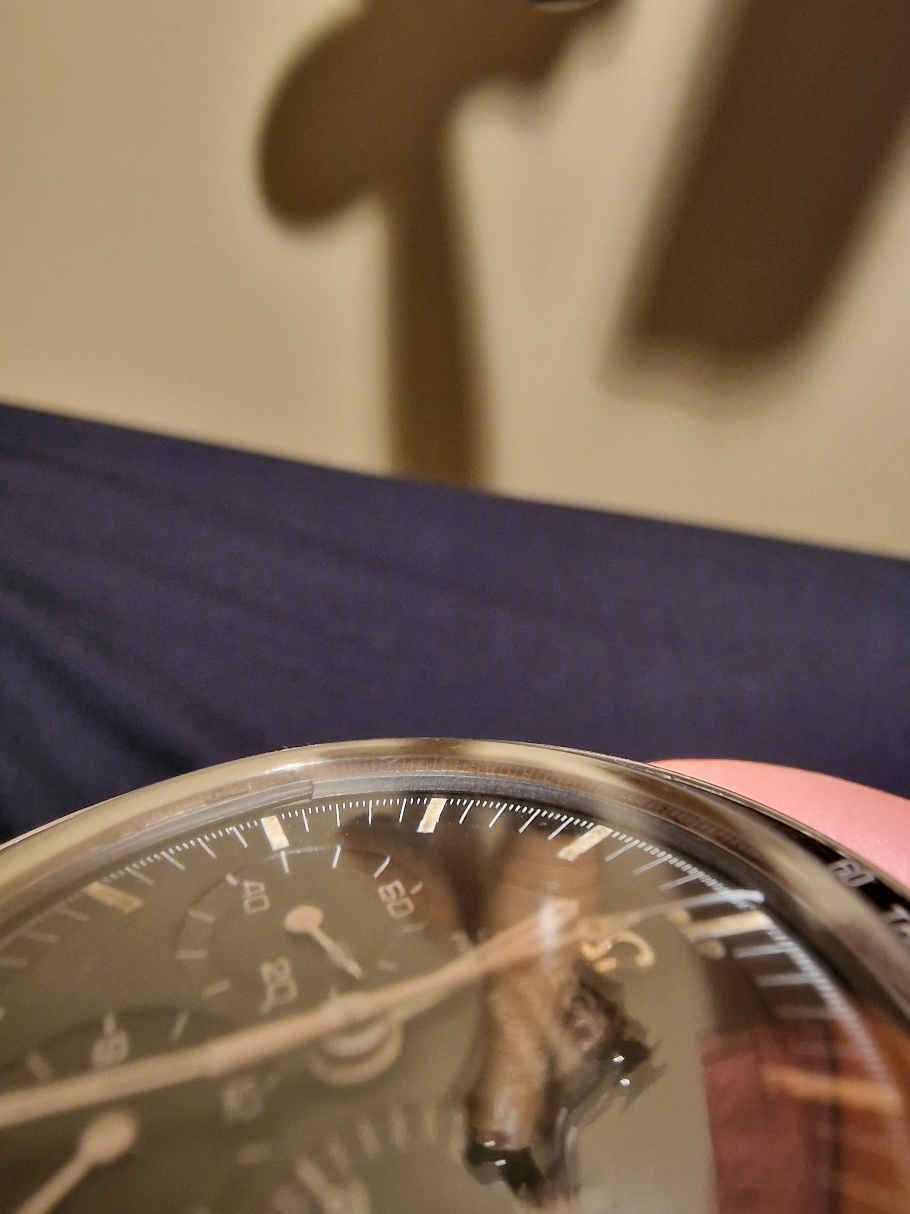

I've recently acquired a vintage Speedmaster that has some unfortunate damage to it. See a video of the damage at this link:
https://imgur.com/a/rGWQG4K
I'm struggling to see what's actually been damaged here, if it's part of the dial or something else (tension ring?). It's under the glass right on the edge of the dial (see image).
Would love to just know some more on this, what's exactly damaged, if it's an easy change (e.g just a replacement or fix)
Thank you.

From the second photo does look like a broken tension ring. Does the crystal feel secure ?
Yep, feels secure!

I'm not sure I've ever seen a broken tension ring? Now it could be a broken poly propylene or whatever the plastic gaskets are that holds the crystal in place they can disintegrate. The normal tension rings: the inside their metal and I don't think I've ever seen one go bad but this is watch repair everything is possible.
Then I didn't see any back pictures like a picture of the backside where we can get a serial number or a case number although usually case numbers inside the back but serial number would work I can look up how the crystal holes in place but I can't do it without a number.

Thank you john. I do agree the tension rings i have come across have been of a mild type steel so are more inclined to bend as apposed to a hardened brittle steel that would fracture. So could this be of a non tension crystal type fitting ?

No identifying numbers on the back besides the strap.
Problem is I went back and looked at the pictures and it's really hard to tell what were seeing. Although if it was a plastic crystal it would have a tension ring. If it was some form of glass or worst-case sapphire because Sapphire would be astronomically expensive then there would be an outer Polly propylene ring holding the crystal in place typically.
But the best way to do an evaluation is to take the back off the size we would get the case back number from the inside. But taking the watch apart does bring up a minor problem like?

You would maybe want to weight up the cost of having it repaired against leaving it as it is and just being careful having it around water as the broken seal tension ring ? will affect its water resistance. Tbh i would never have water near a vintage watch full stop. But as John says too expensive to try to repair yourself without any experience .

If the crystal has been replaced with an aftermarket one the original ring could have been cut to reduce its diameter, an original crystal should have the Omega symbol in the middle.
Parts are availabel but pricey and you need a friendly watchmaker to get it for you.

Crystal is original. If I get it repaired, would they need to change that?

All you have to do is take the old crystal out you would have to have the case number to get the proper Crystal. The crystal of this type is listed as a Plexiglas crystal with a black ring. You would just need a crystal press to the right type to push it in.

Plastic crystals have a lot of stress and this will eventually show up as a lot of hairline fractures on the crystal. If you are saying you want to save the original I would recommend not bothering they are considered consumables. Get an original crystal installed by a proffessional is the best route. Not much difference in price to buying one from them and installing  it yourself.
