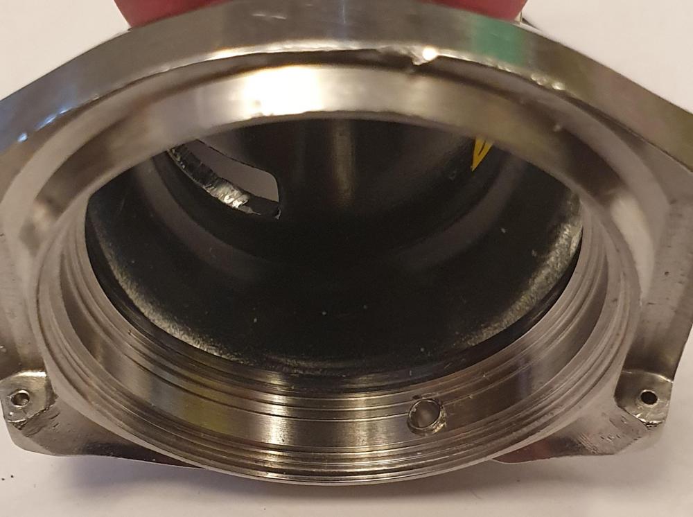

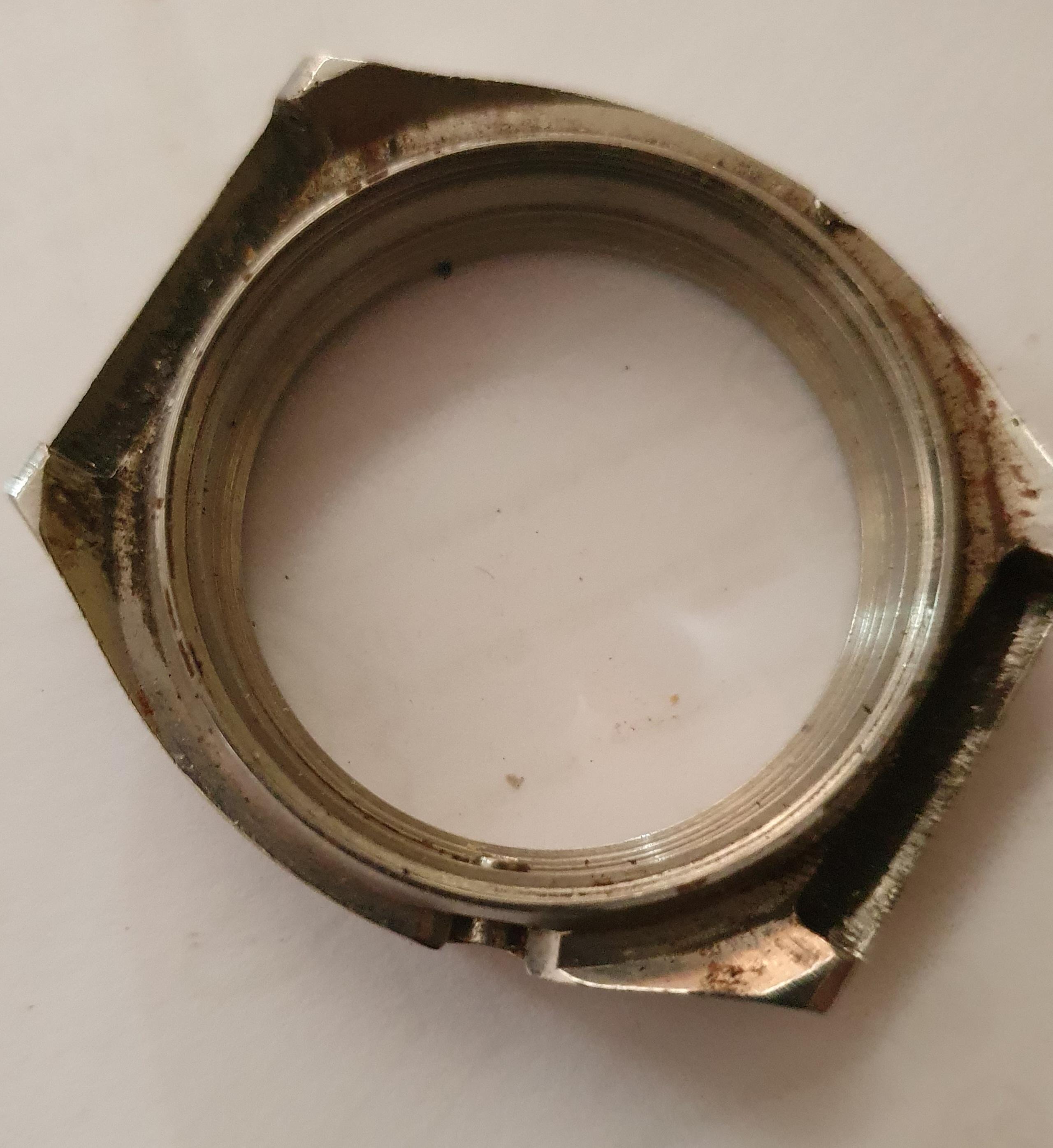

So I've been stripping down the case today and removed the dial. The wife looked at the case and said your not buying second hand anymore.
I think it needs a over night bath.
When I removed the dial I noticed I break in the mounting ring (think that what it's called) would you glue it or replace it.
I would like to replace the hands as they all bent from the bubble wrap and the fact that the glass was missing. I am going to replace the bracelet as it's all bent and most of the links are damaged

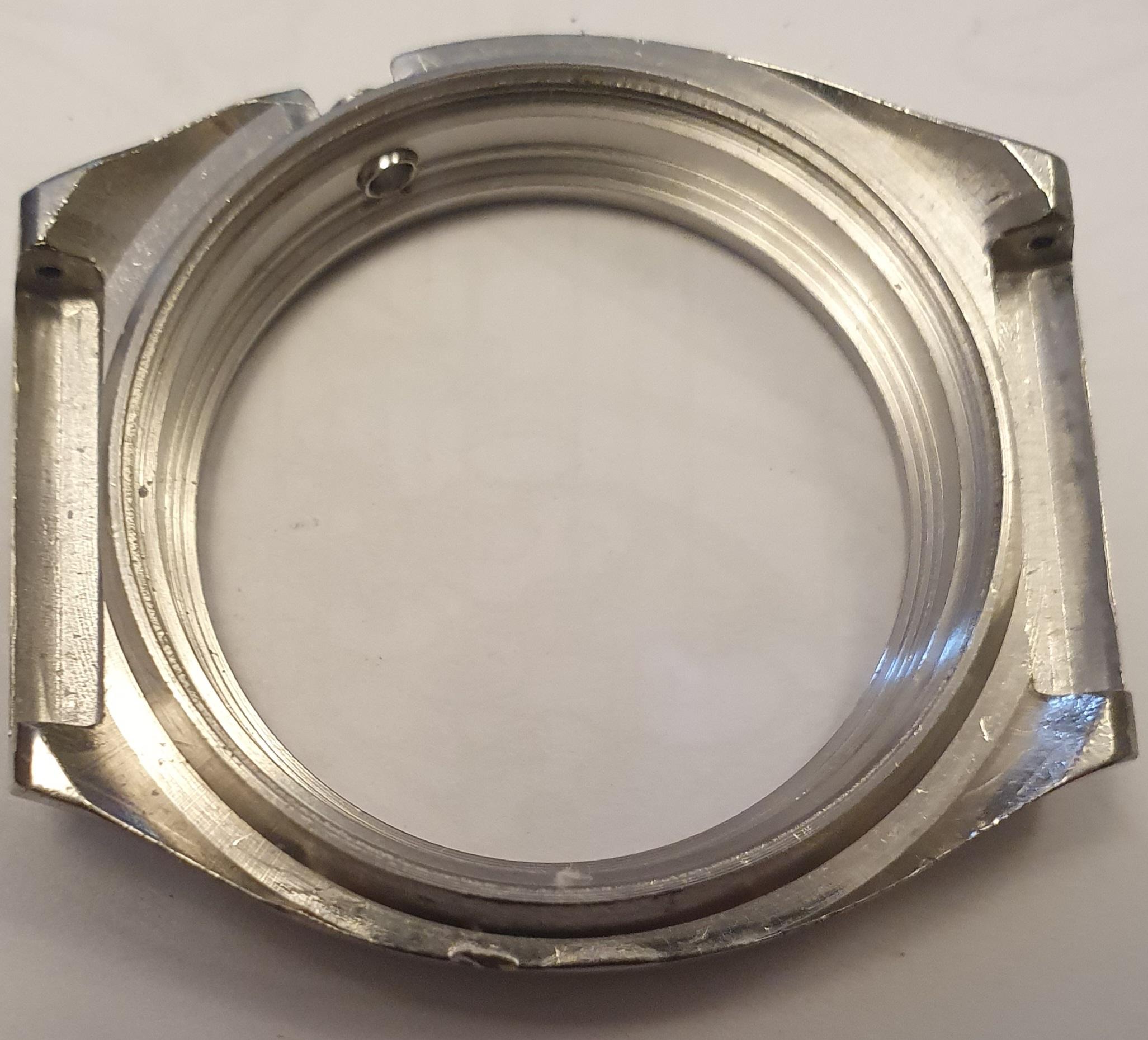

Aw bless you Tiny, I have same exactly the same senimetal thoughts about my vintage restorations,  I get really emotionally attached to some of them.  and often wonder if it was a gift. My intent was to try make a little money to supplement my pension, but I can't bring my self to let any of them go especially  the old ones. Hence my profile name. You have literally  made me cry and now my eyes are stinging. I often have random dreams of people after a full day of repairing a watch, maybe some sort of object connection, with being so closely involved  with it. But that's a whole  different discussion. Anyways your watch, it could well be a plethora of issues (had a dictionary for breakfast and it's repeating  on me). A pro would give you a couple  of ideas possibly. Start stripping it down to see what you can find, looking for wear and anything obvious. If rotor is stiff then maybe it's bearings. As you know the keyless works operate the dial rings, so likely  connected. You know to take photos with ease step to help you reassemble. Don't try to rely on your memory  too much, I'm practising this but its bloody hard. I striped one down the other day and was brave taking no photos. It took me nearly an hour to remember  how a return spring went back in, it was a wierd design. So don't do that.
Well after a over night bath with a sonic shower finish with a G&T no ice lol
looks much cleaner now. cleaned and showing damage.
would this watch have a grain finish, satin, or mirror finish but most of all how would you finish this case?
only asking because I am a new bee
20220423_102831.thumb.jpg.509e54f4bf186e99d42afd034e6428b9.jpg20220423_102405.thumb.jpg.74226fb23d674d10cdd8587ad08f8d3d.jpg
Edited by Tiny
opps forgot photos

The red arrow is the bezel.  I didn't see that in your picture of parts, but it sounds like you have that.  The yellow arrow points to the rehaut.  I think I see this in the middle of the left column in your parts picture.   Maybe the bezel is under it?
There should be a plastic gasket between the crystal and where it sits, and also a gasket between the bezel and the case.  They will be plastic, maybe white, clear, or black.  There should also be a gasket between the case back and the case, which will be rubber and almost certainly black.  It should be flat or an O-ring.
The crystal might fit into the bezel, or it might fit into the case, Seiko uses both types of construction.  I can't get a good look in the pictures.
Here are another set of pictures from an auction.  That one looks like it's been polished.  Notice how rounded the edges of the case are compared to other watch from my 1st post.  I think someone tried to restore it by jamming it against a buffing wheel for a hour or two.  Not a fan of how that one looks.
The link in my 1st post is what I think the original finish would have looked like.  It's brushed: horizontal on the watch face and bracelet large links.  This is easy to do.  The bracelet small links look either polished or chrome plated.  The sides of the case look brushed too, lengthwise.  The bezel is either polished or chrome plated.
