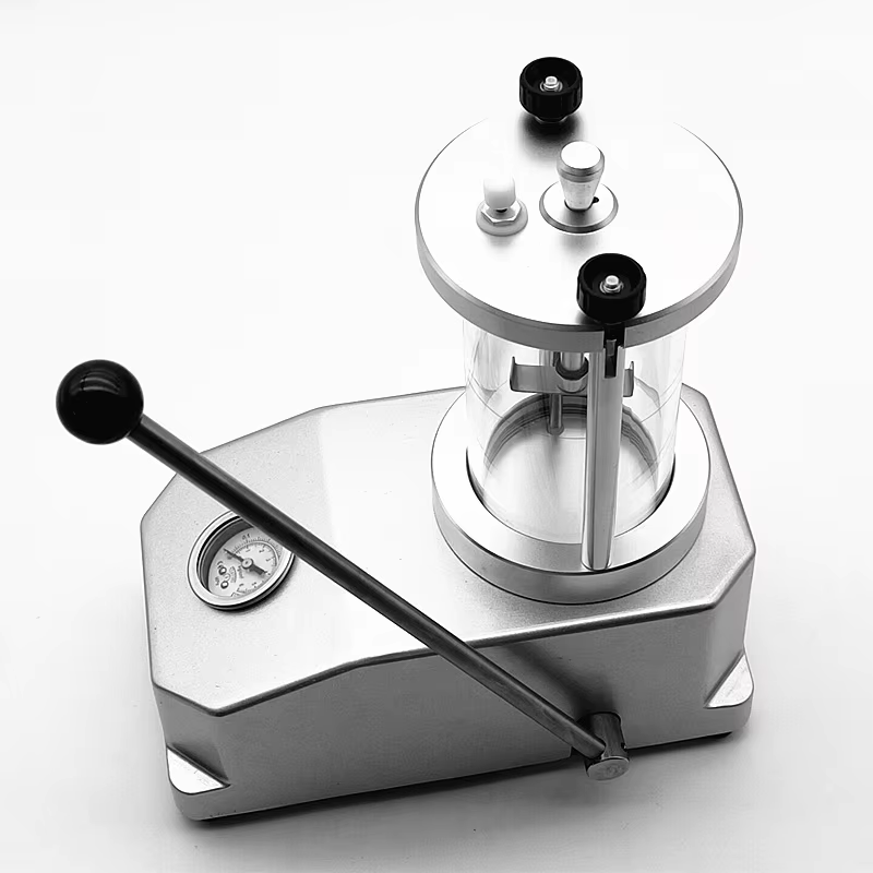

I'm thinking of buying a pressure / waterproof tester. This one is not expensive (excepted the shipping costs) and looks like a La Pavoni espresso machine 😃
Does someone use this kind of machine ?
I ordered the cheap one shown in my earlier post,  I can do a review in a few weeks if there's interest.

Just received today:
For only ~60$ *
(*) ~140$ with shipping and custom fees. 3.80 Kg
The pressure should be able to reach up to 6 bars.
The glass is thick
The closing system seems to be sturdy.
The plunger lever(?) and the valve:
The plunger lever locking system (I will make a notch on top to note the opening position):
I put 3 bars at let it for 20 minutes, the pressure didn't leaked at all.
Next steps:
Quick wash, maybe put some silicone grease on the seal of the lid ?
First test I'll do:
  1. Put deionized water til the red line
  2. Put a diver case in the tank, keep it outside the water
  3. Pump (10 ~ 20 times?) to reach 3 bars (0.3MPa)
  4. Wait at least 1 minute
  5. Dip the case into the water
  6. Gently release the pressure and observe
To be continued...
All comments are welcome
Edited by nico
I have one of these (different colour scheme) very happy with it!
Not so happy with the recent results...  but that is nothing to do with the tester.
My wife wanted a waterproof watch she could take on holiday so I fixed up a nice Mickey Mouse Seiko 5 for her.  But after getting a non runner working nicely it failed the pressure test with water seeping in around the crystal 😞
Why deionised water for a pressure test?
I bought an old Bergeon 5555. The bottom of the tank was full of petrified salts, which also corroded the metal parts a bit.
I would use just distilled water.
