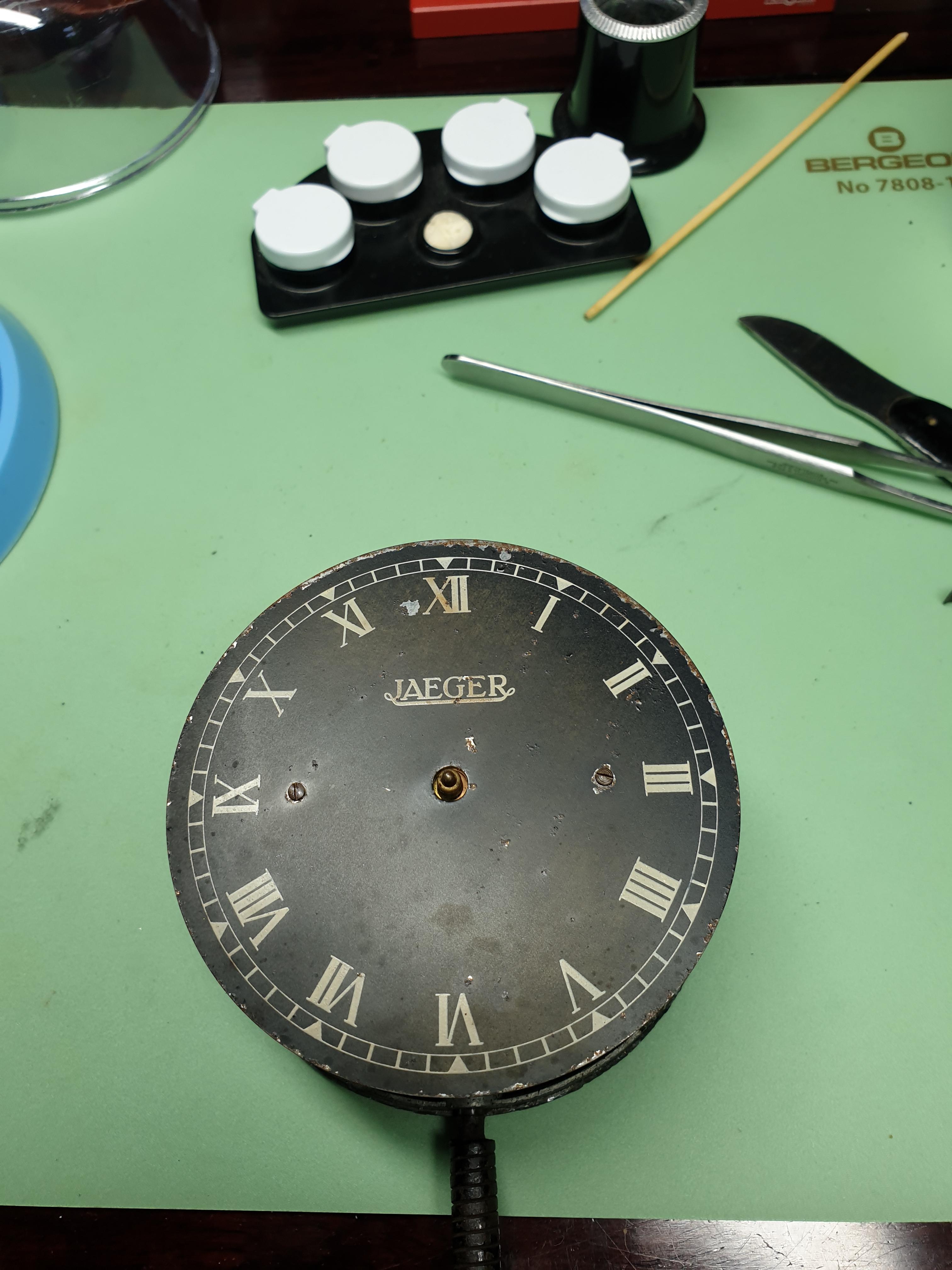

Here is a strip down of a really filthy Jaeger
Dial side up.
Dial off
dial backing plate removed.
Hour and minute wheel removed
Movement flipped over
Platform escapement removed and that center wheel levered off.
Nuts removed and the top plate taken off.
