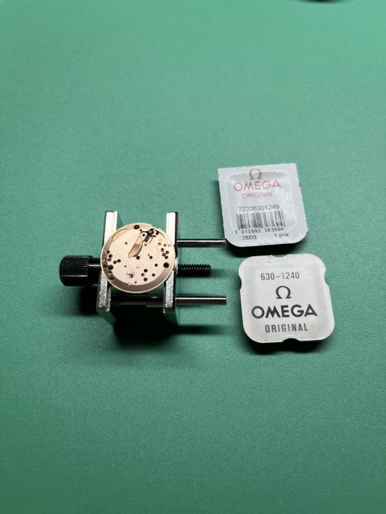

Omega Cal. 630 Driving Wheel Over Third Wheel - Advice Needed
Once you are aware of the problem, you can adjust as necessary. I have a couple of the Omega 10xx, and they are not my favourites. They seem a bit flimsy and not as solid as previous generation Omega. But I think that's true of a lot of movements from the 70-80s. For me, the 50-60s is the peak in watch movements, where the design criteria was quality, not saving the last penny.
Thanks for this post MikePilk, I just came across a similar problem with an Omega 1022. Â The problem I had was the seconds pinion spring was bent out of shape and did not even engage with the wheel properly, so the seconds hand was not moving at all. (no power loss though :) I removed the automatic module so I could access the spring and work on it. Once I bent it back close to the right shape, I experienced the same problem you reported about power loss. Â Many tweaks later, and the seconds hand is moving properly again, with amplitude back to good numbers again. Cheers
After cleaning up the pivots, I made bushes on the lathe. At this point I've pressed in 6 bushes (3 sets) and the wheels turn smooth. What I can also tell you, is that I'm not looking forward to final assembly. Getting the pivots aligned seems to get exponentially more difficult with each wheel that is added.
