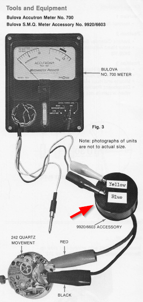

I just acquired this tester and want to use it as a general tool working on quartz watches.
1) Does anyone have the schematic of the tester because I may want to mod it?
2) Can anyone tell me what is in that accessory puck that I am pointing to?
@JohnR725must surely have the answer to both of these questions!!
I probably have the answer for this but I'm not 100% what you're getting at?

The panel meter is a 25uA meter. Meters in that range are not commonplace.  So, what can I do with it...hmmm...thinking.
I like analog too...grew up with analog.
Trying to divine why they put the electrolytic caps in this meter.
But beyond the meter, what is in that puck???
I'm assuming the capacitors are there just to stabilize things and smooth things out.  I suppose they may even be there to stabilize the power supply aspect for the watch.
Then the mysterious puck? I assume you mean the small round black thing that they attached the meter when their measuring current? In a quartz watch. The problem with analog meters and quartz watches are when they draw power they draw it very fast over a short time and you need an average which is why the use of electrolytic capacitor. Bulova was clever in that the black round thing is recycled plastic. So one of the plastic movement holder's spray-painted black C can't see what's inside as electrolytic capacitor I don't think there's anything else in their? But it's been so long since I took one apart. Then I was trying to think of which one of my reference material would tell us the capacitor because mine are conveniently sealed up in the meter.

6 hours ago, LittleWatchShop said:
It is an accessory for using the Meter with quartz watches
I do think I already answered the question just didn't spell out the details like below. Complete with photographs.
now I just had to figure out where mine went to I never use it. I found lurking on the mess on the coffee table yes I know a strange place for it to be but that's where I found it. then a classic green plastic holder for movement recycled by Bulova. Although typically today the holders are all clear in plastic. Nicely spray-painted to protect the inside from prying eyes. For some reason I kept thinking it was bigger like 470 but looks like 100 at 6 V. That should smooth out the pulsations on the meter and give you a better average.
