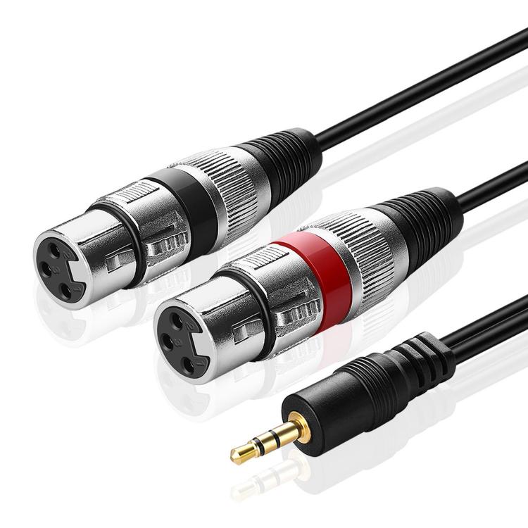

17 minutes ago, ifibrin said:
I’m not sure how to get a recording of the sound from the mic of the timegrapher, and I don’t think my phone can capture the extremely soft ticking.
I was wondering if there was a way to directly connect the microphone to a line in/3.5mm jack on a computer/device using an adapter of some sort.
The connection on the Weishi microphone looks familiar to me... memories of music lessons and equipment as a child. I'm thinking the connection was a common input type for electrical instruments.
I can't access my timographer at the moment (would wake everyone up at this hour here lol) but is this the connection type on the end of it? (see picture)
If so, then its an XLR type connection according to some googling. Maybe the right converter would allow it to plug into a computer to record (if you are using a combo headphone/microphone jack make sure you get the 3 input type that will allow a recording)
3.5mm to XLR Female Adapter Cable
Check thread below. Note, the connector is not an XLR, even it it looks and can plugged (with excessive force) into one. It's a 3 pin "aero" connector. I will add more details to the topic when I get around to build and test mine.
As correctly noted above the connector looks familiar but it's not what you're thinking it is. This is the one you want it fits perfectly..
https://www.ebay.com/itm/221445284681
I purchased the connectors for an unfinished project  that  would be helpful.  The Chinese machines lack audio  and  the ability to listen to the watch especially if you're having problems is really important..  The ability to listen to the watch and see if it actually is an audio problem or something else.
The easiest way to get audio from the timing machines is to hack the microphone.. Using a pair of the connectors you can make a pass through I would put it in a Metal box though so it shielded..  This way the microphone and continue to function like it's supposed to and you have access to everything you need  to have audio.
In other words it should be relatively easy if you have the time which I seem to be lacking to put an audio device on your timing machine and then listen to the watch and be unhappy with how horrible it can sound.  Then I'm not joking about how horrible it can sound  I have a horrible sounding watch currently at work I have to deal with it sounds very very bad... But at least in the audio I know why the timing machines unhappy with the watch. With the audio you take away a lot of the mysteries that you see on the timing machine.
