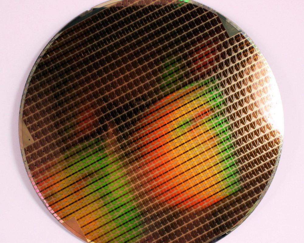

I'm talking about the wafers from an IC fab, that have been etched (maybe partially) but not finished, and so not cut apart and encapsulated etc.  I would expect to see at least a few of these around, maybe from when processes are started up and being debugged.
I've attached a jpg of an etched wafer.  This one has a nice diffraction effect.
Found some wafers! These are 4 inch wafers from the 80's, supposedly Rockwell chips. I've got five of them so that one or two of them can be sacrificed to my ham handed ministrations. They are about 0.5mm thick, and seem fairly sturdy.

Wafers are made from crystalline silicon--meaning the atoms are perfectly ordered in the lattice (that is the goal anyway). Cutting a hole, or making a circle is probably impossible.  You can make orthogonal cuts and I suppose, in principle, you could make many small orthogonal cuts to approximate a circle or hole.  You would not do this with a Dremel tool however!
Rather than physically cutting, you could chemically etch the wafer, but even then, not something you would do at home.
Your best bet would be to dice up a wafer and then mount the die on a dial substrate.

Well, tried drilling a hole today and had some success. Got some diamond coated drills, and tried out a 2mm one. Didn't do anything special,  just cranked the Dremel up to 10K and had at it.  There was some chipping as the drill broke through the hole. I think some tape front and back, some lubrication with water, and a lighter hand might help with that.  I could also see that there was quite a bit of runout in the drill bit, I'm  sure that didn't help. I'll have to see what I can do about that, but given I'm using a Dremel, it might not be much 🙂IMG_20210824_162847.thumb.jpg.5fd6765e9f1f7d59662b124ff5a97a65.jpg
Drilling a hole is a pretty good start, since you can then use the hole to centre whatever additional cutting method you use to cut your dial disk. Keeping the drill bit as short as possible and perhaps a gentle pecking motion rather than a full on push from the drill may help with the chatter and the chipping. I'm assuming the drill is in some kind of drill press.
It's a Dremel drill press,  my Dremel rotary tool mounts in it, and turns it into a nice little bench drill press. Nice thing about it is the high speed. Yes, pecking is essential.
I also figured out my runout problem, I tried a different collet and the runout is much better. I think the one I was using was distorted from being over tightened, they are just dinky little aluminum bits and hand tight is likely plenty.
I have some center drills buried in storage, I think a #0 or #1 will fit in the Dremel collet (1/8th"), and using one first might help a bit, too.
