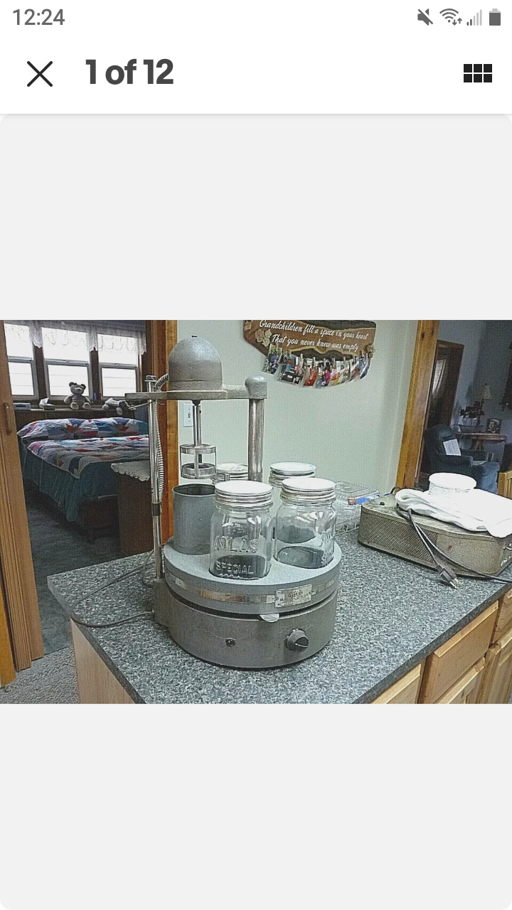

Hope everybody is having a good weekend. I scored a used vintage parts washing machine and believe I got a decent deal considering what I've seen other vintage machines go for, 4, 5 even 600 bucks if not more. The seller says everything works and has a basket, jars/lids that are intact. It's a manual machine which suits my little hobby just fine. The nameplate is marked "Good-All Electric Mfg., Ogllalla, NE,. I did a quick search here and didn't find anything and found a little online about the company and its history. The company still exists today only under a different name, manufacturing electrical devices. They used to make welders, fishing reels and watch cleaning machines.  Check the two pics I have. Anyone have any experience with these? Any intel would be appreciated as I'm anxious to get my hands on it. This along with my little ultrasonic, the habit....er hobby should get a boost. Thanks

I did see this on ebay the other day and thought I'd never seen one like this before. I also thought what was that part sticking out for (red mark) Looks as if to the right of the machine it has an ultrasonic bass. Make sure all the wiring is safe, if you are not an electrician I would get someone who knows there stuff to look it over and make sure it's safe to use. I'm sure you will have good results with your cleaning machine.

 Hi Hippy the circled part I believe is a lever to advance a jar to the next cycle. The wiring and terminals from what I can tell here look to be in decent shape. As far as the variable speed (reostat) knob, heater and plate switch I'll have to check when I get it along with the motor. It says the whole thing is semi automatic with no on/off switch and that the motor is bi-directional, changing every 5-10 seconds. Its operational by simply pressing the motor mount gantry to the down/wash position, then up, to off. Thankfully as a Millwright and machinery repairman I have a decent working knowledge of the electrical otherwise I might not touch the thing. Waiting on an email response to questions from the seller. I look forward to getting my hands on it.
BTW-I'm not sure about the possible ultrasonic unit to the right of the machine goes with the washer itself. The listing says nothing about it, I could be wrong though and will ask for sure. Thanks Hippy.

In my cleaning machines I had I always used  L & R cleaner and rinse. I only used Ronsonol lighter fluid for cleaning hairsprings and sometimes pallets.
The ultrasonic base is from an L&R Varimatic machine. On those the transducer is above the basket, in the head of the machine. I suppose that part could be adapted to a machine like the Good-All, but this one hasn't been converted.
L&R cleaner and rinse is fantastic, it's good enough that some major manufacturers here use it rather than some also excellent native solutions. On this machine with sealable jars it should last quite a while, and you can get a good 20 or so watches through on one batch so a gallon goes a long way.

yeah saw that when I looked closer. Found out that that was for a seperate sale anyway. The only thing I've found out about the Good-All so far is that it was invented and made by a Robert Goodall out of Ogalla, NE. back in the 40s and 50s . he had a family business that made electrical parts before and then heavily during the war, but was also known to have made Good-All fishing reels that I guess were the hottest ticket back then. he only made wash machines for a short time. this one is in excellent shape and works very well. looking forward to the chance to use it. still trying to find out more about it. His company still remains today, although bought by a foreign company who changed the name.
