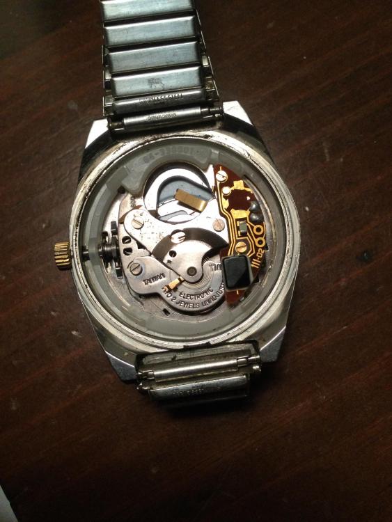

On 3/24/2021 at 1:11 PM, Rodney said:
Started then stopped. Would like to get a new movement. Possible?
NOS replacement is not likely to help since you will still have to service it.  What have you done to try and correct the one you have?
Your circuit board is missing the trimmer capacitor.
The capacitor is glued on with epoxy and wasn't soldered. It falls off quite easily. I think it's a common problem with this model. It works great after soldering back the capacitor though.
If you have the missing capacitor, solder it back on and the movement should work.
On 3/26/2021 at 5:50 PM, HectorLooi said:
By the way, the movement is a M63.
Where do I get a new capacitor or movement?
