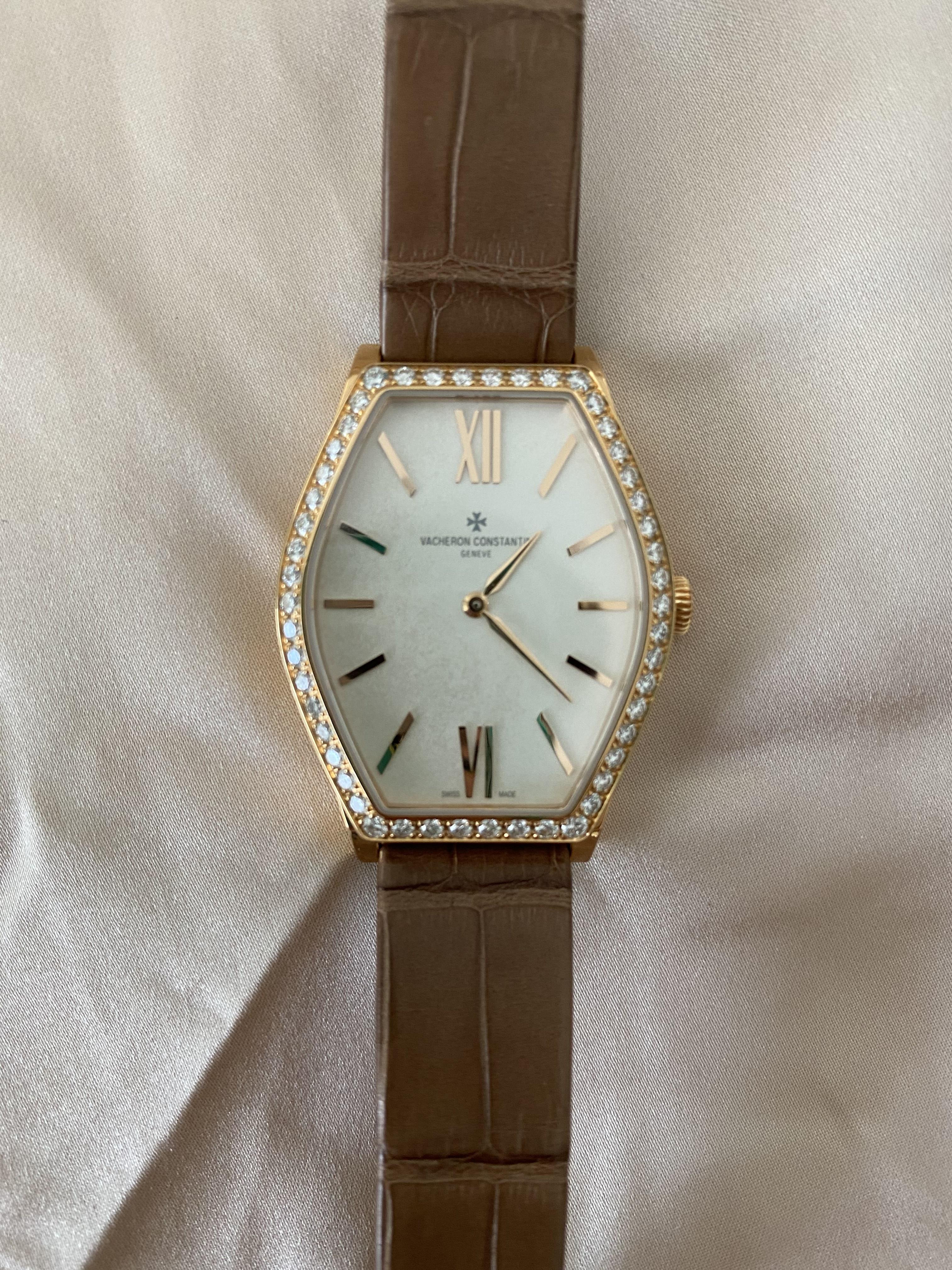

I have a quartz Vacheron Constantin watch that started to develop a discoloration on the dial in the past two years. (Mainly on left side of the watch, from 5 to 11 on the dial)
It started really not noticeable and I haven’t worn it for almost all year 2020 because of COVID. It sat in my closet with my other jewelries with the desiccant pouches. And I'm in southern California where the humidity is low.
When I took it out in Feb 2021, the discoloration became very noticable. See photos attached. So I took it to the boutique and they send it to the service center for a check up.
The Sales contacted me and said the watchmaker in the service center said it’s due to humidity that caused the discoloration/stain and it can not be cleaned but only replaced and it will cost $1300 for the replacement of the dial.
Background information is that, I purchased the watch in 2014/2015 and brought the watch for a battery replacement in Nov 2018. I never had any issues with the watch until after the battery replacement. I started to notice a small discoloration but I can't say for sure and thought maybe it was always there and I just didn't notice in the past. But now it became obvious, I was worried that it’s caused by battery leak but the sales confirm that the watch maker said it wasn’t battery leak and the mechanic part is not affected. The dial discoloration is due to humidity.
Can you please help me take a look at this watch and see what could caused the discoloration? What are my options? There’s no fog or water condensation forming inside the watch ever, only issue is the discoloration of the dial. The watch didn't stop working and is accurate. I find it really strange and want to know if there’s anything I can do about it.

My first thought was battery leak. However, I am pretty new to all of this, but I cannot see how there could be enough trapped humidity in a watch case from a battery change. Especially if there are no other indications such as fogging etc.
I would be wondering if the watch has been accidentally exposed to some sort of chemical contaminant at the 2014/15 battery change though?
It’s hard to see the discolouration from the photos. But on dials like that, my first guess would be a chemical reaction between the case/dial/dial batons.
Has it been waterproof tested? It would have to be very leaky to suffer from humidity.

My thought was chemical reaction too. But the boutique is not providing any reports saying that it’s due to humidity. I really don’t think it’s due from humidity.
Surely not  caused by humidity, rather a chemical reaction as suggested above already. No matter how expensive a watch is, it can happen over time. Unless the manufacturer will admit responsibility you will have to live with the blemish, or spend for it.
