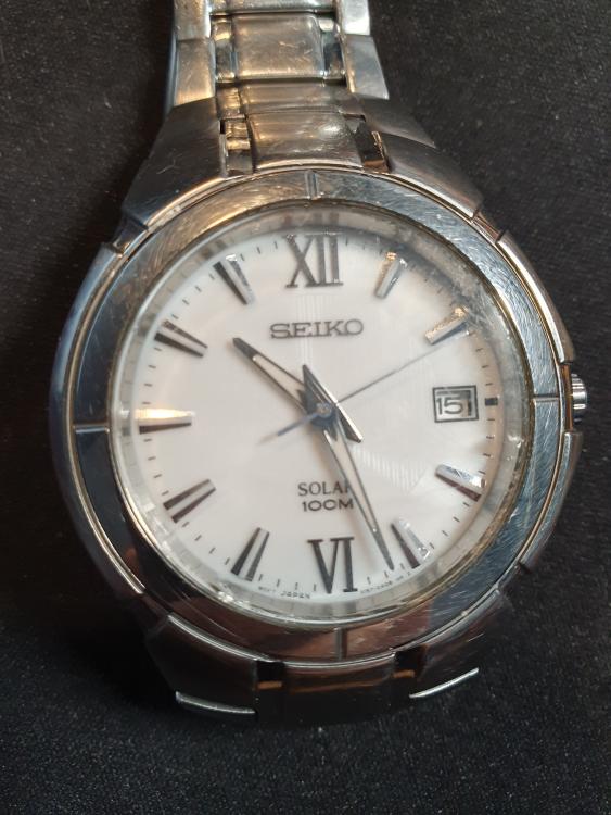

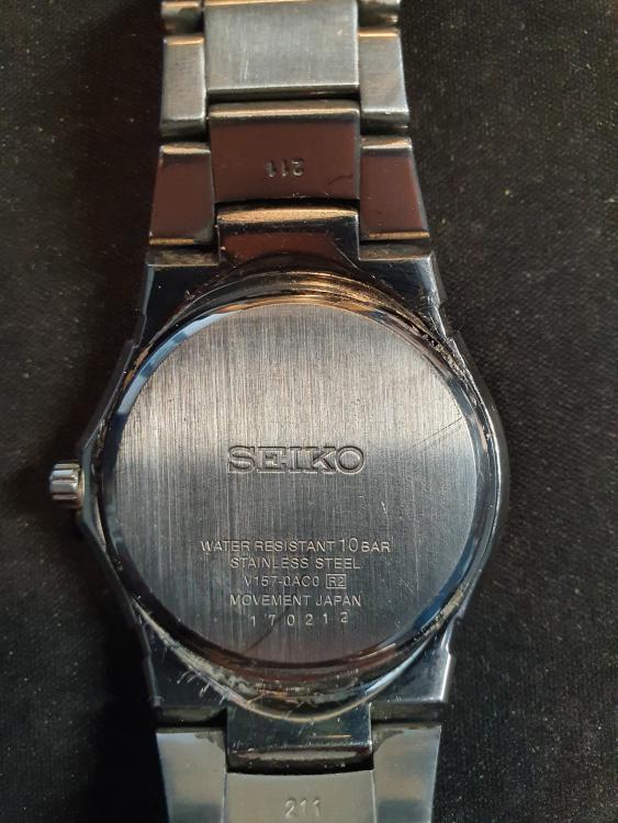

At the very minimum you need a good case knife, e.g. "Japanese type". In stubborn cases a lever type special tool may become a saving. Then the problem could become closing it, for which a small press is used.
My advice, unless you are willing to spend money for proper tools, bring the watch to a shop. Otherwise more damage than the one it has already suffered will be made.
  On 2/16/2021 at 8:24 PM, philipk5 said:
Also have you got a new cell yet?
They are particularly pricey for the V157 / V158 (£50+)
Expand
Good point. As with any quartz watch there is no guarantee that just giving it power it will work. Perhaps one should attempt with a long exposure to strong light, or temporarily powering from a regular battery before spending for a new rechargable cell.
