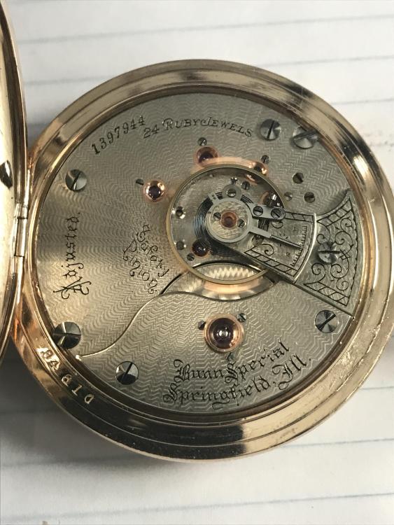

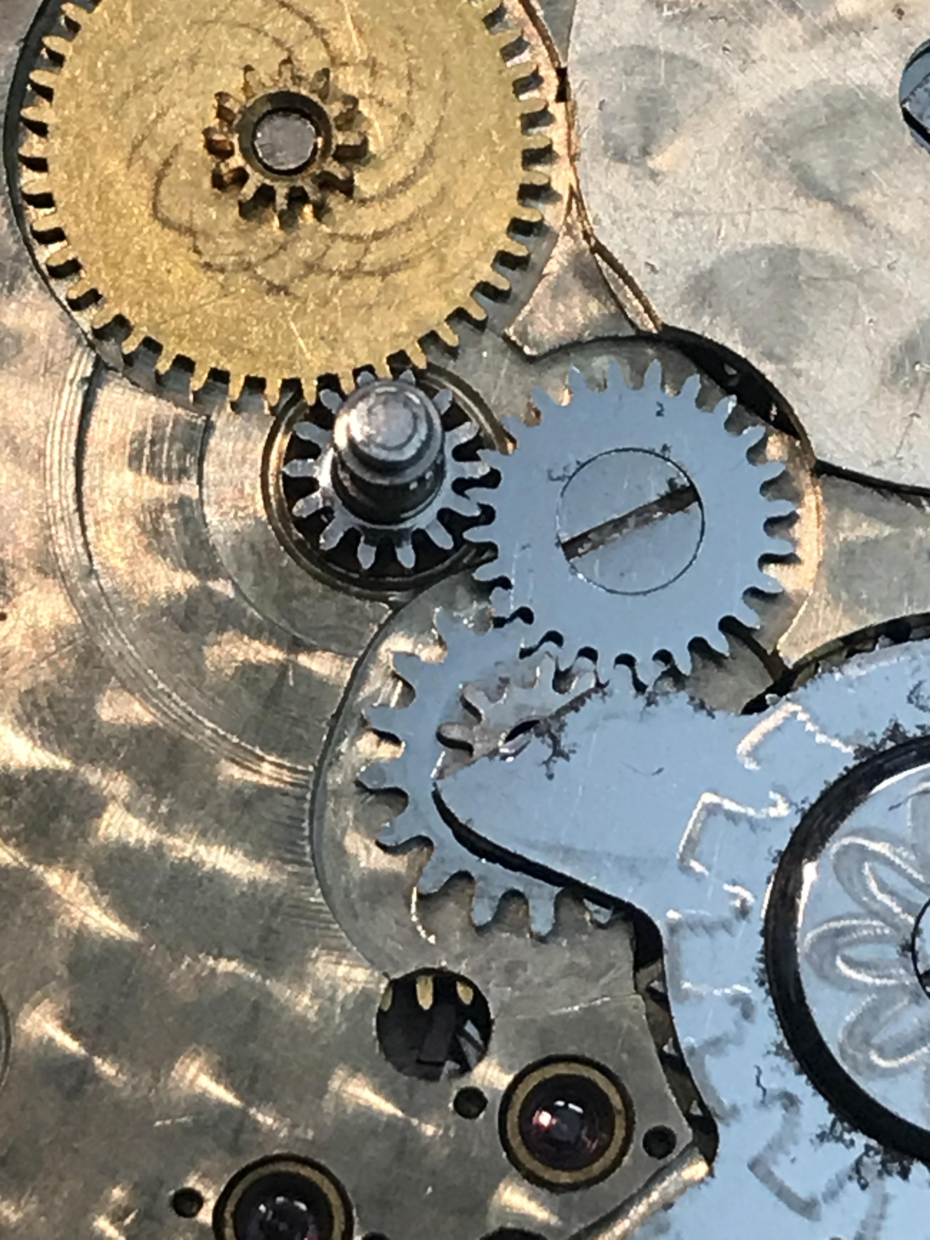

I have gear 2 teeth missing on a 24 Jewel Illinois Bunn Special Pocket Watch. Not sure where to source this part. It is a small wheel attached to a larger wheel. 34E0AEFA-1AA0-4579-93B4-095B19B400DD.thumb.jpeg.4d91dcc013f18faf02f0ec2ceb51aa75.jpeg

That is, a pinion. It can be cut on the watchmaker's lathe with a divisor disc, milling head attachment, and gear cutter(s).

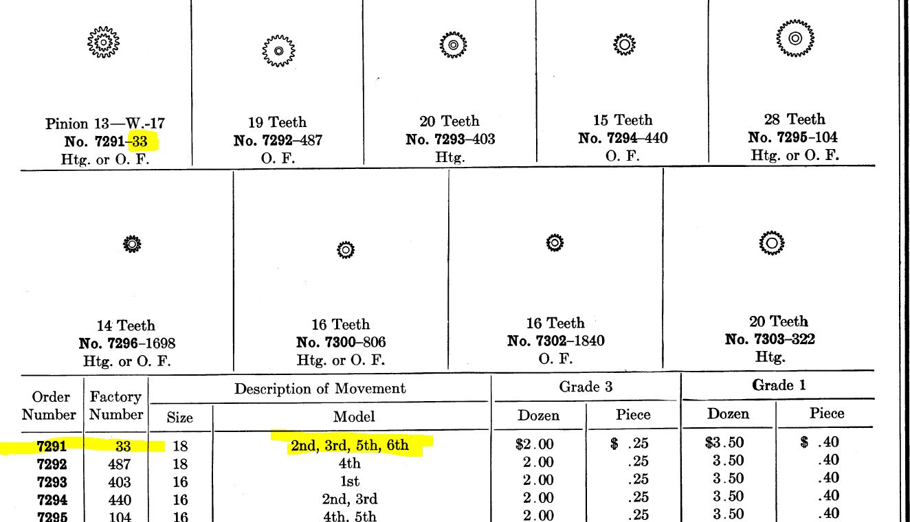

It would probably help if You knew what the part was called you're looking for. At the link below you can also look at the parts it looks like this is a setting wheel.
I snipped out an image from the website indicating it's a setting wheel
Then the Illinois 1923 parts book the closest you're not come to a cross reference.. So basically it's going to work in a whole bunch of 18 size Illinois pocket watches. The easiest will probably be to find a scrap movement that you can get the part from. Otherwise it's a gear cutting project as already suggested.

Hey thanks, appreciated.
Parts interchangeability is significant between Illinois 18 size models, as the image shows. Donor movements abound, and Dave's Watch Parts/Dashto has most of the specific parts you'd need for an 18s Illinois if you don't want a whole movement.
The 6th model movements were made during a period of tighter, more precise manufacturing and finishing, so one of those would be an ideal donor movement if it has the parts you need. The 2nd models go back to the 1870s and are a bit rough.

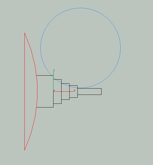

Here's what a well known watchmaker told me on the subject of cutting pinions. I was wondering about the work sticking out too much on order to make it reachable with the cutter wheel.
I've only cut pinions between centers a couple of times. It is an excellent way to do it, but the setup time is usually more than it's worth. Usually you can start with a larger bar, and neck it down and maintain rigidity. For example, a 0.8mm pinion with 8 teeth. I would use perhaps a 3.5 or 4mm bar, then step it down until I had enough of the right diameter sticking out to cut the teeth. The steps will provide clearance for the cutter teeth. Smaller diameter cutters are helpful here, most of mine are 8-12mm diameter. The cutter might bite into one of the steps but it doesn't matter. So with a 10mm cutter I would have a maximum of 7 or 8 mm sticking out of the indexer typically; at 8mm I can comfortably cut 3mm worth of pinion teeth which would almost always be plenty. Then it goes back in the lathe and all the features are turned (pivots, shoulders, rivet etc). In the sketch that's a 4mm bar, with 8mm sticking out. Stepped down, cutter just kisses the steps (could bevel them if wanted but like this is fine). 3mm of pinion can be cut.
