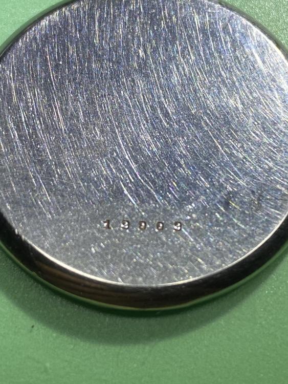

Hi All, I have a JLC watch supposedly from the ‘50s. I have no experience of this brand but from internet research the numbers stamped on the movement and watch back are all different.  The watch back is stamped ‘19009’, the barrel bridge is stamped 86104 and the movement plate only has the number 56. I can’t find anything on a calibre 56 that looks like the movement in the watch.  Apart from servicing marks on the inside of the case back there are no other markings. Is this a hash of different parts cobbled together?
I don't think it's a hodgepodge. LeCoultre made a number of calibers on that base, the most common being the 424 and 438. You can tell the difference by measuring the movement thickness. 410 is 3.35mm, 424 and 438 are 3.50mm, then 413 is 3.90mm. The only way I've been able to tell the difference between the 424 and 438 is by the crown and ratchet wheels, they have finer teeth in the 438 (30 teeth in the crown wheel). Yours looks to me like a 424.

That’s incredibly helpful, many thanks nickelsilver. I’ll measure it up later.
