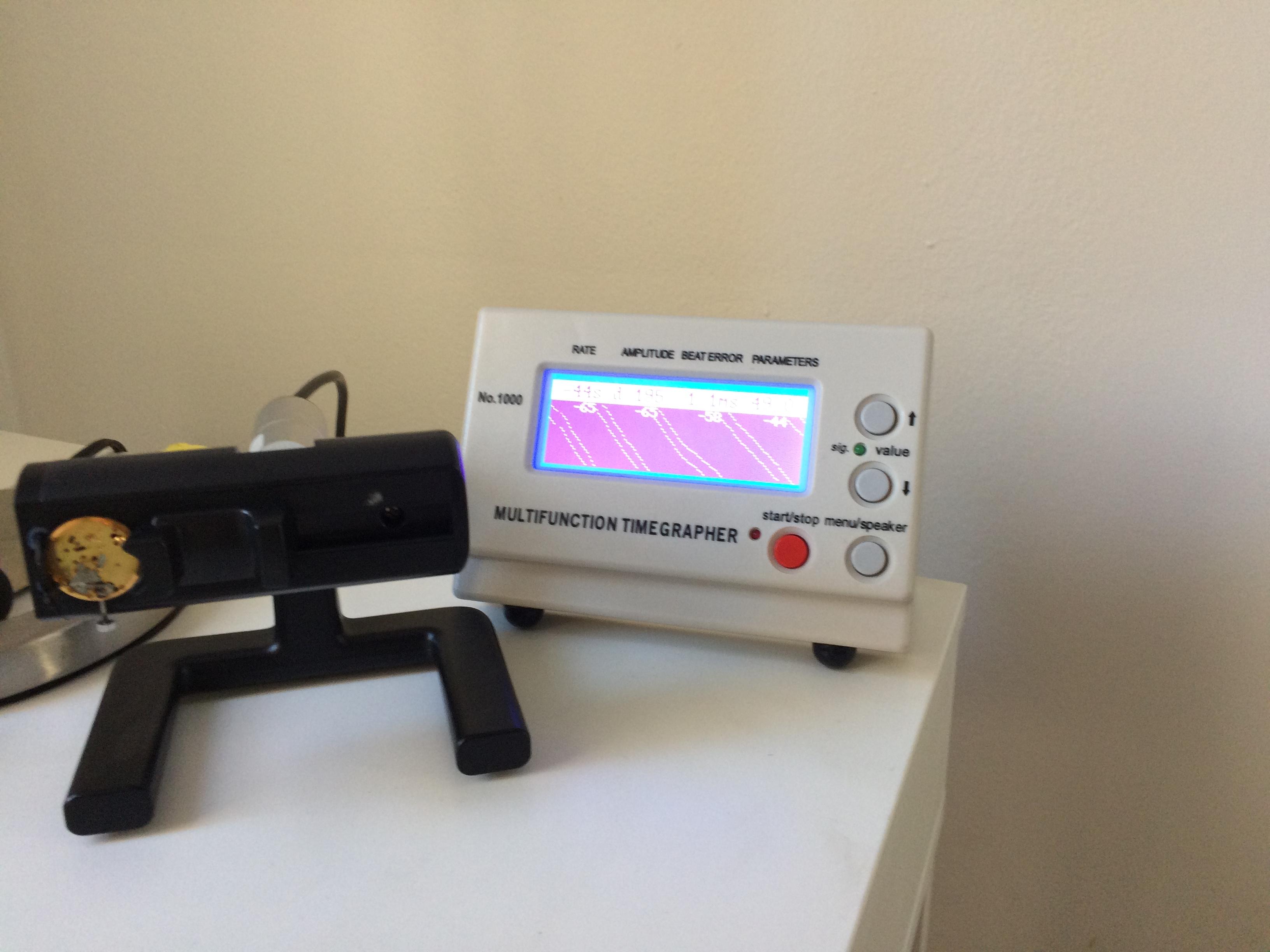

I have a Luch 2209 which has had the grave misfortune of being my first project commenced (although not completed) after completing Mark's course. It's been on the back burner while awaiting a scrap movement. Here is the problem.
After cleaning, lubrication, and demagging, the watch has a very wavy trace. Decent amplitude (280-300 at peak) and a clean trace, but constantly changing rate. It almost never settles down - amplitude rises to 300 and falls to about 250, with the rate changing by perhaps 30s/day. There is no consistent pattern - sometimes down then up, sometimes down then flat then down again.. About the same in dial up and dial down. No consistent time interval between shifts. Hairspring is perhaps not perfect, but not badly out of poise. Beat error is around 0.9, so close enough with a fixed stud.
The watch is definitely not magnetized. I have cleaned it twice and inspected all the parts closely. The only problem I could find was a worn barrel arbor bearing, so I swapped in a new barrel bridge from a donor. No change. I thought the mainspring might be tired, so I cleaned the spring in the donor and swapped the barrels. Nothing.
I'm pretty well out of ideas at this point, so I guess I'm just going to keep swapping parts until I find the answer! If anyone has ideas, I would be very glad. Many thanks.

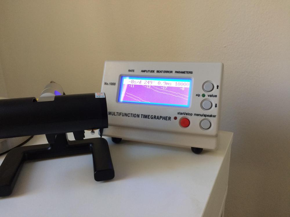

First 3 are dial down. Oscillation between about 220 and 270 degrees amplitude. As you can see, it’s not a rapid oscillation, more a slow, never-ending adjustment.
The next 3 are dial up, pendant down and pendant up. As you can see, the average rate varies considerably between dial down and any other position, but not that much variation between any of the other two. The magnitude of the amplitude variation also seems to be slightly less in positions other than dial down.

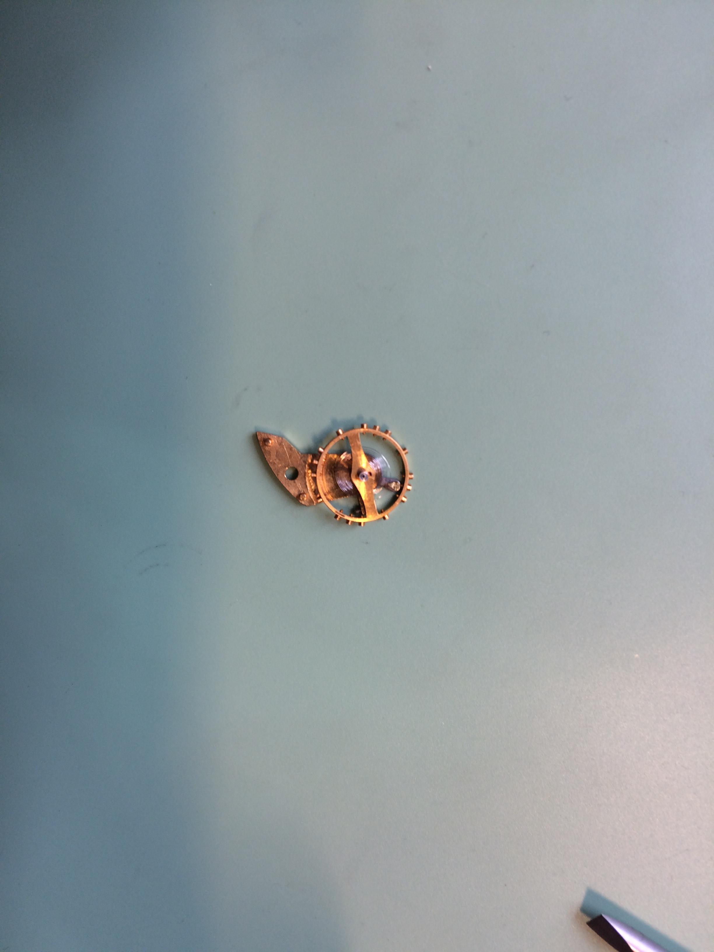

There is quite a difference in rate between dial-up and dial-down, yet not a significant difference in amplitude. Are you sure that the hairspring is breathing healthily - clean, no sticking, fouling, and the stud height is good?

Thanks to you both. Rodabod, a picture of the balance is attached. Not sure you can make it out. I don’t think the spring is perfect, but nothing is stuck together. Full disclosure, I bought a donor that was actually running in order to get the balance complete. On the original I messed up the hairspring trying to put it in poise. However the wavy trace issue was preexisting, and I was hoping to tackle that before the positional variation.
