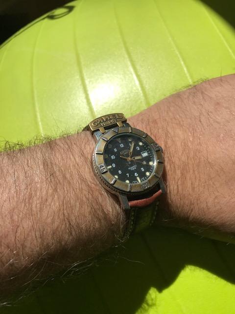

For a while ago I thought that it would be fun to see if I can get my childhood watch ticking again. I think it's about 30 years old and has been standing still for about 25 years. Long story short, it ticks again, it did get a new wrist band and now I'm looking at some of the smaller and tricker repairs which is why I started looking for a good forum on the watch repair subject.
