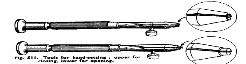

But, do you belive that also the following tools are needed?
Honestly speaking I cannot find them anywhere: I don't even know the correct name they have , in order to look for them properly.
The Mark's ones seems old and valuable…..
Thanks
Buf
I think they are called rubbing in jewel tools. I have seen them for sale on ebay under watchmakers tools vintage, just looked for you nothing there at the moment. Have you tried the watch tool suppliers? You could message Mark and ask him how he got his set. I'll keep looking, if I find any I'll let you know.
