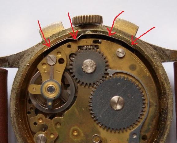

I’ve bought two "spares or repairs" watches to experiment on. One is branded "LEWA" which I assume is a generic brand name and has what looks like a fairly basic mass produced movement (not jeweled). The other one is branded "KANDER Marines"; the automatic movement is marked "BREVETS". With 25 jewels it seems to be a much better quality movement than one in the LEWA. Amazingly both run and keep reasonable time.
Starting with the "LEWA", the stop/start buttons are a bit of a puzzle because they don’t touch the mechanism. The stop/start function does work so unless someone can suggest a better alternative I’ll solder a small piece of brass on the inside ends of the buttons. The plan is to start with this one, take it apart, give the movement a through clean and try(!!) to put it all back together.

The first movement is a manual wind Lapanouse. It is frequently used in simple stop timers . Not true a chonograph, but useful nonetheless. It looks as if the pusher spring is missing in yours. The attached photo where the red arrows points to one. The second is a BFG 158 automatic. I have one in a Dicura watch, it has been a real bear for me. Very challenging. The date is driven by a wheel that in my watch, the arbor which was supposed to be staked into the mainplate, had worked itself loose and the wheel was flopping around under the dial. the second photo lists those items
Lapanouse/Rego movement
BFG 158 Movement

FLwatchguy73 - the  case of my LEWA seems to be larger in diameter than the case your Lapanouse is in. Yes the spring shown in your photo is missing but there is a springy lever attached to the lever shown at 6 o'clock in my photo (see 1st photo). I think extending the buttons by a few mm may be the answer here.

In regards to your Lewa watch, the movement I believe, is held in place by the back cover of the case, The thin piece of steel that you highlighted is the return spring for the stop and start pushers. I found a better picture online and it is now clear to me how it works. You should try carefully bending the tabs out enough to better perform their function. Good luck.
