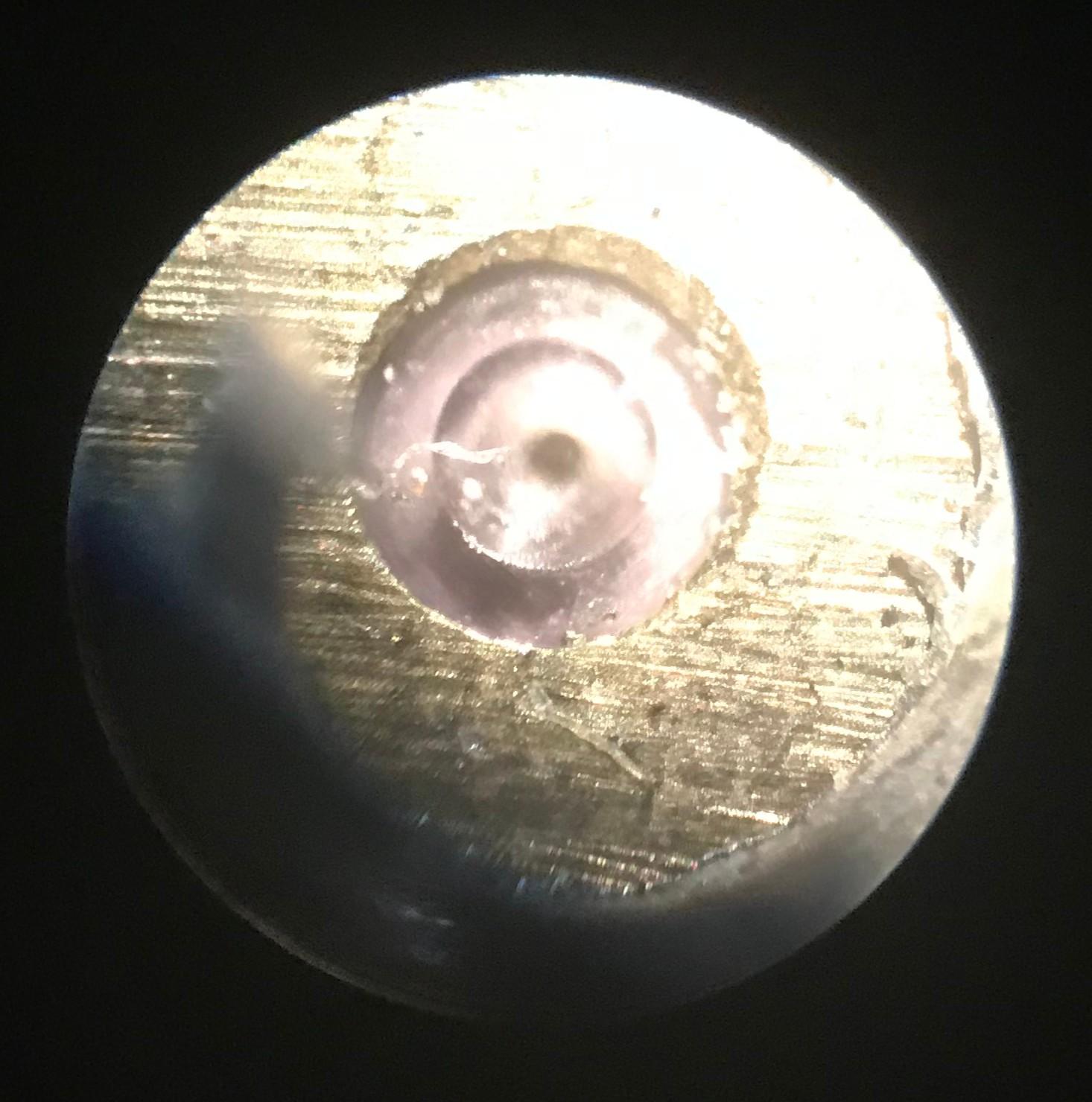

I received this fully wound. Balance would move but seamed to be rubbing on the bottom.  When I loosened the bridge screw the balance started to swing.  I removed the balance the movement unwound and I don't see a pallet fork.  Can any one tell me whats going on? I would also like to know who made it and what the movement is? Thanks.
It Is indeed a cylinder movement(no fork) the escape wheel operates directly on the balance staff (cylinder) which has cut outs to arrest the wheel, locking and unlocking basically the same as the fork/pallet.
Does the top and bottom stones look ok?  How about the balance staff?  Any one know who made it?
They look fair, who made it one probably can see when you strip it down , a while ago I posted a stripdown of a cylinder movement maby that can help you on the way..
The balance wheel is sitting too low and rubbing the escapement bridge.  It has to be a worn stone or staff.  My skill level is not there yet.
The pivots can be moved up and down in the cylinder to adjust end shake and the correct height of the cylinder in relation to the escape wheel.
You may find a makers mark under the dial. If not you may be able to identify from the keyless works and the movement diameter.
The case is a generic silver import carrying the mark for George Stockwell whose sponsors mark appears on many imported silver cases of this era.

I take it to do this I have to remove the hair spring first. How are the pivots adjusted?  I have a staking set but I have never used it.
