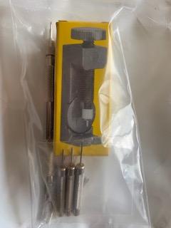

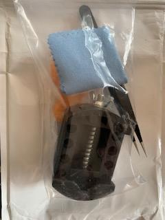

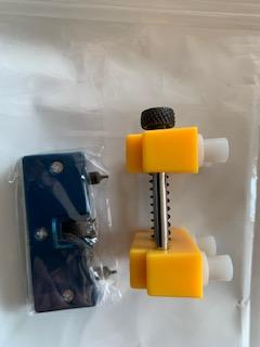

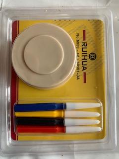

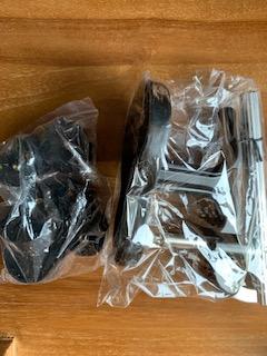

Following on from my intro + initial post, here's what my first round of "OCB fixes watches" tooling looks like:
Feel free to laugh/cry etc - don't worry, I most certainly don't take myself seriously :lol:

I do regret buying the oil from amazon actually, and I've not even opened it!

Your tools look a lot like mine at the beginning. I still haven't bought better oilers and cups. :biggrin:
Part of the fun is also finding which tools do work and which don't, and where is worth to save from 1 Euro to 1,000, with anything in between. Spoiler, that "caseback wrench", may get you very, very upset when presented to the "right" caseback. In that case (pun intended) the latter -albeit scratched- always come out winning.

Lol- yes. I just finished my first case opening (my Seiko/Feiko), and - even though it "did the job" - I can see how it could easily slip and rip a nice scratch along a case back.I'll post about that watch later on the repairs section.

Alright, some more spoilers. The yellow case holder is crap but the black one is damn good. Fit it in a vice or clamp it. The pin remover is also good. Punches, on pin and collar bracelets all you need is 0.8 or 0.9, and 1.1mm. Also urgently needed Seiko style (there are 4 types, pick based on your mood) caseback opener, which you may need to sharpen. A crystal press and lot of other cheap stuff. Some you can also use for electronic repair, some is just cute to look at. Once in there is no way out. Sorry.
