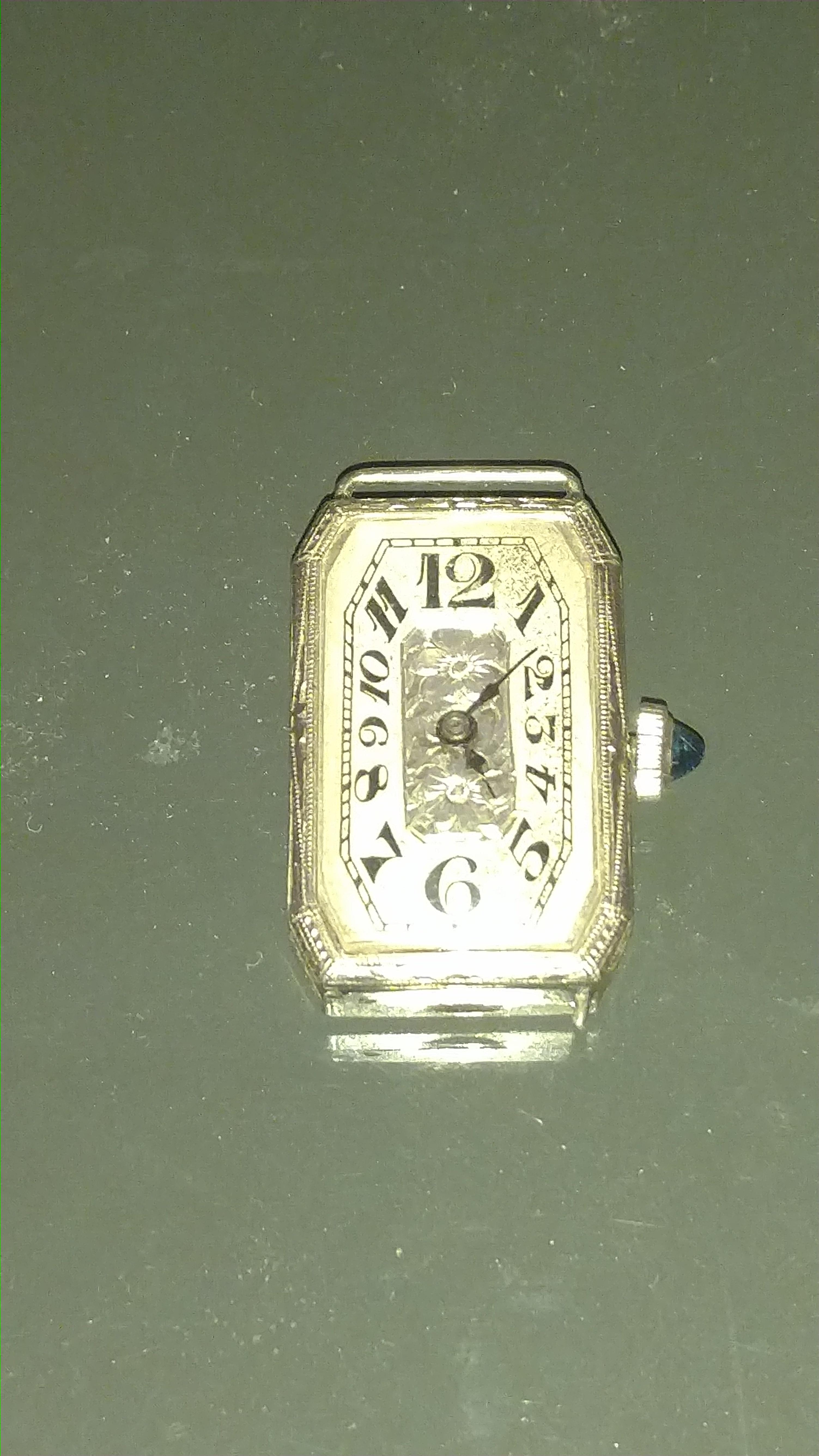

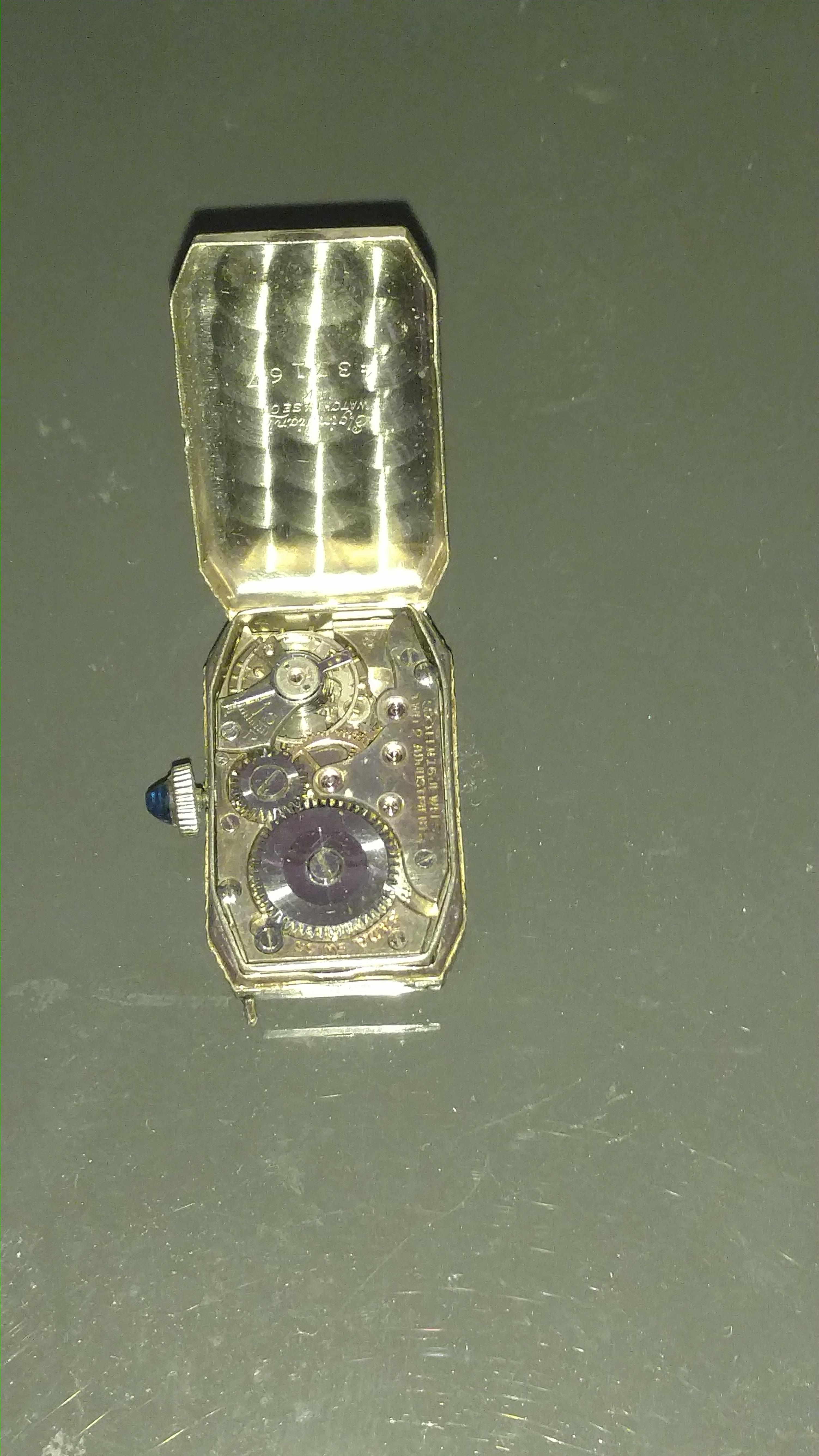

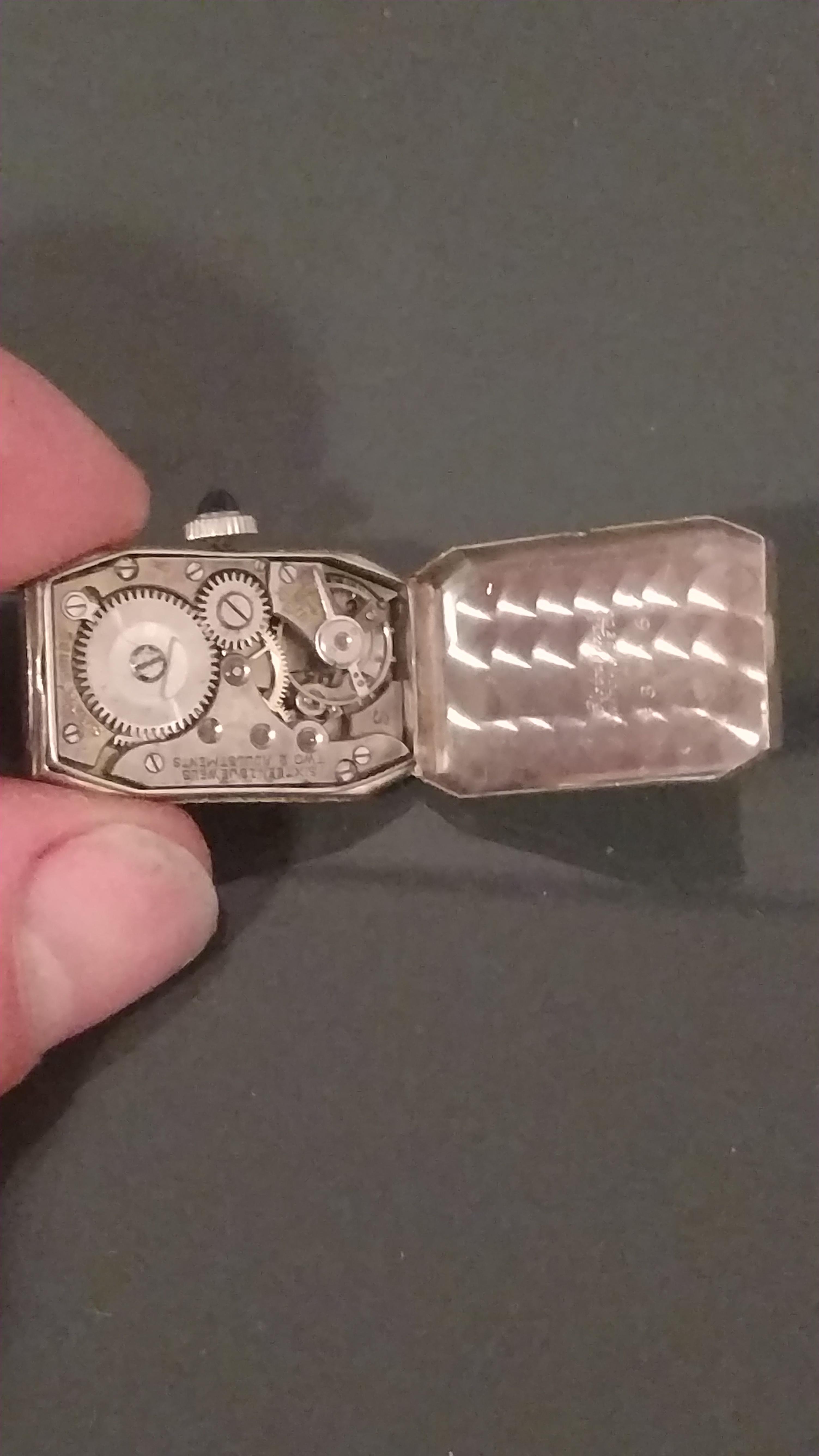

Hi all,
I have a vintage ladies Elgin cased watch (see photos) that I'm planning to repair as a Christmas gift to my fiance. The movement works fine (runs ~7-8 hr on a wind) so all I really need to worry about are the cosmetic items. I'm not planning on touching the face, and replacing the band hoop won't be an issue. I'm a former jeweller and can do the metal work easily enough. But I have a few other questions:
Removing and installing the crystal? It appears to be plastic (it's domed) and I don't want to damage it. How should I remove it and where should I go for crystal cement?
The stem sits at an odd angle? Any way to fix this or is it a live-with situation?
Winding? I didn't feel any stop or clutch and I'm concerned about over-winding. Any guidance on care and feeding? The watch will be used as a dress up/date night accessory only.
Band? I've found some nice metal spring bands. But what about leather bands? Where can I find one if I go that route?
Thanks!

i think you mean "it runs", I suppos you have not tested it on a timegrapher or equivalent application, but from a watch repairer point of view, that is a must. 7-8 hours is not even nearly enough for practical usability.. In other words, if it needs to be used then mov't will need total service (full strip down) and very likely a mainspring replacement. Nobody expect performances from this type of watch but I think is reasonable and rewarding to bring them to the original specifications. Unfortunately ladies mov't are more challenging to work on due to their small dimensions, so I do not recommend you start with it, you need to do various full and medium size before.

Just don't remove unless is needed.

Looks like you haven't even removed the stem? It is bent, you can try straightening it or just get a new one after the mov't is identified.

It must stop when winding otherwise it wouldn't run. Normally it gets a tighter a bit before winding stop. It takes a bit of force to over-wind, which simply means you have broken something.

From the pics I can't even see if it has fixed lugs, or what. In that case you need and open ended strap.
That's a nice little watch and definitely salvageable. You need to know what you're doing before fixing it up entirely, though.
The crown... either the stem is bent or the crown tube that the stem goes into is bent...
What do you want to to with the crystal ? Replace it or just clean/polish it ? Hypo GS cement is probably what you're after. It takes a bit to dry up and it's transparent.
Maybe you didn't wind it up to the maximum (don't do that until you've inspected and serviced the movement; it's an old watch...). Usually if there's something broken inside it won't wind at all (the mainspring will uncoil each time you wind it once you let go of the crown).
I'm guessing these came on a leather strap. You'll need one that can be installed on fixed lugs. I think they're called open ended straps.

Regarding the crystal, Doing the solder repair for the lower lug will require removal of the crystal, which is why I asked the question. I don't plan to replace it (it's in good shape), so careful removal will be required. Chopin covered the crystal cement question (thanks!). I've done plenty of crystals over the years, but primarily on modern watches.  How should I go about removing this one?  Any special tools or warnings about what not to do?
I haven't removed the stem yet.  I just pulled the watch out of my box of goodies and tested it the other day before posting.  It spins true (no wobble) so I'd lean towards Chopin's suggestion about a bent crown tube instead of a bent crown/stem, but I'll investigate over the next few days when I remove the movement.
By "fixed lugs" I assume you mean no spring pin?  That is correct.  This is the case repair I'll be performing.  One hoop is missing so I'll be fashioning a new one and soldering it in place. The broken ends of the lug are visible in one of the pictures.  ...  I think a leather band will look best.  Any suggestions on brands/styles/sources for vintage bands?  We used to sell cheap spiedel replacements, which I never liked. Does anyone make good quality reproduction bands?

Wait, one of the lugs is broken off ? I hadn't noticed.
Given that you have to make it identical to the others it'll be tricky... As jdm said, this can cost quite a bit of money...
Regarding the crystal, it's quite possible that it has cement already so pushing it out will probably be tricky and I advice proceeding with caution.Study the edges a bit, see if you spot any glue or residue. When trying to push it out, do it slowly and correctly so as not to break the crystal.

Quick update on this, the lens wasnt glued at all. Just bezel set I to the case like a cabochon stone... I'm assuming that means it's never been replaced.
Anyway, removing it took about 30 seconds. I have the new lug made and ready to solder on (just need to get everyone out of the house for a while so I can work in secret).
I was also able to straighten the bent crown. Things are coming together nicely. I just wish I had more time to work on it!
