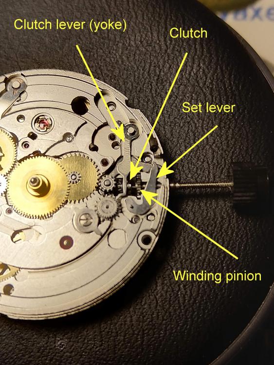

I took some minutes and tore down a movement to show what to look after and how to rebuild the keyless work.
The first picture shows the parts for you, to think about here is that the clutch goes in the right way, The straight cut gears should point towards the motion works, the winding pinion should have the angled gears towards the motion work too.
The clutch lever is placed into the grove in the clutch. If mounted as in the picture you should be okay.
In picture 2 the spring pops into place, just be sure it is installed correctly otherwise the winding action might feel a bit of.

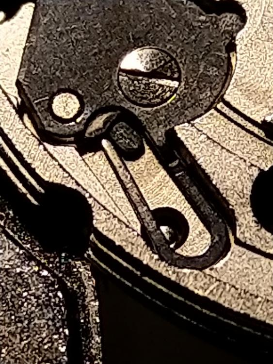

Here is an attempt for a closeup on the upper checkpoint area, the spring that gives the force to the clutch in winding mode..
This has to be in the right position.

On the ETA version which I am working on the winding pinion is rotating when you have the stem pushed into the inner position. Then it is winding your mainspring. Hence the name. I would be very surprised if it did not do that on the clone too.
The only time the winding would not work is if you haven't enough force on the clutch to grip into the winding pinion.
Of course a missing  crown wheel, broken click spring, and a broken mainspring would do it too but as I understand it you just removed the key less work to fix the release button issue.
The force to grip the pinion wheel comes from the spring in the part you marked 3 in your photo. The spring part has to be adjusted slightly into position after loosening it to get the spring action to the clutch lever.
It is what you see in my third picture.

Even if the video is a little shaky one almost can see that the setting lever jumper (no:3 in your picture) isn't working as it should, it rises a little bit when going into winding position (Pos 1)
indicating there is something wrong there.
If you fix the spring action in this area, which probably got a little bit offset from the little to hard push on the setting lever (it holds the winding pin).
So dismantle everything again and carefully bend the setting lever jumper so it gets slightly nearer the main plate.
Make sure the grove in the winding pin is aligned with the little heel in the setting lever.
Make sure the yoke is correctly placed in the clutch (sliding pinion) grove.
Make sure the setting lever jumper is correctly in position.
Make sure the spring on the setting lever jumper is pushing on the yoke.

From the video you can see the yoke isn't moving at all, this indicates it might have jumped out from the groove in the sliding pinion and that is why there is no spring action when you put it in the Winding position.
You were right, I don´t know how but I put some pressure on the settings lever and pulled it a bit and now it works : )
