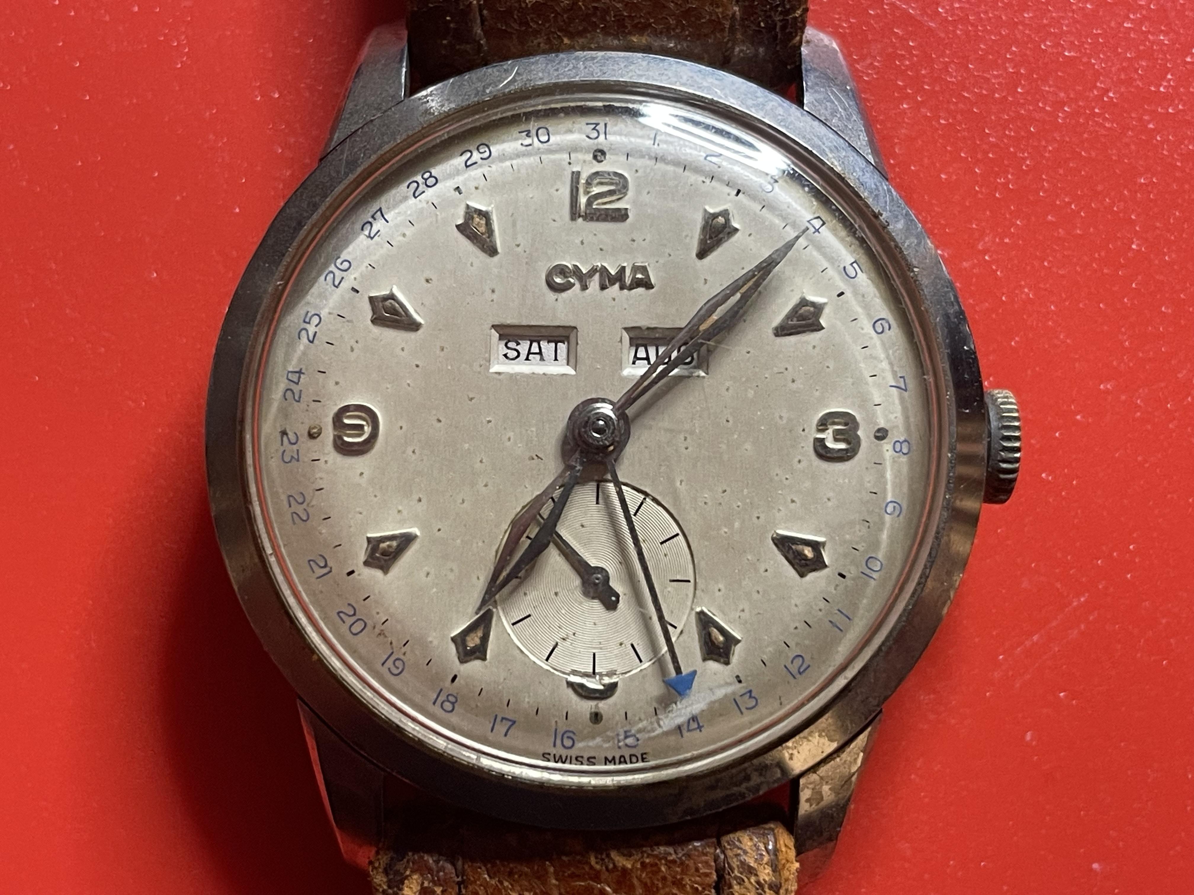

  7. I Have a doubt on a vintage watch I want to service. It's an old cronographe suisse I think from the 50's. Does it have in your opinion a radium dial?
