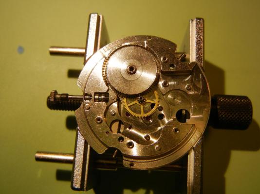

Thanks for all the help in getting this one out of the case and in letting the mainspring down. this is another first time for me, as I've not done a Japanese watch. it was a good experience!
Here goes:
The movement has just been cleaned at this point. This watch was running but had previously been over-oiled
I thought about leaving the mainspring because I still haven't received the winder but when I saw the barrel I knew this one had to be cleaned....
all clean

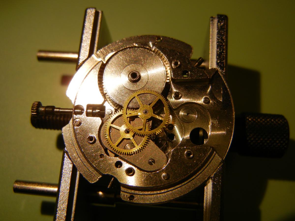

I began the re-assembly:
replace the balance...
and now for the autowinder---this time I don't lose any parts and everything works out
post-328-0-15812400-1414220391_thumb.jpgpost-328-0-84089100-1414220395_thumb.jpgpost-328-0-41152700-1414220400_thumb.jpgpost-328-0-08824500-1414220405_thumb.jpg
Now for the front:
post-328-0-91030700-1414220409_thumb.jpgpost-328-0-58092000-1414220515_thumb.jpgpost-328-0-03960000-1414220535_thumb.jpg
and the hands...
Unfortunately the recasing gets me at a bad time and I struggle wit the tiny crown/stem replacement and lose some of the lume from the minute hand in the process...oh well.
All in all a good learning experience,. I didn't realize it, butthis Seiko does not have a way to hand-wind because there is no crown wheel (winding pinion) that engages intermediate wheel to wind the barrel. All autowinding on this one.

Good job and great experience for you Joe.
You're correct, it is an auto only, but you can wind it with a screwdriver before installing the auto mechanism to aid fitting the balance and also check that all is well.
Nice work, is it a Seikosha 2451/Seiko 6601? Got a couple of these as Seiko Sportsmatics, excellent timekeepers. As far as I can tell the vast majority of Seiko autos are non hand winding with the exception of the 4xxx series.
Great job JC, and good experience gained! By the way, apart from the dirt, extra oil, etc, it is of note that Seiko uses a black lubricant for the mainspring. Maybe this model had some...it would look like dirt.
