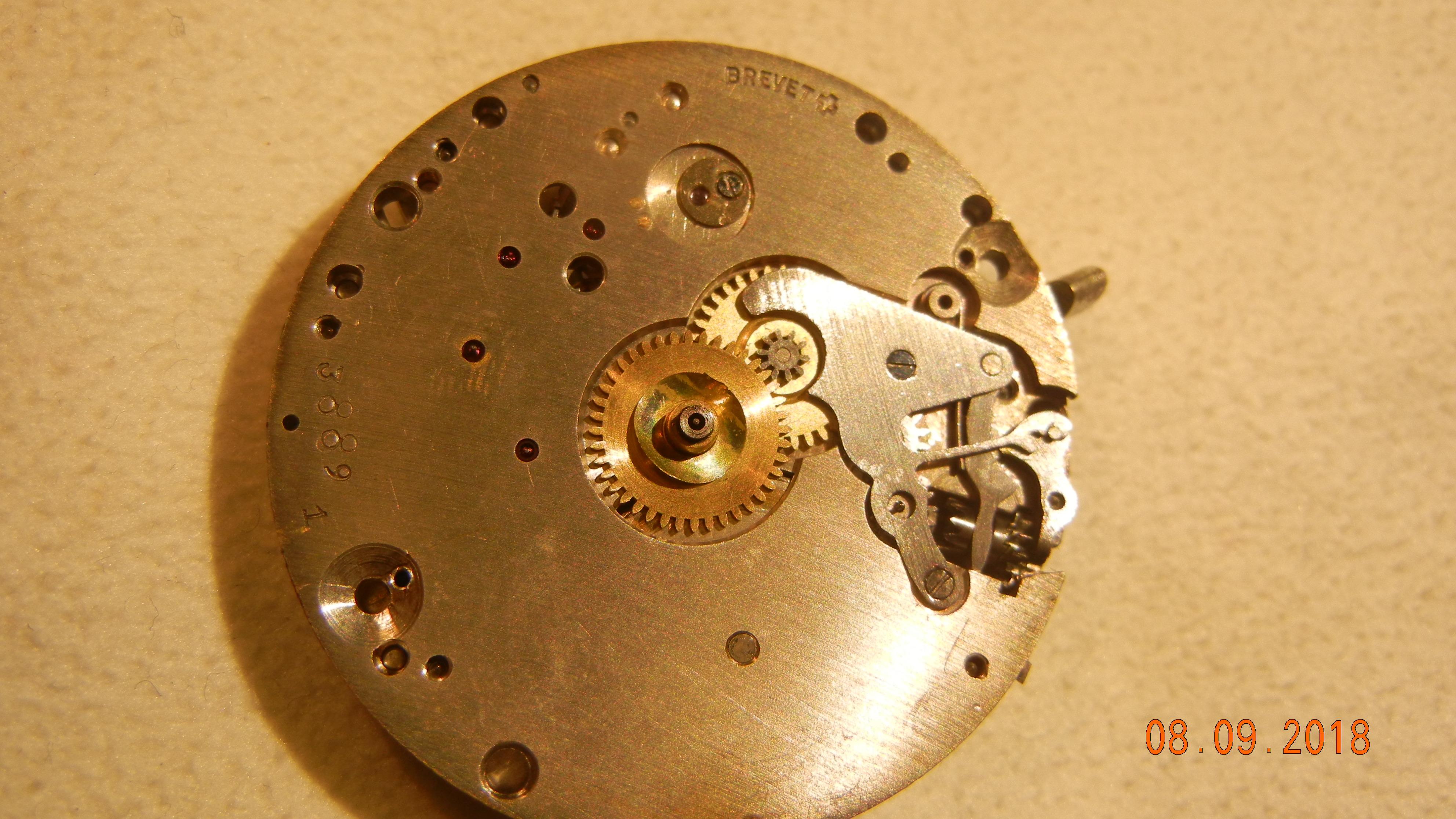

 Here is what it looks like underneath the dial:
@wls1971 Can you confirm its a Landeron Hahn?

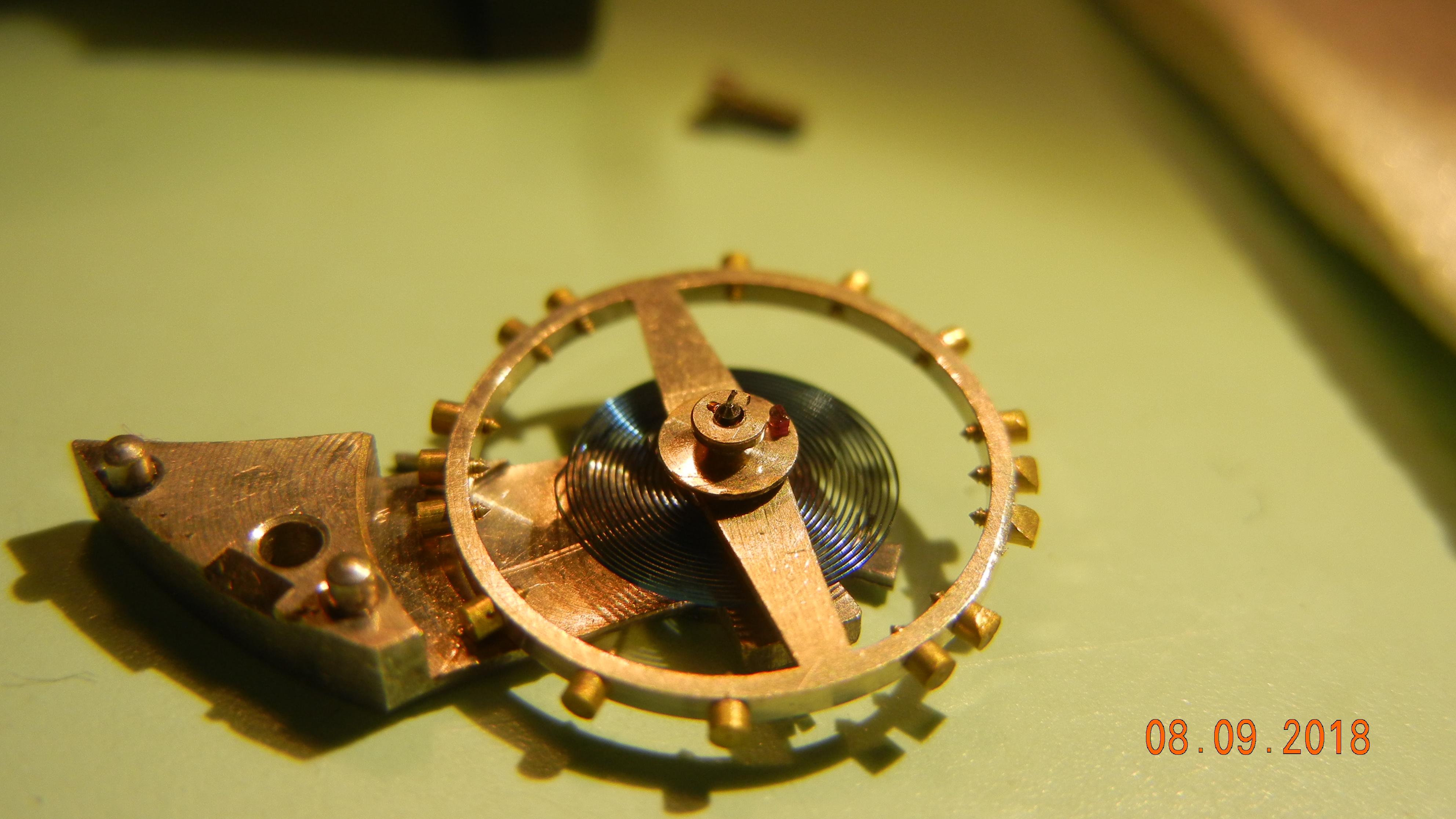

Here is what the balance pivot looks like:
I don't think it can be straightened out,but I'd love input if possible. The darn thing will tick if its dial-down, so probably all else is OK, but I plan to replace the mainspring as well.
J
Yes its a 15 1/2 ligne 35mm or 16ligne 36mm Landeron/hahn  it looks like the bottom cap jewel for the balance has been replaced could this be the cause of the bent pivot ?
Edited by wls1971
YEs it noticed that bottom cap as well. Its hard to say if that was the cause, as the caseback has one watchmaker's date to 1951...nothing else. Its fair to say the watch may have been dropped or sustained a strong jolt. I am going to take the measurements of the balance staff that is present, and order a new one. I might try my hand at straightening it. Thanks for your input!
J
1 hour ago, praezis said:
Looks like the pivot is not only bent (imho too much for straightening) but also is heavily worn.
Frank
I think you're right. After I measure it, I'll try just as an exercise!
J
