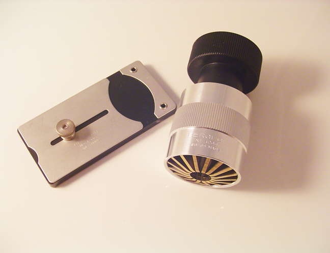

I think you are being a little fussy, why because when it comes to gaskets you can buy assortments from suppliers, from that selection you can find one that fits. If the back doesn’t screw down properly you know you have the wrong size or shape. With crystals if it is  a high dome and you use one of these (see photo) you can squeeze it to fit, in other words if it is a size too big it will fit providing it doesn’t look stupid in height. Tension ring glasses are different if you do not have the right size they will not fit and you need the proper tool to enable them to fit correctly. The high grade watches you should be able to order the correct gasket and glass. When it comes to glasses there are to many types to mention.
