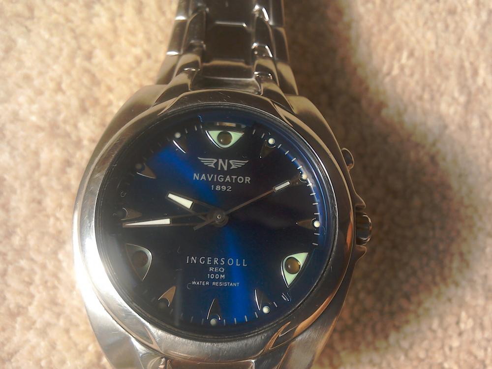

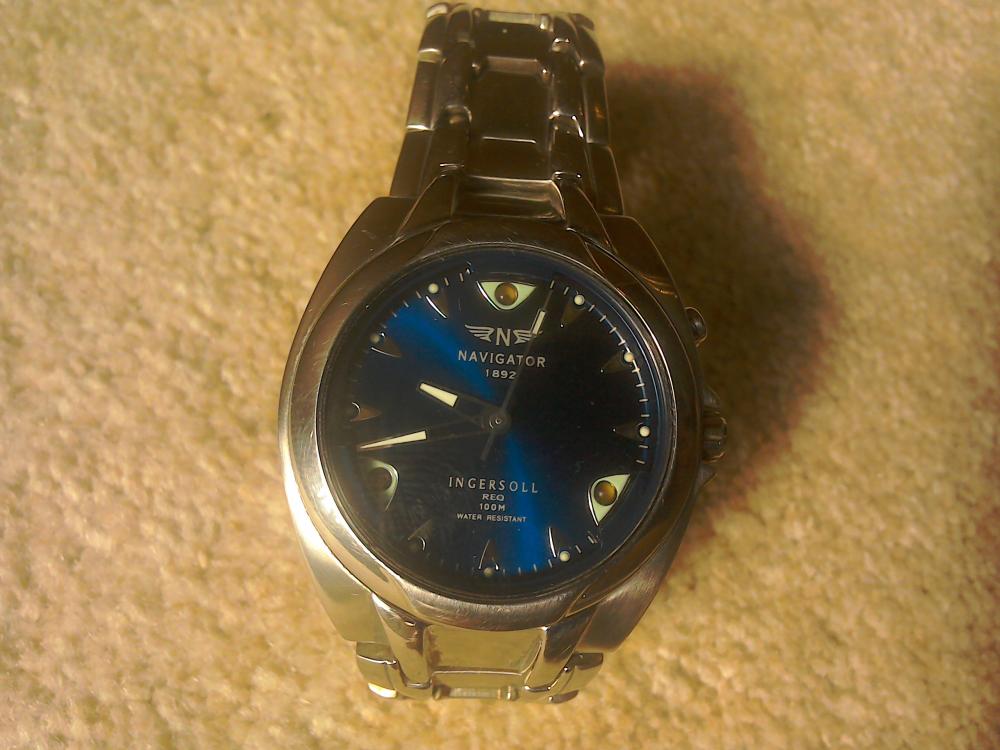

Hi, just introducing my newest addition. I am not usually interested in battery watches but this one caught my eye as it is rechargeable and came complete with the charger and spare bracelet links. It's keeping perfect time and appears to be virtually unworn. I don't know anything about this watch, age etc and if anyone can enlighten me I would be grateful. Bought at car boot sale for £12.50 so it didn't break the bank and seems very well made.
Googling only turned up a few examples similar to yours, seems to from the late 90s. They don't seem to keep their value very well given what people seem to have sold them for, including yours. Ingersoll watches new seem to go from £200 upwards. But I know nothing about the brands history ie if it's manufacturing standards have improved or declined over the years and so am not sure if current pricing of Ingersoll watches is any indication of original worth. Quite a nice, unique watch isn't it? Good find, especially given it's condition.

Have three of these Zeon Tech Navigator watches, but alas only one charger. They are rebadged Ricoh REQ & quite a nice quality quartz.
When your internal  rechargeable cell becomes tired (most are by now) you need to buy LIR 1620. The original cells are Sony US1620N, but the LIR1620 is a fit, form & function replacement.
Of course a standard CR1620 cell also fits, but then you lose the recharge ability.
