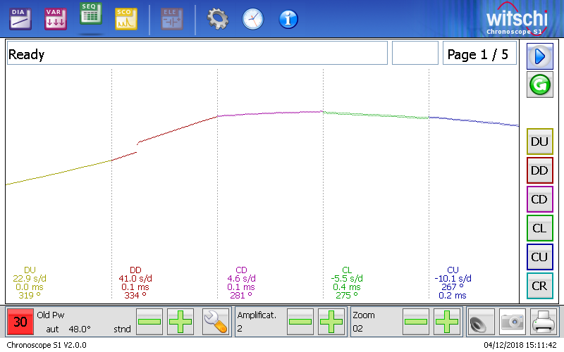

As you are showing different programs I thought I would show a comparison. So I'm using a TimeTrax clip on microphone which is a clock pickup piezo inside. Different preamplifier plugged into a USB sound adapter. Then I'm getting my power for the preamp off the USB 5 V as I really don't like batteries.
Then the witschi timing machine is nice photographing the screen is not but you can still read it. As you can see the watch is having issues but that works fine for software comparison. Then tomorrow it goes to work and the run it on machine there.
The comparison is good. It shows that with a good (expensive/professional) pickup you can use any of the three.
I'm trying to work out what will work best for a hobby user with limited funds - a cheaper mic with poorer SN ratio.

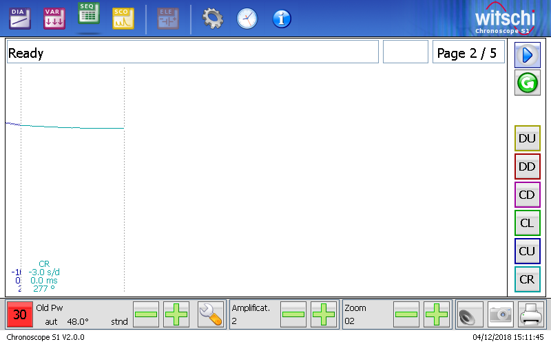

I thought I would finish the comparisons of the one watch I was doing. But this does show an interesting problem which I've seen before when doing multi timing machine testing. For instance one watch two hardware-based machines then you photographed both of them together which will notice is they're averaging over different parts of the waveform. So ideally when comparing everything it be nice if we had one watch multiple computers multiple machines and then photograph capturing that moment in time or we can study it in leisure.
So at home photograph on the witschi machine was first then same set up for all the software so they're basically one right after another. Then the next day or quite a few hours later the witschi at work. So I did wind the watch back up and let it run down a little bit conceivably it's not have the exact same state as when I took the initial photographs. Then notice the graphical displays are all the different? On the witschi at work they call it zoom it set to 2. My witschi at home is also on 2 but displays don't quite look the same graphically. Then changing the zoom feature does basically magnify the line.
Then if you've ever noticed any time someone shows timing machine results I typically ask for it be nice to have some multiposition results in their question. If you look at the dial down position you'll notice visible gap? Then on the numeric results dial down and dial up aren't quite the same? Then notice the amplitude seems be just a little too much and definitely too much on dial down. This is what happens when the roller jewel comes all the way around it bumps into the fork on the back side.
The positions that produce the greatest amplitudes are the horizontal ones for the balance wheel. The values should be as close as possible, that would indicate that there is no damage or anomaly in the pivots and bearings of the balance wheel axle or something in the pallets, roller ratio.Here I can guess that something happened. the watch received full wind. The main spring is completely wound up and that generates this bounce. (Rebanking.)

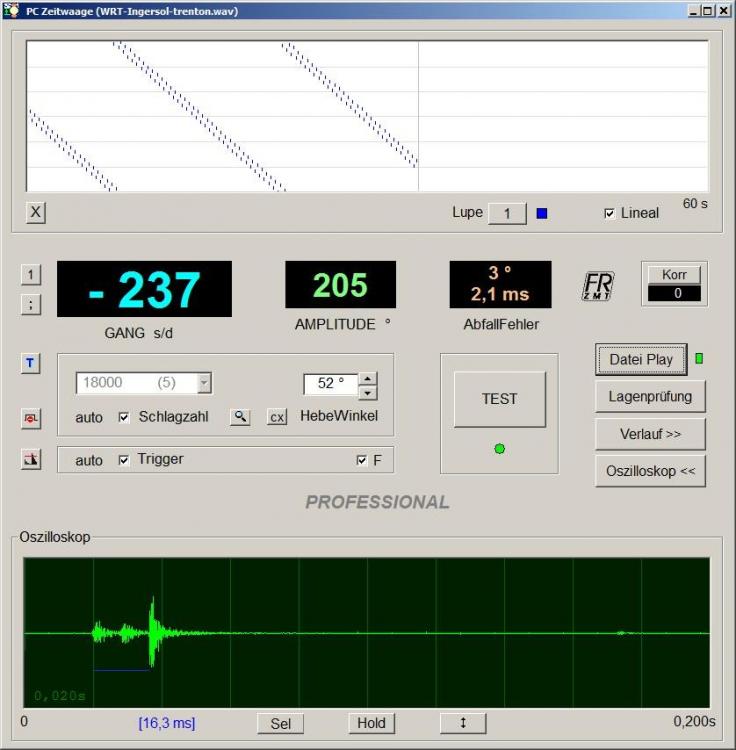

Hi,
rather late, I know.
But just today I read this interesting thread again and looked at the sound file "Ingersol-trenton.wav" from post #1. From the speaker I could already hear considerable echo. Curious, I ran the file in PCTM (after conversion to mono). But there was a nearly perfect graph line and waveform, I could not see any evidence of suspected echo:
Ok - filter is on by default.
Switched filter off:
Now the original sound appears. What a difference, the tic noise can hardly be recognized. Apparent is a wave at about 600 Hz, which probably comes from heavy resonance in the pickup device. And some 50Hz hum is visible, too.
Frank
