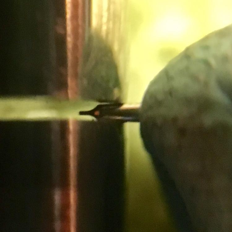

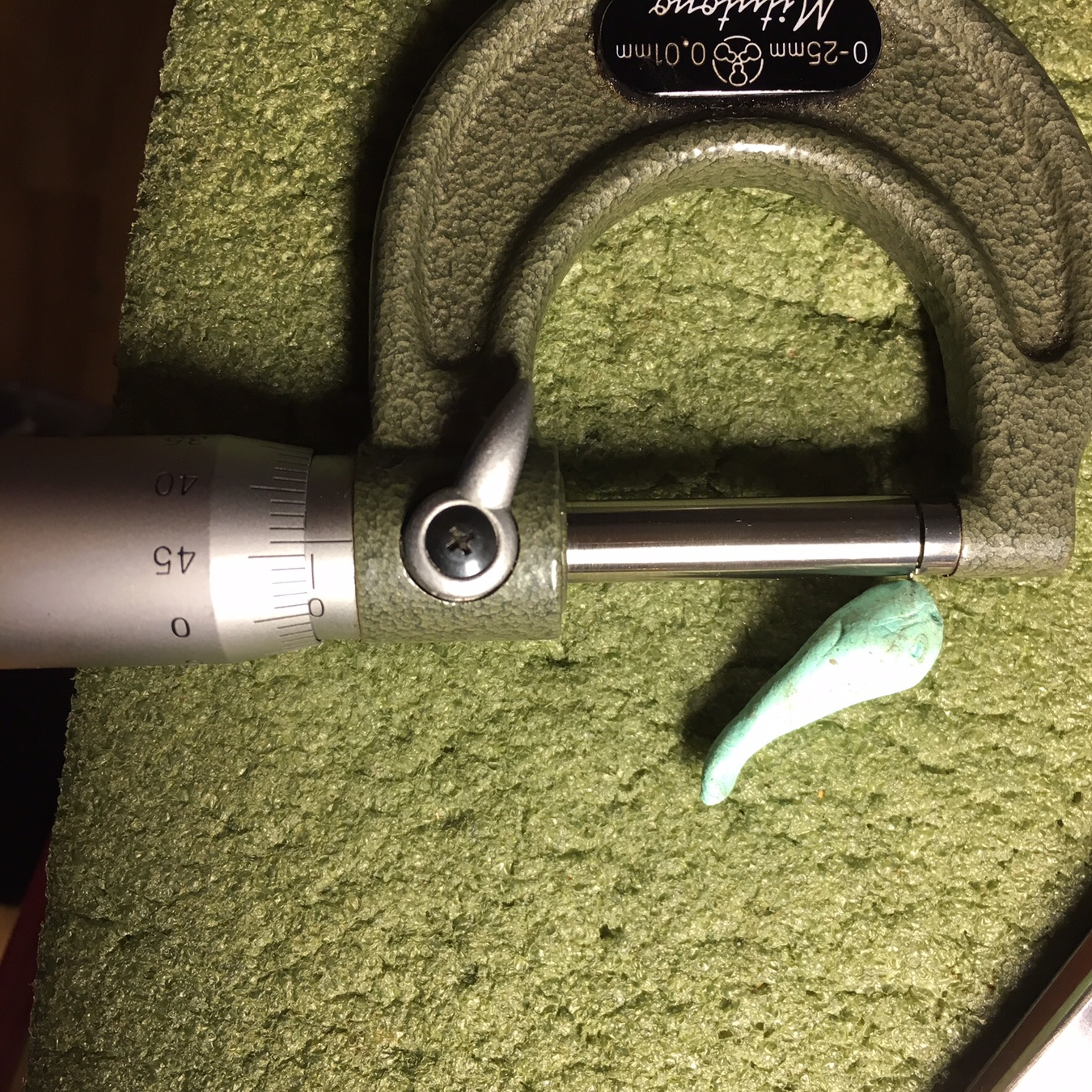

I measure the part where the roller sits to 0,45 mm (Rn2028 - 0,44mm) There's a photo attached showing where I measure. IMG_3660.JPG
The part for the hairspring collet I measure to 0,52 mm (Rn2028 - 0,50 mm)
Will anyone with experience out there take a guess wether my roller will stay on or fall off the Rn2028 considering that the Ronda staff appears 10 micron less in diameter?
In a larger context I suppose my question boils down to how trustworthy these Ronda staffs are as replacements as I suppose they were a kind of 2nd source and not "orignal parts" ?
Correction....
The photo is actually showing the poition along the staff that gives me the 0,44 reading i.e. Only halfways on the part where the roller sits.
Here's another picture showing the 0,44 mm position:
I am sure you can squeeze the collet. About the roller, just try it and see how it goes. I think you can squeeze it also, but in a staking tool.
Just don't use superglue! :)
Hello matabog,
As you say, there's probably no better alternativ than trying it out.
I have used my staking set with a hollow stake to tighten a collet. Worked fine.
Not sure it's possible with the roller though...?
Superglue can be tempting sometimes but I'll do my best to stay away from that stuff :-)
