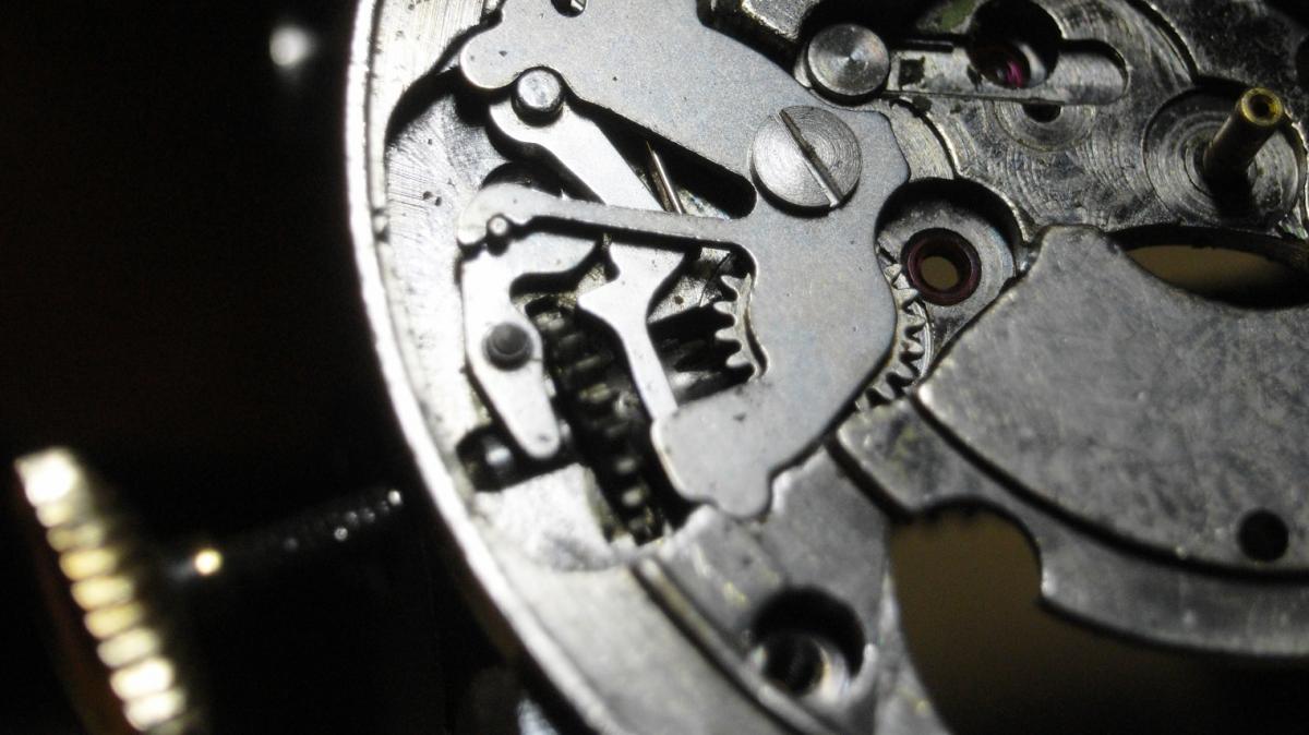

I have a Rotary Watch with an AS1802 Movement, and the movement will not come out of the case :(
This is the very first watch I've worked on ... so please be gentle.
It looks much the same as the Rotary Watch Mark did a full strip, clean and reassembly on. So I thought it would be a good movement to do as my very first: watching and completing each step along with Mark on the vid.
... but when Mark starts the video, the movement is already outside the case.  No problem I thought, I can handle this. So...
I removed the case back.
I removed the stem.
I removed the case screw from the movement.
All of which I found easy enough to do.
After these steps, I expecting perhaps a movement ring to remove, and then for the movement to fall out of the case onto the pad ... well there was no movement ring (that I can see) and the movement didn't fall out freely.
After I inspected it more, I thought, "Well it might come out from the front", so I removed the glass with a crystal lift, and removed the hands so they don't get damaged.
Then I tried to lightly push it out the front ... still no joy!!!
I can't see what on earth is holding this movement in the case ... I can spin the movement around freely inside the case; but it will not move either forwards or backwards from the case.
Any and all advise would be most appreciated.

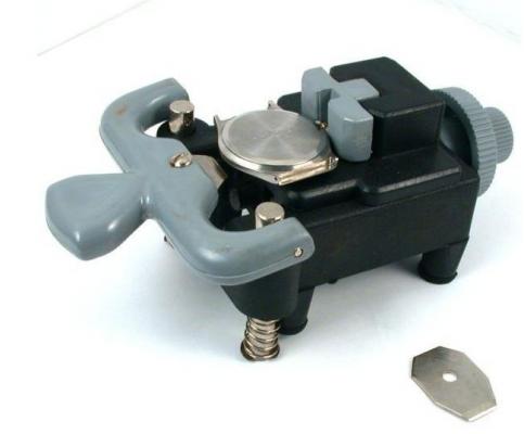

The movement will have to come out the front. If you look carefully you should see a very fine line between the ring/bezel that holds the glass. This is snap on and will have to be prised off with great care to prevent damage to the case. You would normally remove this bezel with the crystal still in place. This can be done with a back removal knife, but there is a special tool available that minimises the likely hood of damage. Once removed the movement should drop easily out of the case.
Edited by Geo
I'm with Geo here. I thought at first the triangular hole above the case screw might be some kind of pry point but, if the movement revolves freely then it's obviously not snapped in.
Edited by WillFly
Eureka!
The movement is out!
Thank you so much Geo and WillFly for the fast reply and excellent advise.

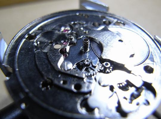

The poor old thing is filthy dirty though ... here's some pics before her bath. (as soon as I get my cleaning machine up and running I'll post pics of her clean and running)
For a 1st. attempt you have done very well,  I had destroyed several before I ever got one apart and then back together, so well done that man.  :thumbsu:
Ooh... love the slimy green bits!
Maybe it was worn on the set of "Who Framed Roger Rabbit"!

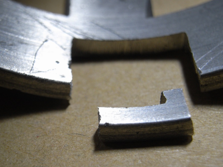

Unfortunately, when I unboxed it I discovered that the holder for the baskets was damaged, and one of the slots on the holder had broken off ... a little disappointing, but these things happen, and that's why items have a warranty.
BTW - These units come with 12 months full warranty.
So last night, I emailed Labanda, and sent photos of the damage, and explained this is how it came out of the box.
First thing today I got a phone call from Jeff, the owner of Labanda, apologizing for the inconvenience.  He offered me an Elma basket (which of course will fit on the unit, as it's a direct copy of an Elma), shipped overnight to my door, to use, until they can arrange a replacement basket from Janta.

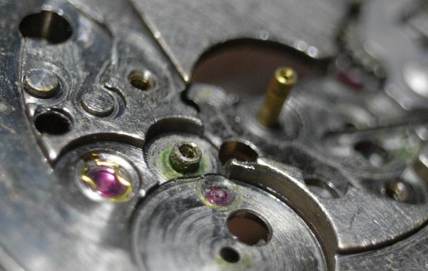

If you remember in the earlier posts the base plate was horrid, with green, slimy, dried up grease on the posts, and heavy dirt build-up everywhere else.
This watch was BADLY in need of a service!
Firstly, I soaked the base plate in some Zippo Fluid (thanks for the tip Geo), and then gently bushed around the posts.  I also used a fine point to dislodge some of the real hardened deposits around the posts for the keyless work, and then rinsed-and-repeated the lighter fluid and bushing.
This is what I ended up with in the bottom of the bowl.
... so how does it look now, after manually cleaning and then a cycle through the cleaning machine?
Not bad at all!!
I got out the 10x loupe again and checked all the jewel holes and bearing surfaces ... absolutely spotless!!
