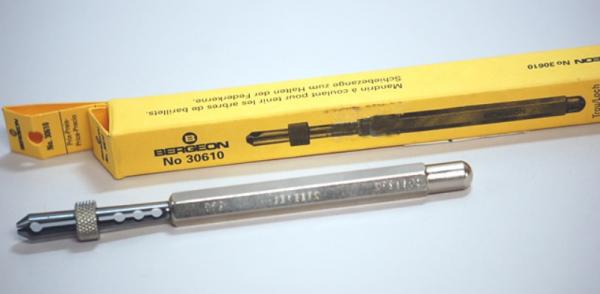

After a LOT of research and reading, here's what I've found Bob ... and you are going to love it.
I saw a post with these three pics .... it's THE TOOLS for the Seiko Diashock and Trishock System!!!  Yeah baby!!
Only problem was he didn't/wouldn't say what they were.  And so the hunt begins...
Remember I've been in the IT industry for 22yrs, and have a few tricks in my bag.  So I enhanced the photo, inverted the colours, and altered the YGB of the photo of the complete tool, so that I could read the markings on the side of the holder.
It reads:
"2.00 Bergeon 30610"
It's a 2mm Bergeon Barrel Arbor Holder
Here's the picture of the boxed product
And the cheapest place to buy it is here, that I've found so far:
http://watchmakingblog.com/opencart/upload/index.php?route=product/product&product_id=475

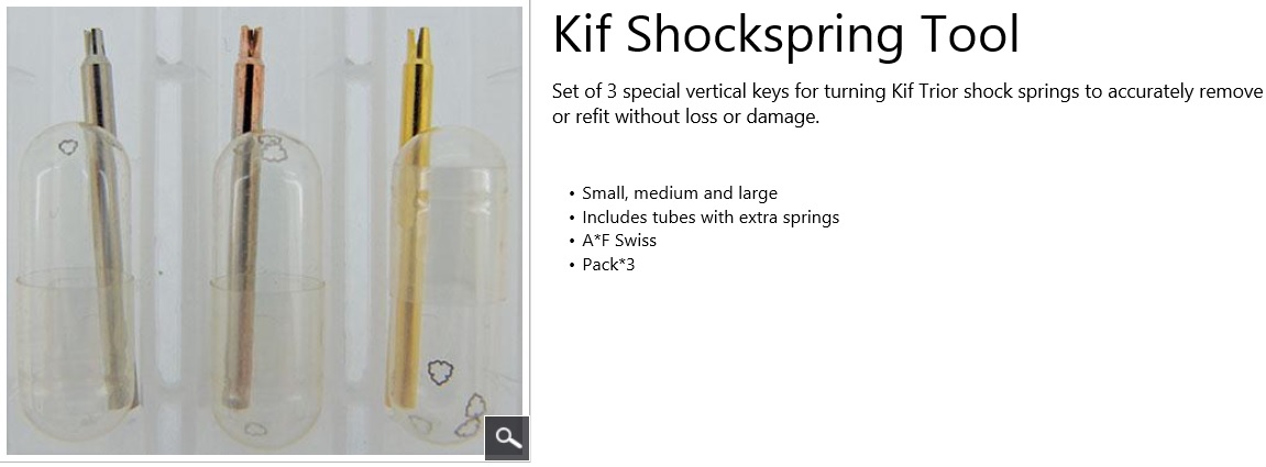

Until I came across this article ... but all it says is to file a piece of pegwood to shape  ... Arghhhhh!
BUT ... instead of Diashock or Trishock, it said KIF
BINGO!  That was the nugget I needed for a search term ... and Booya!
Buy them at Cousins in the UK
https://www.cousinsuk.com/catalog/tools/jewelling-tools-for-bergeon-kif-inca-seitz/kif-shockspring-tool
... Annnnnnnd my work here is done B)
