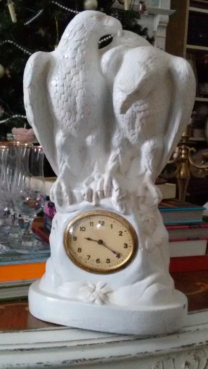

A couple of years ago a very old lady living next to us ( she was 90) and with whom I was befriended and took care for together with my wife (relatives basically abandoned her to live alone in that flat, bit she was almost self sufficient) passed away after a couple of weeks in the hospital, but before she was gone, she presented me with her clock, a 2 eagles wooden clock signed by a C.Amadei that needed some love, just like her.

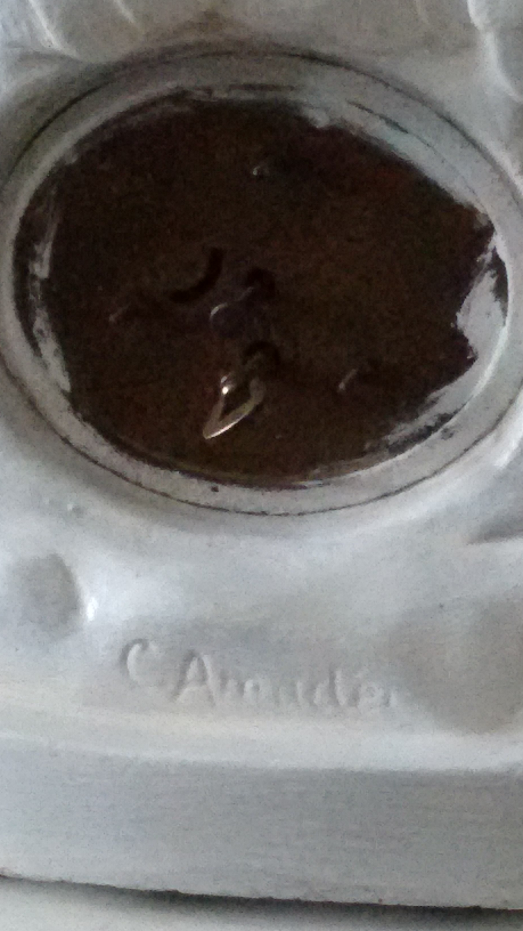

I have never heard of C.Amadei but I expect its who made the case. From what I can see at the back the movement is a 30 hour movement with a balance wheel it might be 8day but I doubt it, the type of movement you would expect to find in a case typical clock insertion movement. I don't now if this type of movement is made today, back in the 70's and 80's you could buy replacement movements to fit for a few pounds it even included dial, hands and back plate. To remove the moment, undo the key and pull the hand set off, undo the nuts and pull the movement out. The pallets will be of the pin type. This is the type of movement I would start an apprentice with, simple and easy to understand. Sorry you don't have a Thomas Tompion.:D

The carving on the case looks really nice. Could it be French or Austrian with those eagles. Looks Frenchy to me ?
