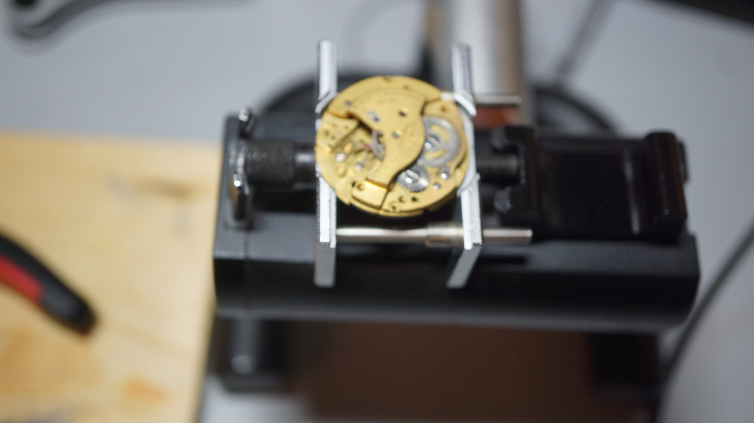

I always put the movement in the movement holder when i put it in the timegrapher? Never directly on the timing machine. And if i have it mounted in the case i make sure the crown is against the fixed mount? Seams to work better that way.
Make sure that the hairspring don't touch the balance cook? it could be very tricky to set the height of the hairspring stud? And that the endcaps are right way up?
Have you checked if it could  magnetic. Had problem this week with a magnetic balance cook or hairspring on a Omega 610 . Every time i turned it dial down it suck the hairspring to the balance cook? Making it run very strange.

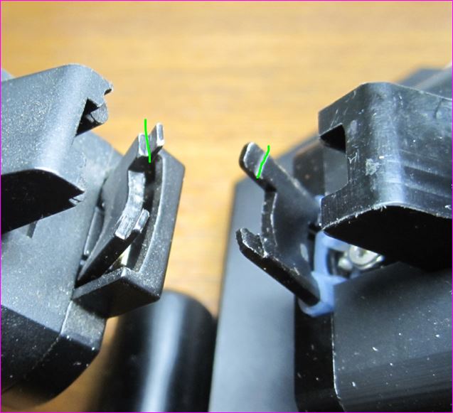

I usually prefer to put the movement directly on the holder of the timegrapher as it gets a better contact for me. If you using a movement holder just make sure you making good physical contact with the metal pins that pick up the sound. Occasionally with movement holders you can hold it in such a way that you do not get a good contact.
Then for magnetism I once did a comparison of the Chinese 1000 timegrapher versus a Swiss timing machine. The person who loaned me his timing machine also gave me his watches that he had concern over. So the various watches were placed on the timing machine then both microphones simultaneously were holding on to the watch. Images attached of before and after for the effect of magnetism. Normally in watch repair you wouldn't see this because you always are using a demagnetiser to solve that problem.
3 hours ago, richard said:
cannon pinion on the spring
I saw this and was pondering what you are trying to tell me then with the discussion of holding it dawns on may you do need to hold the watch correctly in the holder. I'm attaching some images of holding watches. If it's a case stopwatch you can place it on the bottom of the microphone just be careful sometimes pocket watches might have a habit of popping out especially when you rotate the microphone around.  So you notice in the image showing a comparison of both microphones there's a little edge at the top of the pins that you can Place the main plate of the watch on. Usually the main plate is nice shape around square whatever it will fit the notches. This way you'll get maximum pick up into the microphone. Which is not picking up the audio Sound it's picking up the vibration. Then if the watch is held properly can rotate it upside down but usually on the Hamilton deck watch like this I have my hand under it this is a really heavy watch. The Chinese microphones will not open up big enough to hold one of these. Then even if it could the killer spring would be bad the Swiss machine has a constant force across its entire opening But this was machine costs sizable quantity more than the Chinese machine is very functional.
