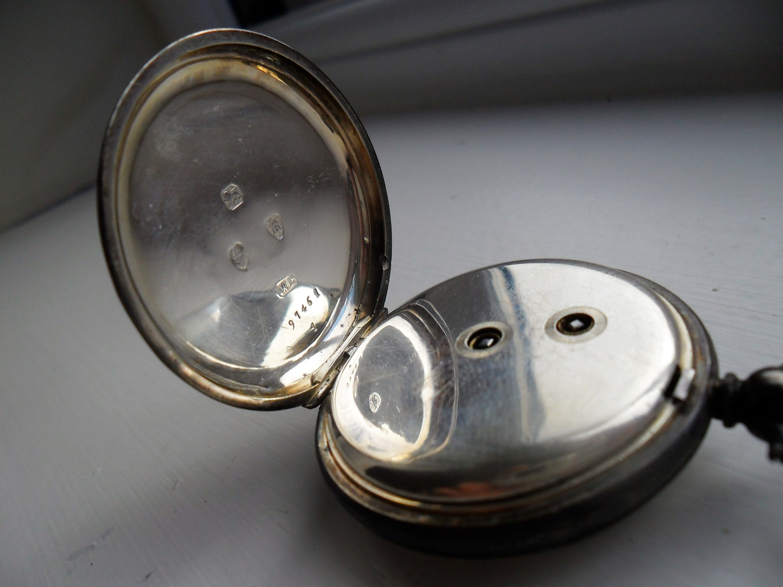

I have picked up a small bag of pocket watches - small ones, case diameter 40mm - assumed ladies or boys?
Anyway, my query.  The hallmarks are confusing and I've little help from my favourite website.

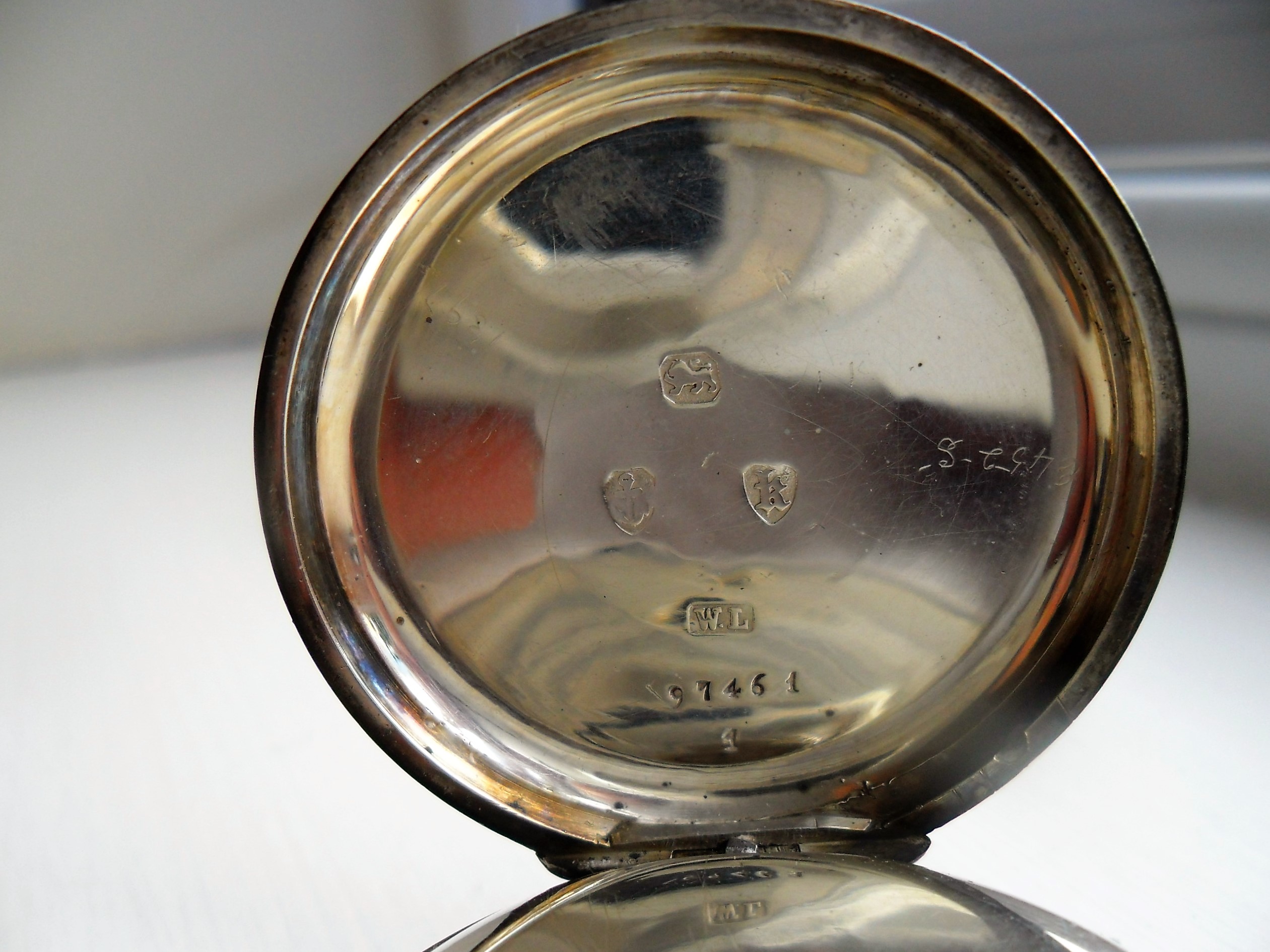

The Maker's mark is W.L (In a rectangle) and this, coupled with the Anchor mark and maker this a "William Lock & Co" watch, dated between 1881 and 1893 ("the mark 'W.L in a rectangle' was registered in October 1881. He changed the sponsor's mark to the W.L & Co initials in July 1893").  The "Lion Passant" is no help, just denoting sterling silver, sometime after 1820.
All straightforward enough.  Now onto the Date Mark: it is a "k" and of a font that means 1865 OR 1925, with neither date fitting when lock used W.L.
What's the date of this watch?

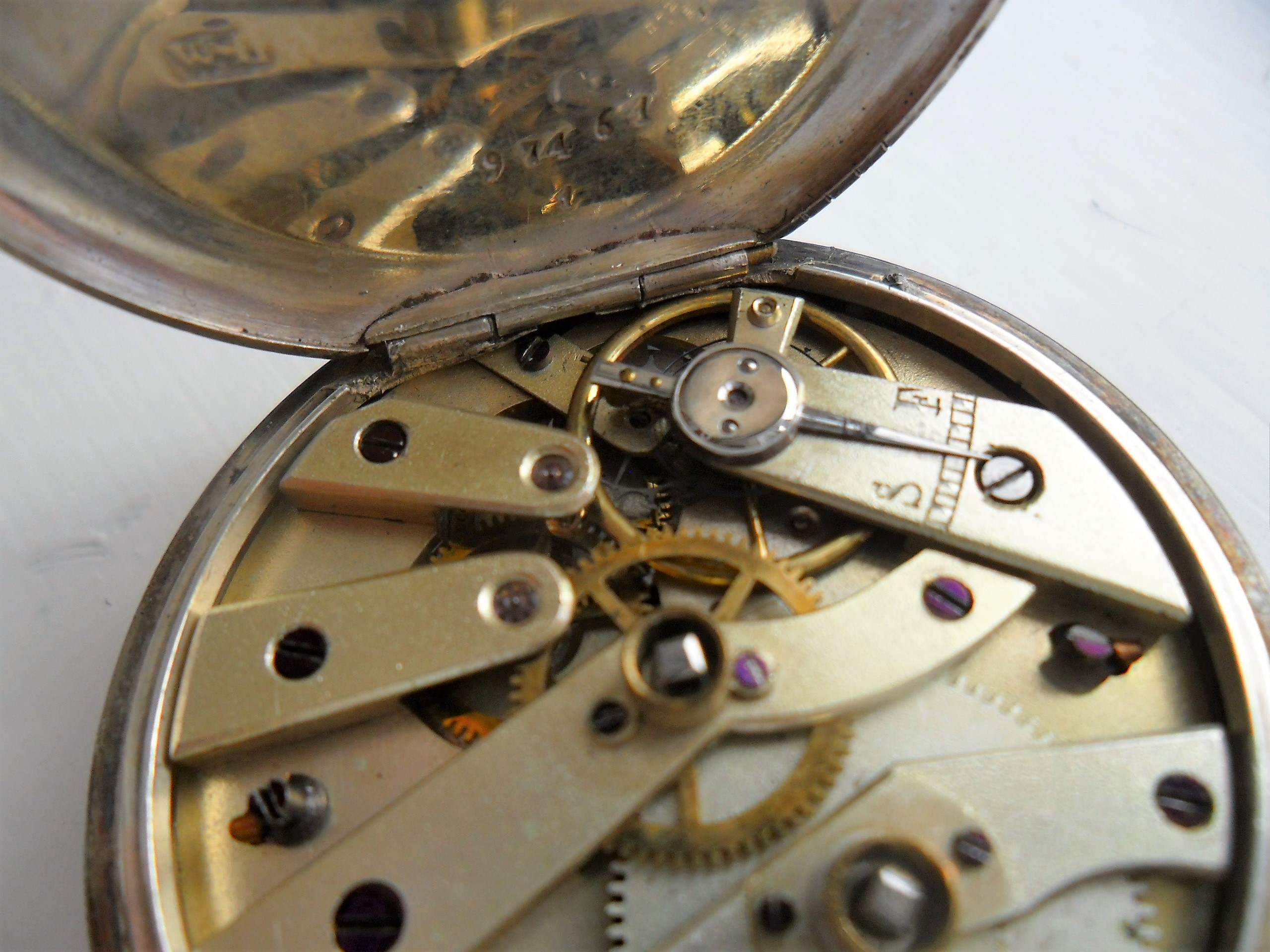

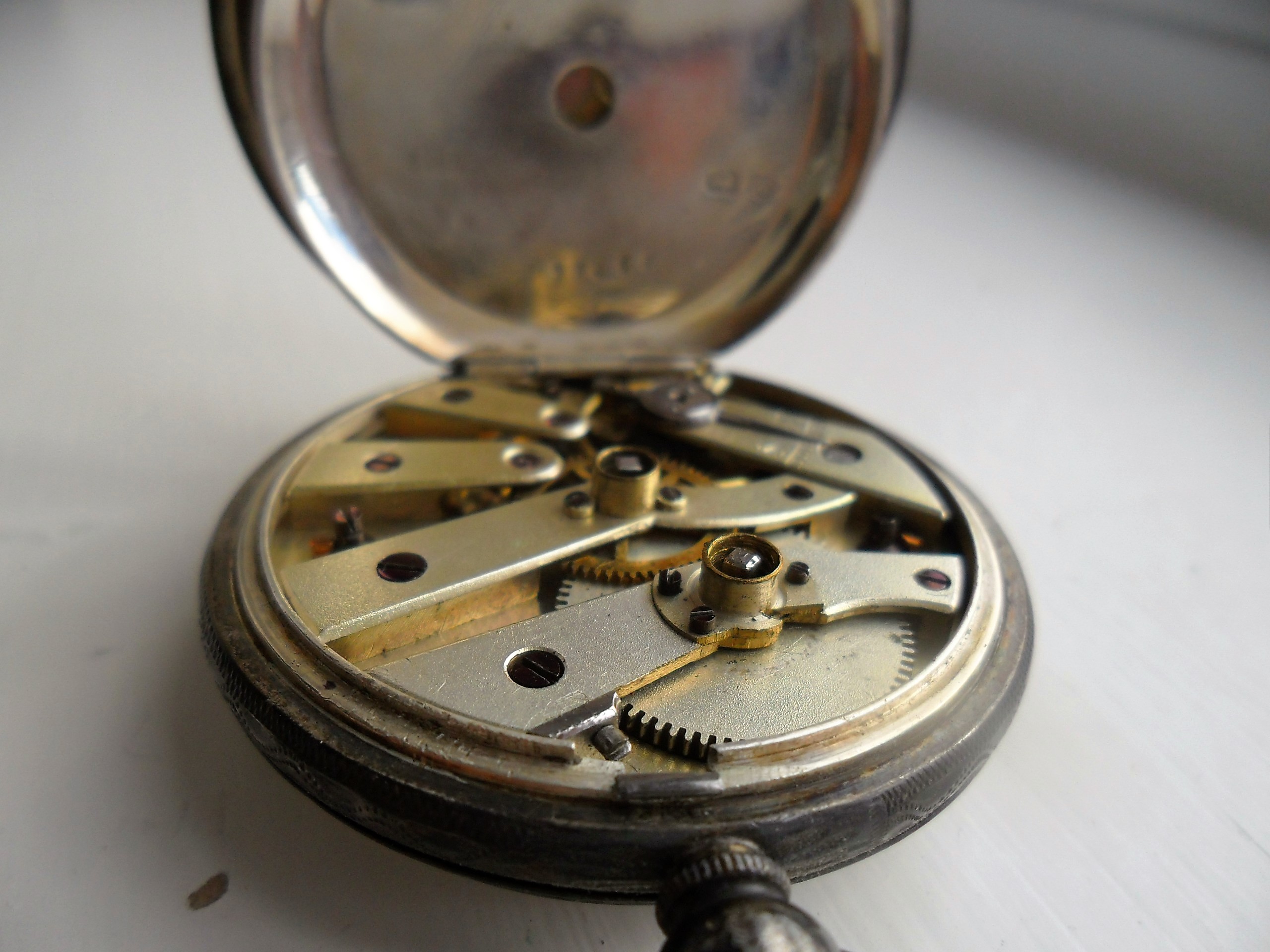

Another question.  I cannot find the mechanism in almighty Google (other search engines are available).  What am I looking at, please?
I believe though i could be wrong the case maker is either Walter Lunt or Walter Low, the date letter i think is 1833-34.
The movement may have a makers marking under one of those bridges or even the dial side. Ive often not seen the mark until it is disassembled , or it could be unmarked. The old ones are tricky to identify but someone else may know more than i :)

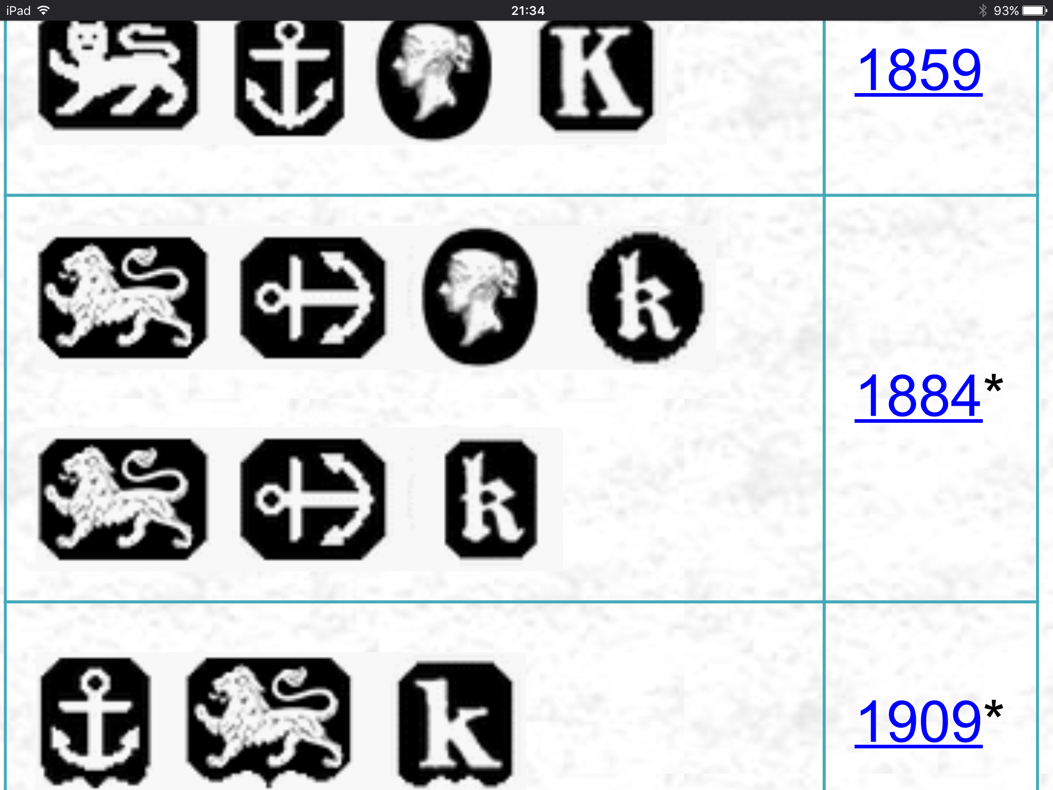

Don't Worry!  Thanks to my father's "Bradbury's" I can see what I never realised (oops); each assay office could have its own dating marks!  Was effectively using London Marks against Brum dates!
Thank you all!  1884 - not bad for the price of a 4-pack!
The movement is called a 5 bar movement with a cylinder escapement (no pallets) it has back key wind and back hand change. It is more than likely to be from the 1800 hundreds, It's a ladies watch. Some have exceptionally decorated enameled dials.
Thank you OldHippy, that's remarkably informative yet concise!
