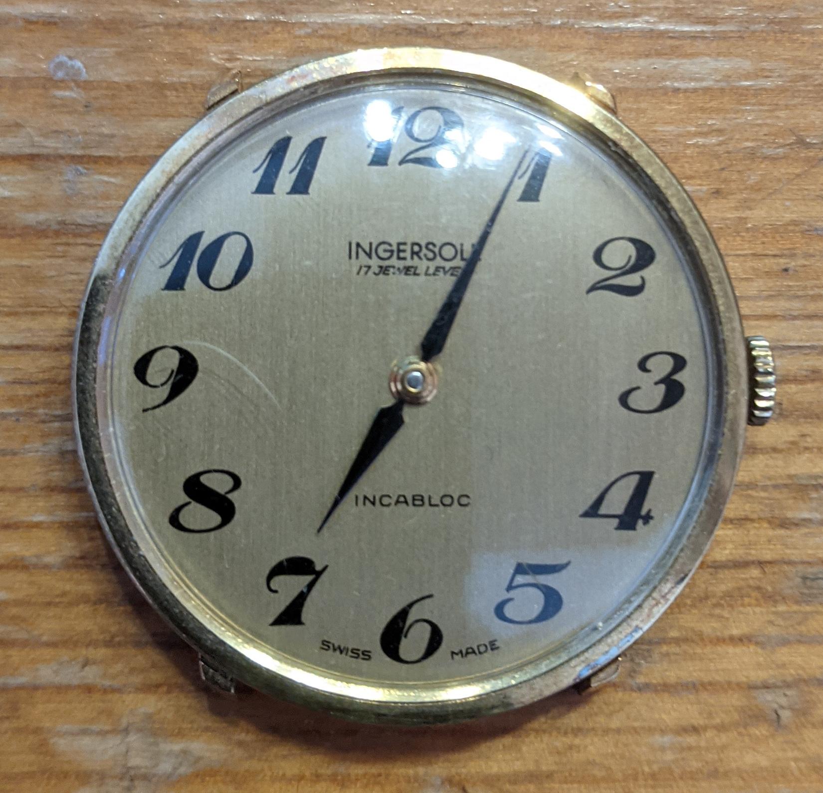

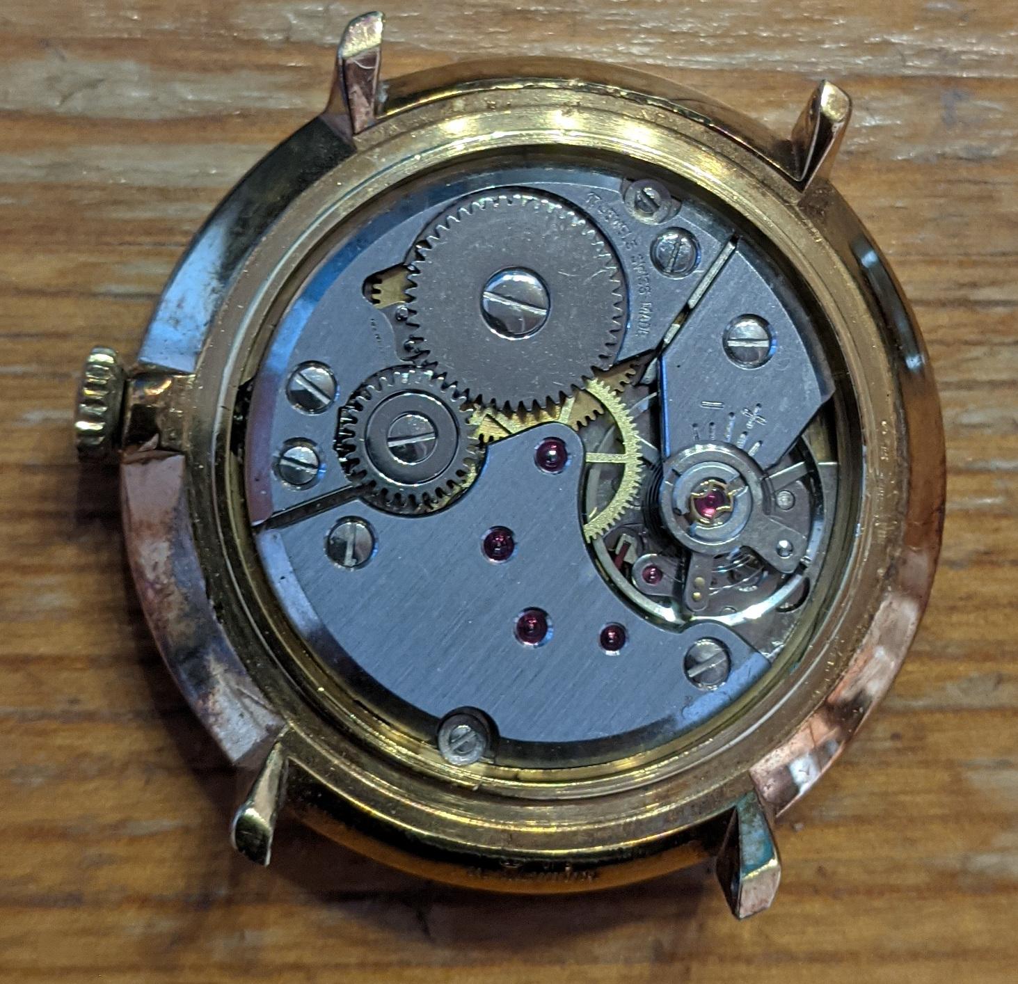

It’s done and the movement feats/aligns perfectly in the case. I stripped off 10mm wide sandpaper and wrapped /sticked it around the pad with double sided tape. I run with 400 grit and finished with 1000 grit. Now I can continue with my build, I’m going to buy a dial and hands. The dial I am considering is a larger diameter 36.5mm than the allotted space 35mm in the case, so I will apply the same ‘technique’ with sandpaper and Dremel/drill. Thank you @RichardHarris123, @AndyGSi and watchrepairtalk community for your help.
