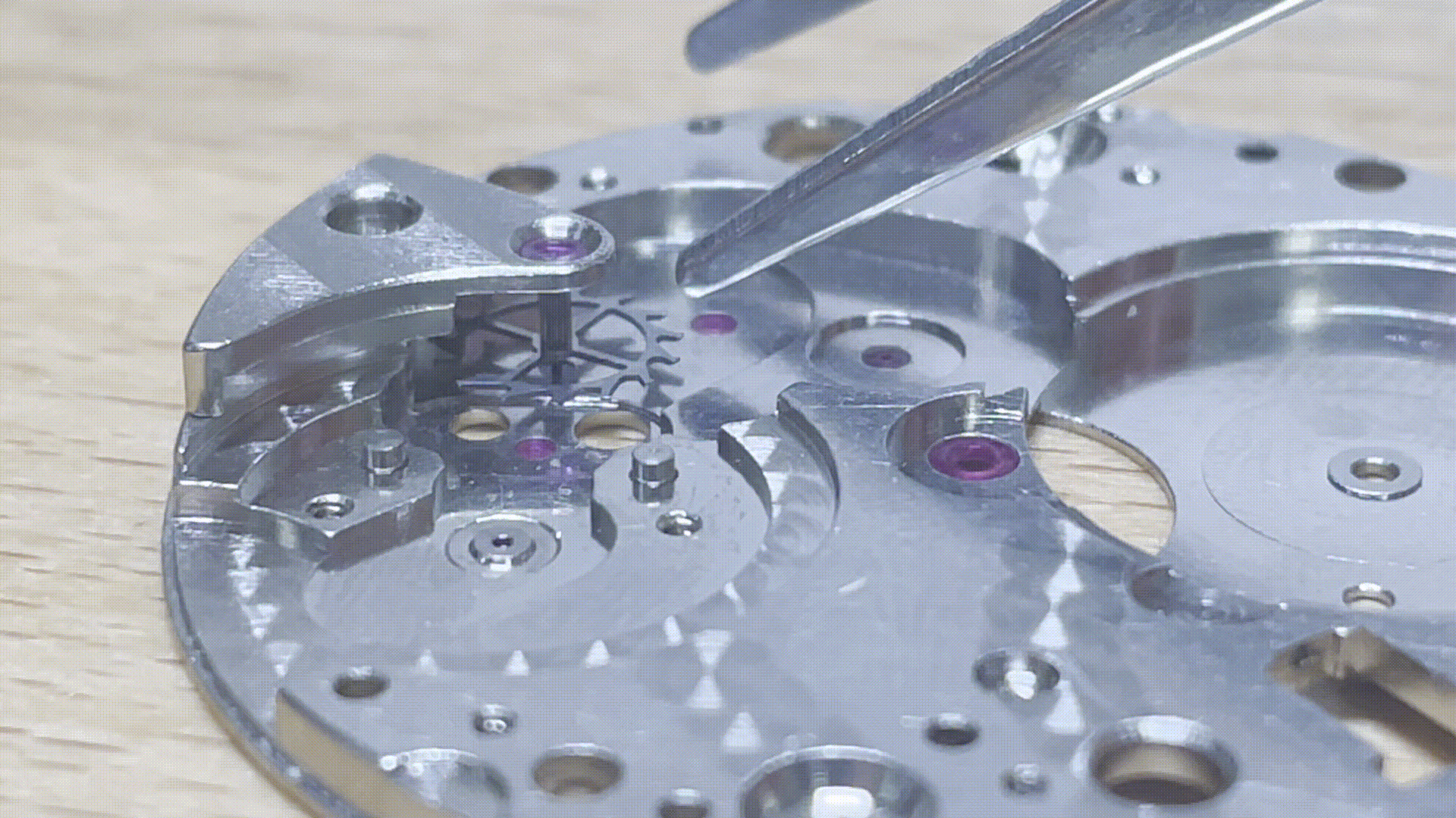

I am really new to this hobby, yesterday I managed to disassemble and reassemble my first movement, a Seagul S36.
Today I tried again but I'm stuck at the beginning, as my escape wheel continues moving too much on its pivots. The pivots does not look broken to me, I would love to post a photo/video but I can't find the function in this post.
I don't know whether I should try harder (I will) or I need a repair part.
Any help would be really appreciated.
Thank you in advance.
Andrea

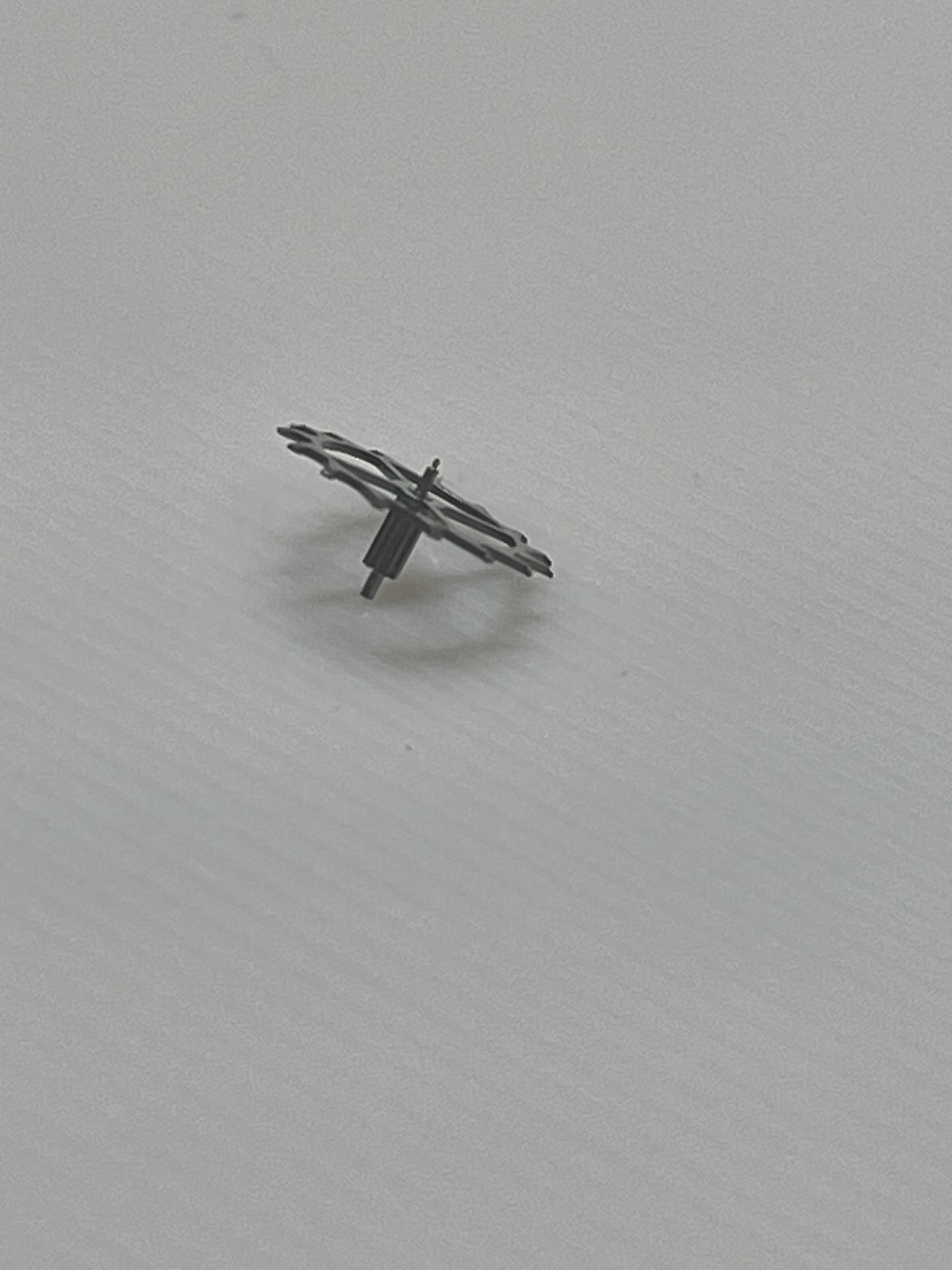

I managed to post a photo and creating a GIF. It looks like the pivot is short and can't properly stay in place under the bridge.
Any suggestion?
Thank you 🙂
Andrea

I am really curious about how you understand that the pivot is broken. It should be longer on one side? may the bridge be compromised too?
Where should I find the spare part? Is the escaping wheel a standard wheel (I immagine not)?

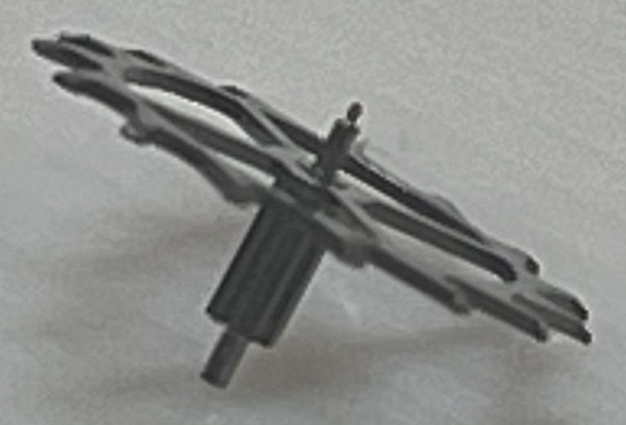

The top pivot is broken Andrea. What is the tool that you are using in your video Andrea ?  What parts are delicate
Got it, I will find a spare part!

The pivot at the bottom of your photo (top pivot on the movement) should look the same as the other end.
Is it a Seagull ST36 or some other Chinese copy?
It might be a copy, this is the Amazon link of the movement I bought https://amzn.eu/d/axOGzF5
You see that little nub (pivot) on the bottom of your escape wheel? There should be a corresponding one on the other side. If you look closely at the jewels in your mainplate and on the escape wheel cock, you'll see they have tiny holes in them. The pivots go into those holes.
Try to figure out why your pivot broke so you can learn what went wrong. Everyone breaks a pivot from time to time! Luckily, as your skills improve, it becomes more and more unlikely.
I suggest you take a look at this: https://watchrepairtutorials.com/how-to-install-a-train-bridge-without-breaking-the-pivots/ Pay close attention to the video at 5:29 seconds where you can see the top pivot that you're missing.

I see, that's interesting! To be honest with myself, I remember the moment I heard a wrong noise...
I will buy a replacement, look at more videos, and then try again

I think all you can do is get an Escape Wheel for an ST36 and see how it compares when you get it.
Ordered! it will take one or two weeks to arrive 😞 In the meantime I study and watch more videos!
