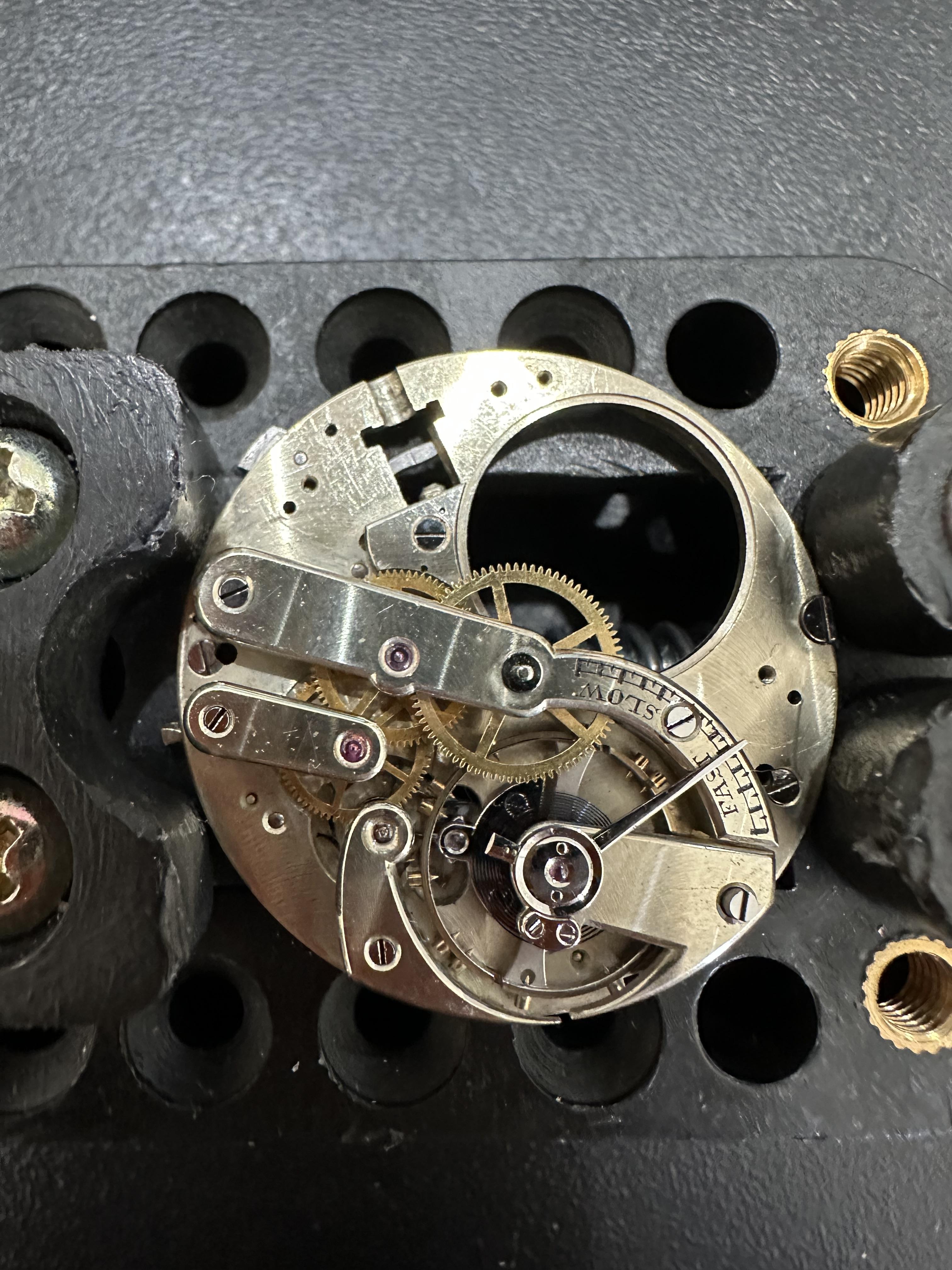

    • All consistent with my thinking! Makes good sense.  The lower jewels aren’t cracked. However, it’s possible that when I oiled them I didn’t seat them firmly enough. I’ll double check that.  If that balance staff is too short, that would explain a whole lot. But I don’t have a micrometer to measure. Then if it is too short, I’d have to buy an NOS one (presumably different from the 2802 I bought previously). Then we’re back close to the beginning of this discussion. 😂

    • Thank you very much for this. Re: 1. I've so far found that this one needs something thicker than 2x kitchen foil (another suggestion in that thread)! 2. I've been checking where the roller needs to be in relation to the wheel, the hairspring stud/arm & the pallet fork to try to get it right first time. 3. Does one raise notches at both ends of the tube? 4. What is a "driver roller sharpener"?
