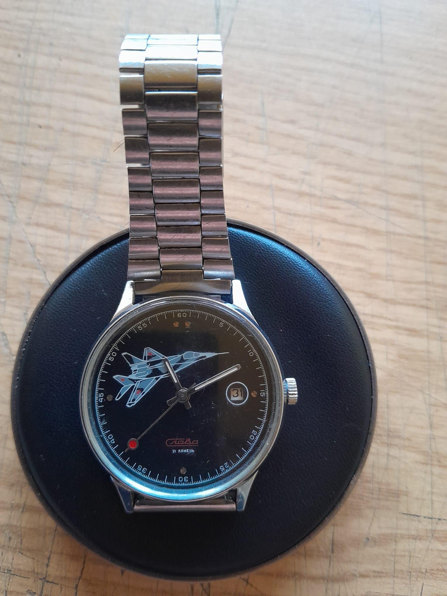

My request concerns a Slava 2414 russian movement.
It fell down a long time ago, breaking both clamp screws.
Now that I have fallen in the "watch repair" craze, I am trying to buy replacement screws, but was not able so far to find them.
I purchased clamp screws for a 2428 movement from Cousins UK (thinking that 2414 & 2428 movements were sharing the same base), but they proved too large.
Does someone know a source (or at least the size I should search) ? See photo of broken screws (in non-Imperial measure, sorry, posting from France).

When it comes to replacement screws, we usually get a few lots of assorted screws, either from Cousins or eBay. If you are lucky, you'll find an exact match, if not, a similar thread but different head design or length.
Sometimes I modify screws by rethreading a close match and reshaping the head and screw length. So far I've not made a screw from scratch yet but that's another possibility.

Hi Colchibani.
Due to the low price of this Slava watches, what I would do is to buy a donor. You can find them quite cheap and, well, maybe if you need a functional balance or a mainspring it's not the best idea, but for those screws I guess you can get them from a donor.

Thanks MariusJacob.
It's an option I will consider if the screw size prove to be non-standard.
Currently, I am planning to first purchase a digital caliper to precisely measure them. Head diameter is 2 mm, length 2mm as well, but my old caliper is too worn for the thread diameter. It may be 0.9 or 1.0 mm.
