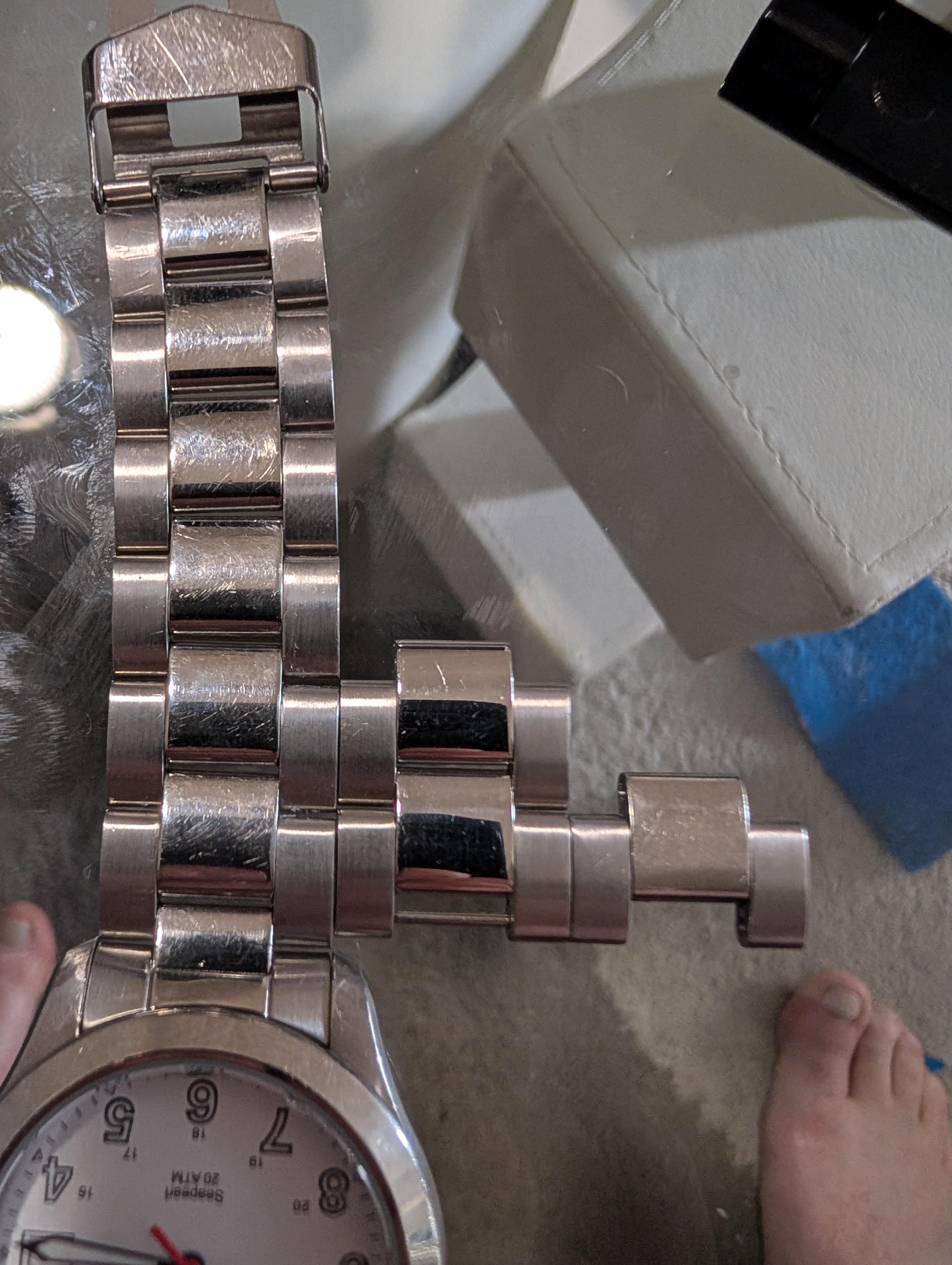

Decided to give the case and bracelet a good cleaning and my first shot at polishing/brushing. Went with the Cape Cod polishing cloth and gray scotch brite method.
Before First;
Then After;
Then comparing to some original links from when the watch was new to now.
