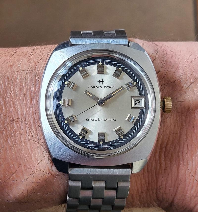

Hello,
I have installed a new battery and it does receive power. I can set the time BUT the hands will not move on their own; it doesn’t tick. I can see the seconds hand trying but it’s just not going. Any thoughts? Where would I apply oil or lighter fluid? I am not too familiar with electric movements but have worked on a few automatics and manuals. Thank you all in advance!
is not really a Hamilton electric it was only sold by Hamilton it's really a Swiss watch.
then more than likely it's never been serviced so it needs to be serviced. That means it has to be completely disassembled cleaned etc. I'm attaching the service manual.

Wow. Thank so much!
5 hours ago, nevenbekriev said:
What exactly means 'it receives power'? How do You understand that it receives power? Does the balance oscillate?
Yes the balance oscillates. I can also see the second hand bouncing around ever so slightly when I push in the crown.

It's hard to tell from that photo but the balance jewel setting looks mangled. Also, the photo shows the movement in the hand setting position which should stop the movement, although it doesn't look like the stop lever is hitting the stop pin. But just to dot the I's and cross the T's, did you try pushing the crown back in?
I finished up one of these (9154) earlier this month and am wearing it now.

If the balance oscillates (and the amplitude is good) and the train is not moving, this means some problem with the transmission of the balance movement to the train. I don't know this particular movement, the ones I have worked on are made with pallet fork and "escape wheel" which look like ones in mechanical movements, but actually act in reverse. There is an index wheel and ratchet for the escape wheel that need adjustment there. Of course, it is possible the train to be blocked somehow, but it will be not letting the balance to oscillate free.
!!!Do not try to demagnetize this movement!!! Do not try to remove the balance, as the coils have to be removed first.

 The hand trying to move, indicates gear train is not blocked.  As neven said, escapement on this works in reverse, in other word power is transfered from
fork to the escape wheel, that is escape wheel controls energy  escape , your watch  rather  intakes energy from the fork and transfer it to the escape wheel .
No one suspect is escape wheel not turning, either it doesn't want to move due to dried oil ( probability 15%) , OR is doesn't recieve energy to move ( probability 85%) .
I just made up these probability figures, so by micor-strech of imagination shouldn't hold me responsible.
Who knows ? 😅

It is electromechanical movement and the balance is completely different. It consist of two wheels/layers of magnets and the coil is situated between them. In order to remove the balance, first the coil must be removed. There are 2 screws that hold the coil and they must be removed, then the coil pulled  to side (the movement out of the case) but carefully as not to touch and rub on the magnets as the coil wire is so thin and fragile that it is a miracle that has survived till today.
