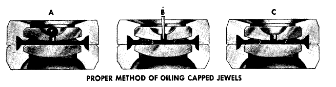

…that sure sounds nice Jon yet I’m two for two single owner Rollies ‘professionally’ serviced with that little gear missing teeth. I found the teeth in one and on the second the tooth is missing. Here’s a third from watchie. We could be the only ones but I’m not buying it… If it were someone else here I’d be confused how they would be confused. 🧐 It’s a valid comparison. They all offer recommendations on how to service movements including order of assembly, lubrication- how much and where, etc., they sometimes differ and sometimes manufacturer advice is just weird… …also, these designers are the same people that brought us this… …the defense rests.
