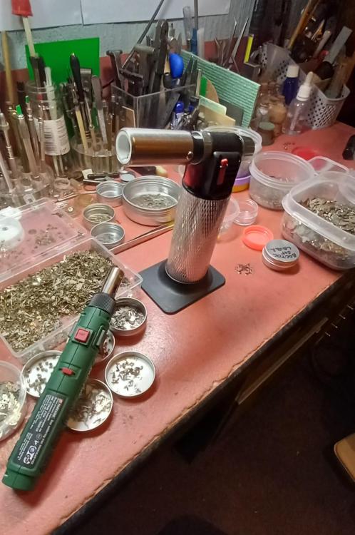

@Neverenoughwatches where do you source Bismuth low melt solder paste? Do you use a small kitchen torch or one designed for the job?

So any soldering need to have a clean surface to bond properly.  Use wirewool or fine wet and dry on the dial where the joint is to be had. Add a small amount of flux...for belt and braces I use a self cleaning flux as well. For the torch I use a small gas powered soldering iron , a creme brulee torch might be overkill, you might even get away with a lighter ?  This is the bismuth paste I use, just cheap bought off the net. I've had mine kept in the fridge for three years, just tried it and its still soft like it was when I bought it.
