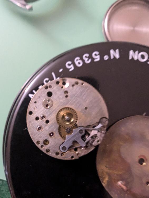

I am working on this surena but i have not been able to identify the movement, which is a pity as some teeth of the ratchet wheel are broken and i would like to change it. Do you have any idea?
On another hand, i am unable to remove the ratchet and crown wheels. The screws seem totally stuck. Have you any ideas?

when asking for help for dedication of a movement it's helpful to give us a size that is measured on the dial side and not in millimeters. I'm attaching a chart you need to be in lignes as that's what all the watch references use.
On 8/28/2024 at 12:30 PM, frog54 said:
22mm
so looking at the chart we find that is an odd size which is a problem. but I guess that makes it close to 9 3/4 a starting point. Less things for me to look at.
as you're discovering finding a mystery watch can be a bit of a challenge. The Swiss and I don't know if others countries or watch companies did this but the Swiss came up with a interesting system of fingerprinting a watch basically. As the plates can change typically the setting components do not. So have what they basically call a fingerprint system which is why we need a clear picture of setting components. But your one component is unique enough I can work with that. The size is needed because they're listed by size and if we don't have a size it increases how many somebody has to look at or perhaps not look out at all because there's too many to look at or we might miss one because were trying to go through too many
then in order for the fingerprint system to work watch has to exist. What I mean by that is whoever made the movement had to make sufficient quantity that parts were available. The somebody took the time to record the setting components for identification for finding parts. The problem with watches there a lot of watches that there is no identification at all and there's no fingerprint system that works because nobody cared about the spare parts at all.
then if you have the physical bestfit book the fingerprint system works a lot easier because the setting components will actually fit on top of the pictures. Then a course in the absence of having the physical watch we need a good picture so I've rotated it so it matches what I'm looking at the bestfit book it makes it a lot easier when I'm trying to find something. How and I didn't just look at the bestfit book I looked at several other books and no I can't find it at all. On the other hand I might've been tired and missed it as I was suspicious of the size measurement and had to expand my search considerably.
fortunately the one visible setting component is very visually unique which does make looking to the books easy except as I said it doesn't seem to exist?

FHF is Fabrique d'Horlogerie Fontainemelon with the H being the centre part of their logo.
After a second look through Bestfit I'm fairly confident that it's a Beguelin movement but with limited
details on them and these only shown as 10 1/2 or 11 1/2 lignes I've been unable to get any further.

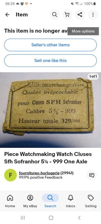

5 hours ago, AndyGSi said:
Found this but still no more details on SFH
https://www.ebay.com/itm/264406264200
That looks like a match Andy.  I name Professor Plum the murderer 🤣
