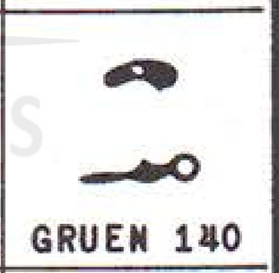

  On 8/18/2024 at 6:53 AM, Neverenoughwatches said:
Here is the keyless match, there doesn't look to be anything else like it, as simple or any interchangability
Expand
There is always the other method it's a bit problematic though. If we had the proper measurements of the stem we can see what matches that.
  On 8/18/2024 at 10:21 AM, JohnR725 said:
I think somewhere on the other page was hinted that may be perhaps there were more pictures in a discussion somewhere else on the message board that I couldn't actually find. I think oftentimes people fail to grasp how big the message board is and if they left other discussion somewhere in the universe they should give us a link.
Expand
I forget that sometimes, if we're lucky we have a stem to measure up, and maybe some dimensions that could be taken from the staff with the collet and roller removed.

My apologies: I hadn't worked out how to provide a link to the forum on which I initally requested help in identifying this wristlet (as I've learned it is) & thought the topic wording would allow it to be found via Search. However, I've now got the link (I think): https://www.watchrepairtalk.com/topic/30287-any-ideas/#comment-257492
Thanks again to colleagues' for your interest in this issue.
Expand
Although the wristlet has been retrieved by its owner I have kept the (damaged) balance so, under your guidance, I will attempt to provide the relevant measurements....
