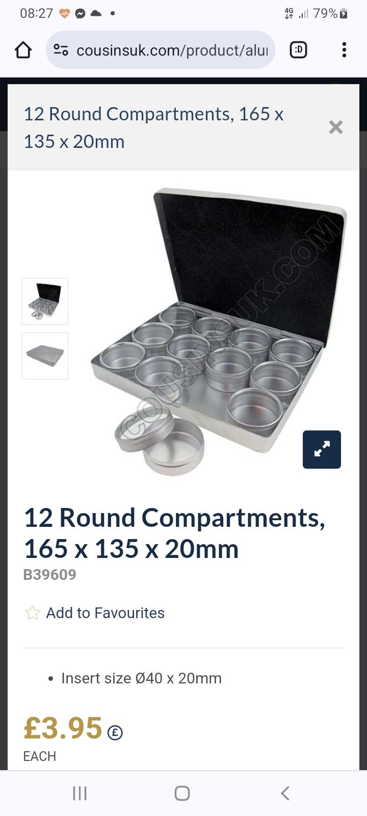

Another little idea , for a movement cushion this time. Always made my own cushions but i like this one it has built in features. The pot is from cousins , add lead circles for weight , light cushions move far too easy for my liking, a foam mat cushion, yoga mats and those click together floor mats are about the right density punch out the center. The lid acts as a dust protector when you want a coffee break, saves on those glass movement covers.

I saw those  great idea scott,  i like the meds gel caps for storing small stuff although the big ones have good volume for wheels etc, extremely cheap 1000 for around 15 quid, enough to last most of us a lifetime and they've been used for decades so a proven storage idea. These with a lid on as well if you want to pop a member something in the post and not be damaged.

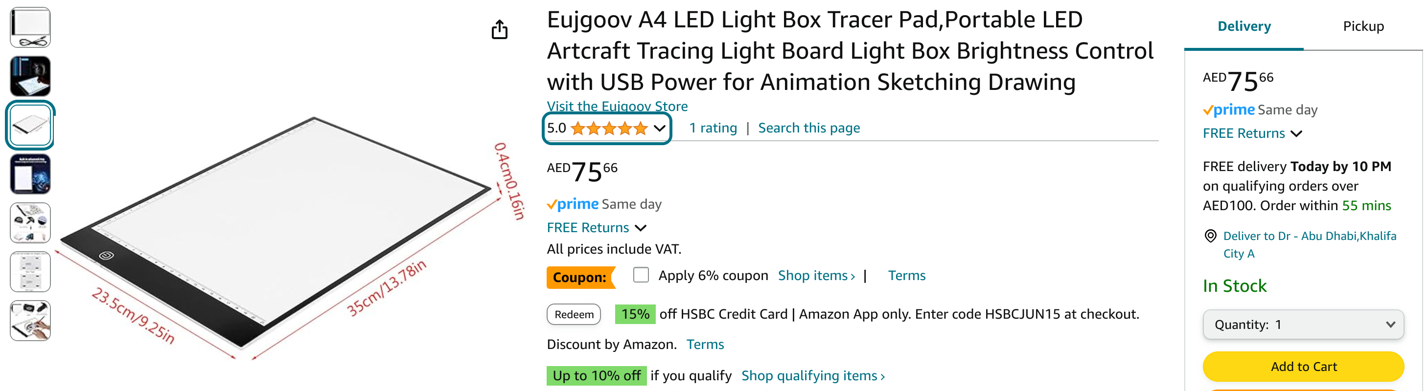

I got this a while ago too for finding cracked jewels, beats trying to balance the main-plate on top of a torch/phone and focus your scope at the same time. Just put this on the desk top, turn your room/scope lights off, place your main-plate on it and turn it on (powered by USB cable). You then have hands free experience to focus/zoom your scope and poke the plate around to search fro those cracks.
There are smaller cheaper version out there (this one is +/- A4), but this was on half price when i got it so couldn't resist a bargain!

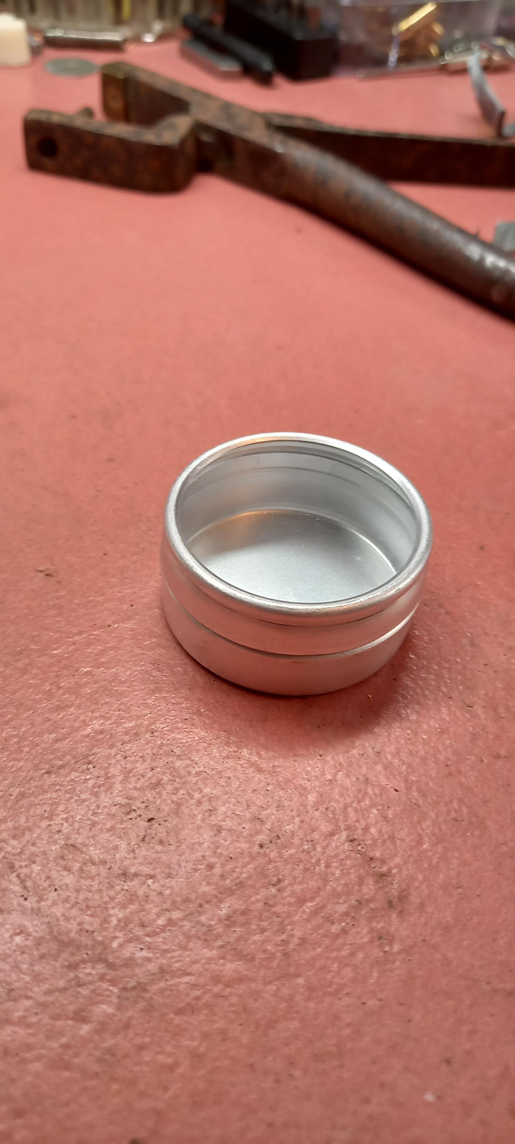

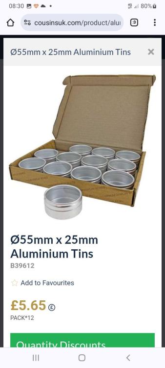

I use those aluminum tins with glass lids from Cousins as organizers while I'm cleaning movements. As I tear it down, I put the various "systems" each in their own little tin. Wash them one or a few at a time, and then put them back in the tins. Then assemble from the tins by system. Keeping the parts in there keeps the parts clean, and keeps me organized. Especially useful with a curious 4yo and a -3 day old en route. I can't remember the last time I was able to sit down long enough to tackle an entire movement in a sitting without some sort of major interruption!
They look ok to me, i checked them out ages ago and thought about buying them. How about an icecube tray lots of compartments they just need some kind of lid.
