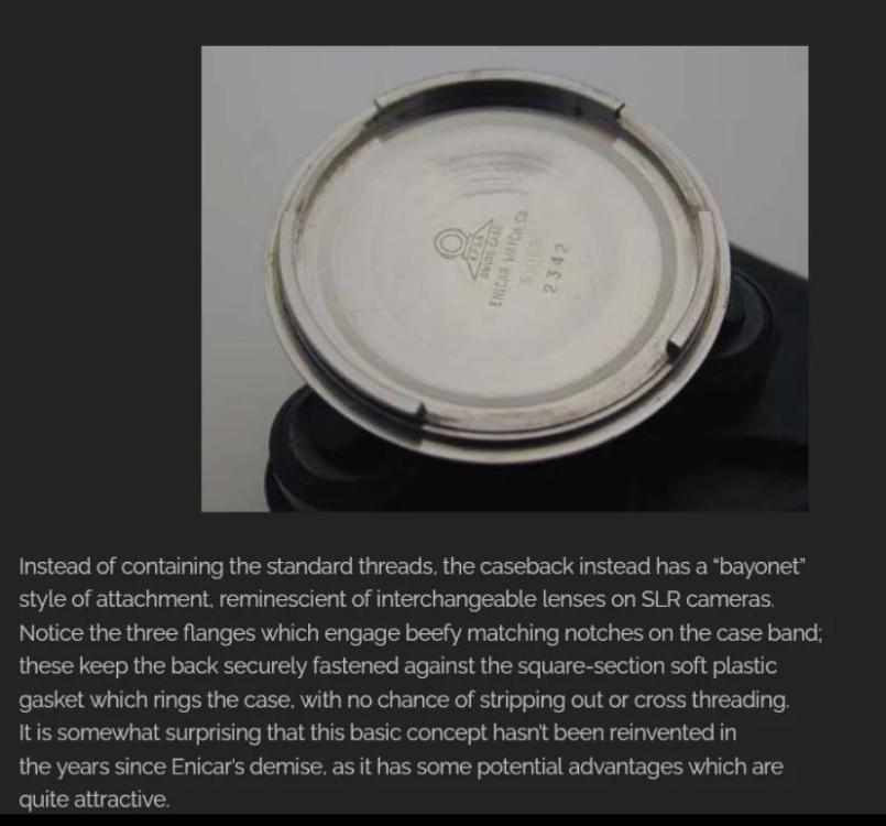

I saw some threads mentioning “bayonet” and “cam lock” case backs for other watches, but it’s difficult to figure out if this watch uses those systems without being able to open it. The link below and the attached image mention the “cam lock”
