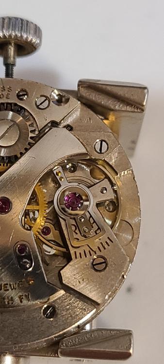

I'm working on an AS1194, and after reassembly, amplitude and beat error both look good. It's about +120 s/d though.  I can only get it to about 60 s/d by maxing the adjustment.  I've looked closely at the hairspring, and I don't see anywhere that it's touching itself or any other parts of the movement.
I do notice that the tail end, where it's attached to the balance cock, it extends past.  You can't see it in this picture, but instead of a nice taper pin, it also looks like a wire is bent in place to hold it.
Is it possible someone shortened the spring by reattaching it?  If so, I have to assume someone before me fixed the beat error.

One of the problems with anything resembling older watches is people not always doing things correctly. So yes there is a possibility that somebody shortened the hairspring which is why you're going fast and perhaps they even did that to fix the beat error which would not be the correct way to do it.
Sometimes on some vintage watches there can be a little bit of hairspring stuck through the stud but that's usually more vintage. In any case if the stud pinned hairspring doesn't look right it probably isn't right. So underpinning giving a length will slow the watch down and then you'll have to rotate the collet to adjust the beat.
yes exactly, as John said.
If you are capable of such a fiddly job, you are lucky that there's so much hairspring left for you to adjust the effective length of the mainspring at the stud.
The +120 to +60 s/day deviation that you are able to adjust via the regulator pins should give you an idea how many millimeters of hairspring you need. I.e adding the distance travelled by the regulator pins to go from +120 to +60 will slow down the watch by -60.
Alternatively, you can remove some weight from the balance wheel... but go slow, it doesn't take much to remove too much.

The way the hairspring is sitting I wouldn't be surprised if the first coil is touching the stud when running. Easy 60+ seconds.

Looking at and actually seeing what the hairspring is doing is very hard to do.  It actually requires lots of practice of staring at hairsprings until you finally grasp exactly what they're doing because they're just really hard to see no matter what. There are out around slightly and they just touched something you'll be fast they touch the armless touch the balance bridge touch anything at all for just a second as all it takes to be fast. So typically with new bees and hairsprings were going to be suspicious that you probably missed something just because it's easy to do.
