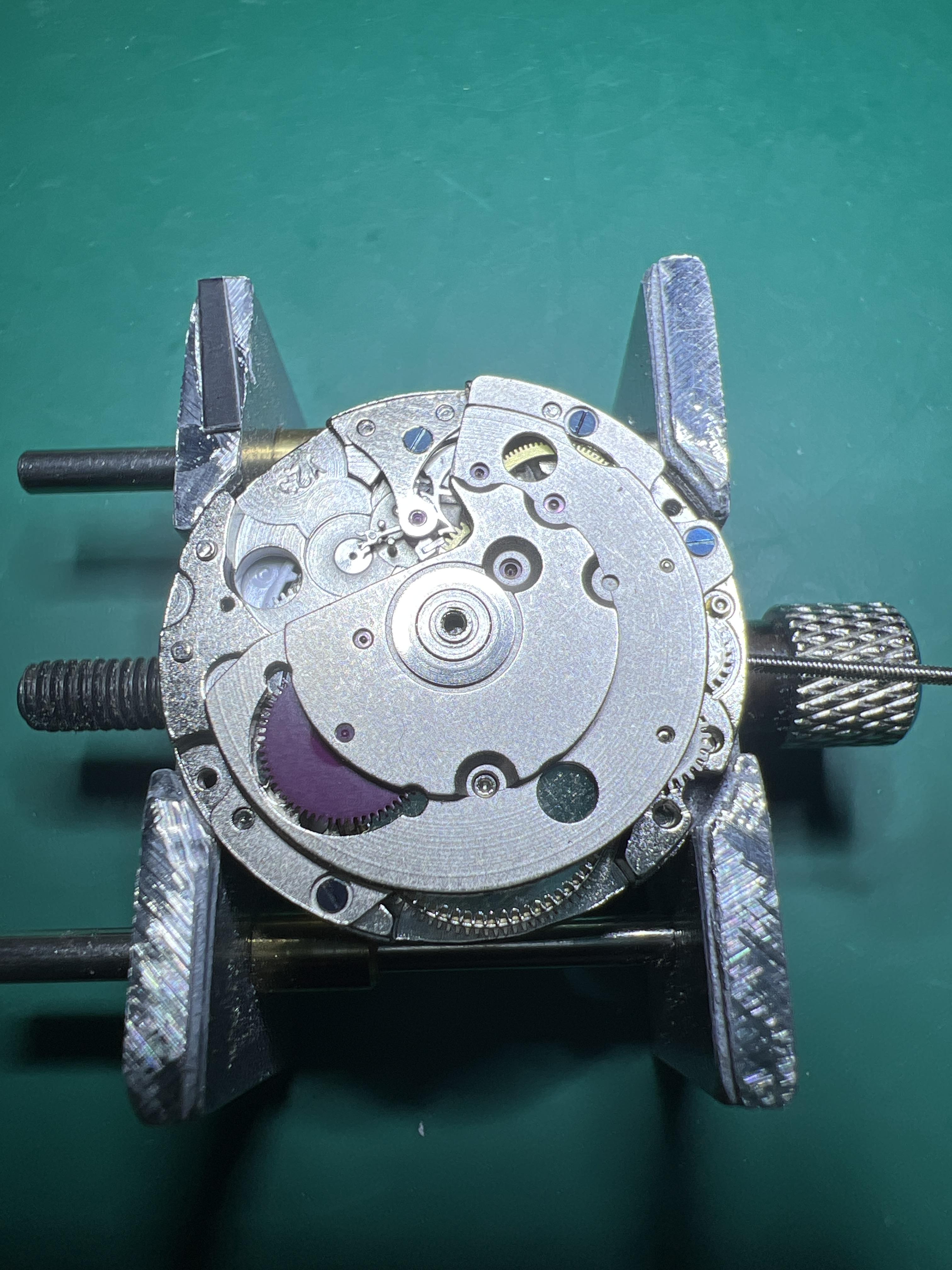

I am glad about that as right now I am looking at a DG2813 I have removed the rotor but I don’t think I can let the power down without removing the main bridge. I will take the balance of the movement first though
9 minutes ago, Terrinecold said:
@RichardHarris123right on time. I can’t see it and was still wondering about what to do. I figure if I remove the bridge while there is tension on the gear train things will go wrong
Dont pull the bridge, that will go very wrong.  Worse case is to lock the train and remove the pallet fork then with two sticks let the train unwind slowly catching the spokes.
That was the video of me practicing on the ST36.
I commented that I was happy that releasing power before removing the balance was OK because on today’s project I couldn’t find how to do it.
However after removing the balance I realized I still needed to find how to remove the power. There was no way removing a bridge which holds the gear train was a good idea. There is Avery nice video from the watch smith in the assembly of the DG2813 but I couldn’t find one of the disassembly
With the bridge removed it is clearer that the thing I previously circled is the click.
It is hidden by that pink wheel which I think is part of the automatic mechanism
22 minutes ago, Terrinecold said:
I think I found the click in the blue circle  I figured this was a Miyota 8215 clone and I found a disassembly video for thatIMG_9984.thumb.jpeg.d769443f2161c891b54b7642c8a4327e.jpeg
I can confirm that this is a Miyota 8215 and that you correctly circled the click.
Turn the crown slowly as if you were manually winding the watch. You should see the click moving. As the click moves and releases the wheel, hold it back with good tweezers or a small screwdriver. Then let the power out while keeping some grip on the crown to slow down the release.
